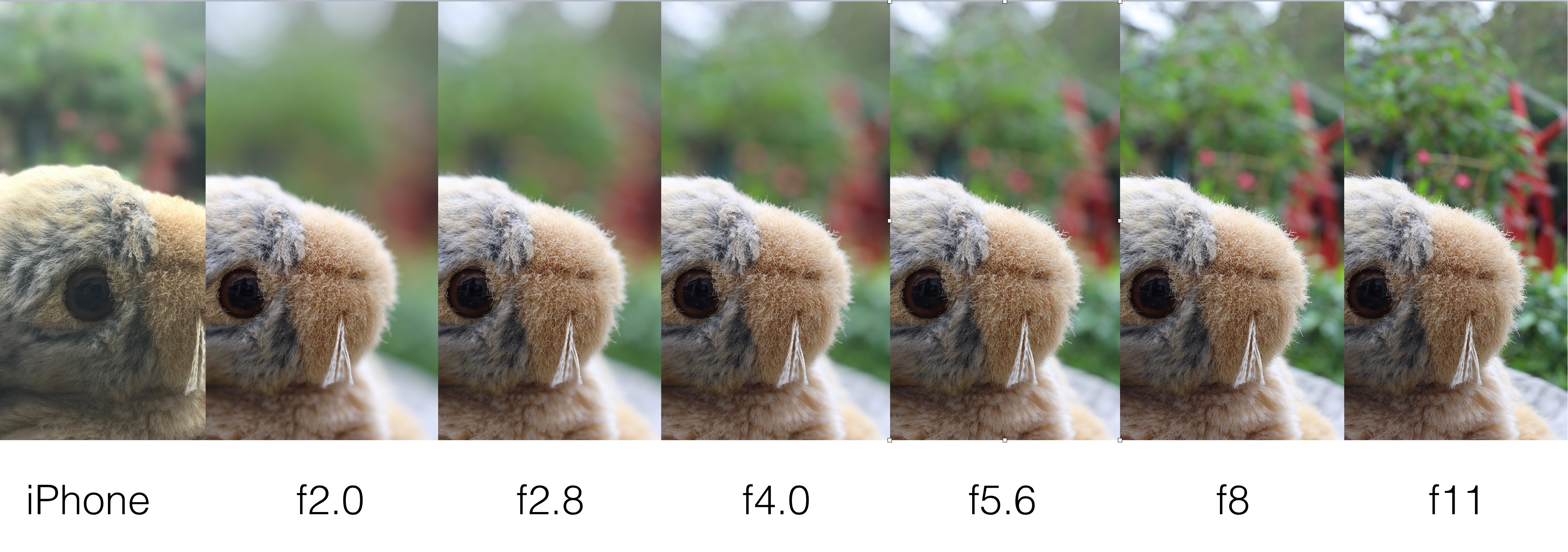

p353094784
But what is the portrait mode like? Well - I took my lens with the nicest bokeh I own on a Full Frame camera. I tried to make the same shot with the iPhone and my Canon EOS 5DMk IV with the Zeiss Milvus 50 mm f1.4 (I know pretty unfair... to some extend...)
Above you see the result: Matching this I would say: Well the iPhone ends up with a f5.6-ish aperture... For full frame: pretty slow... But keep in mind... This is full frame... In reality this means - to name it with typical lenses used...:
  • Full frame: f5.6: sorry, but there are -literally no such slow 50mm lenses available for full frame...
  • APS-C: f4.x: You end up with 4.x-ish values: let´s assume a 24-70mm or 24-105mm f4.0 will deliver the same amount of bokeh...
  • µ43 (Olympus, Lumix): f 2.8: In this case you get the same amount of bokeh from the iPhone as if you would own a 12-40mm f2.8 (Oly) or 12-35 f2.8 (Pana)... And this sounds much nicer...
For more details: read the full blog... http://delightphoto.zenfolio.com/blog/2017/5/the-iphone-7plus-portrait-mode-ingenious-or-rubbish

I love it, too. But I wanted to know what is the real comparison.... in Full Frame equivalents....
And some effects are really strange like the glass blurred away what you find in my blog.... But I agree: Apple will figure that out more and more...
I think the DOF of the portrait mode in your example is between FF 5.6 and 4.0 (but closer to 5.6).
Also, as this is "just software", I bet Apple could easily make the background more "blurry"; I guess they thought this amount of (fake) bokeh hits a sweet spot for most users/shots.
In fact the Portrait Mode is not a fake blur. It is a mixing of blurs: the back and forground blur comes from the wide angle lens.... and this has not that much blur at all....
