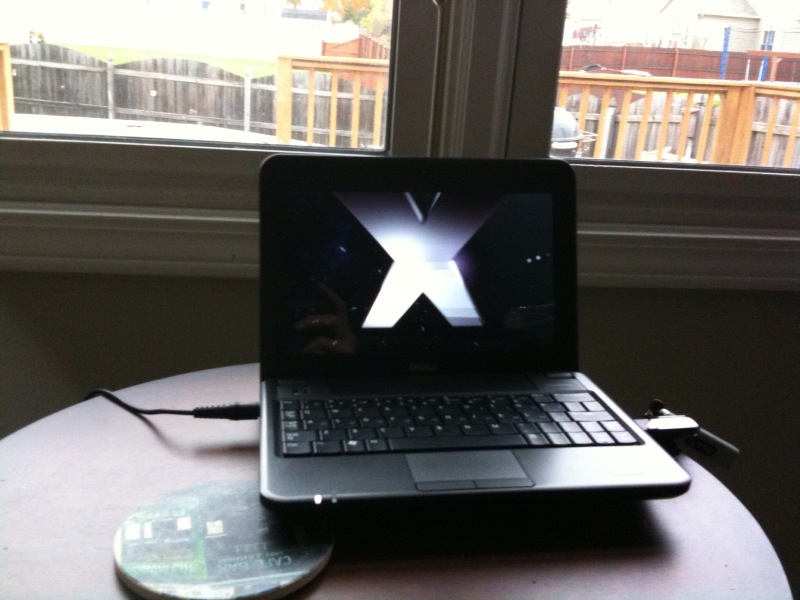

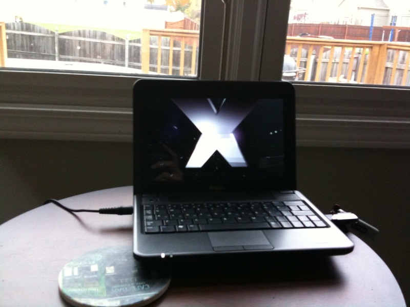

SL 10.6 Dell Vostro a90 Hackintosh Netbook
Followed the gizmodo guide on how to build a hackintosh Dell mini 10v. Unfortunately, I had already purchased the a90 about a week before the new guide was posted and that resulted in me just pretending I already had a 10v.
I followed the step by step guide and successfully installed SL. The only issue right now is inability for the netbook to sleep. When I close the lid, the monitor turns off, but the machine is unable to wake back up. I will try and find a fix...
What's I used:
Family copy of 10.6 I had already purchased for my number of Mac's. - $50 (single $30)
16GB flash drive I bought a little while back from Sam's Club. - $35
Dell Vostro a90 with Ubuntu (after tax and shipping) - $299.18

On a Dell Vostro a90 netbook right now running 10.6.1 - you will be fine installing everything right now, but of course search around upon every update. Don't be an early adopter of any updates on a hackintosh.
Do you have the SleepEnabler.kext installed?

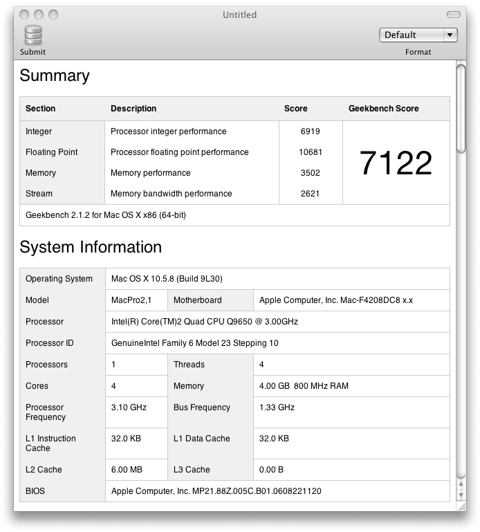

I got one too...
  • Gigabyte G41M-ES2L (Super cheap and very stable MB)
  • Q9650 @3.00GHz (Quad Core, 12MB cache, it's a screamer)
  • Gigabyte nVidia GTX 275, 896MB (über fast! About 1000x as fast as the GeForce 9400M ;-) )
  • RAM 2x2GB (4GB, 800MHz) (the only real drawback of the MB, only two RAM-slots...)
  • Ante Solo (same color scheme as the new iMacs, looks great)
  • Corsair VX450W (Great PSU, 80+)
Result? Everything works... Audio, LAN and video - with full 3D-support.
Great for gaming. Haven't seen that round spinning ball in weeks now...
I have never been this happy with any of my "real" Macs previously.
(that would be an iBook, Mac Mini and a Power Mac G5)
attachment.php
Pretty cool, ha? :p

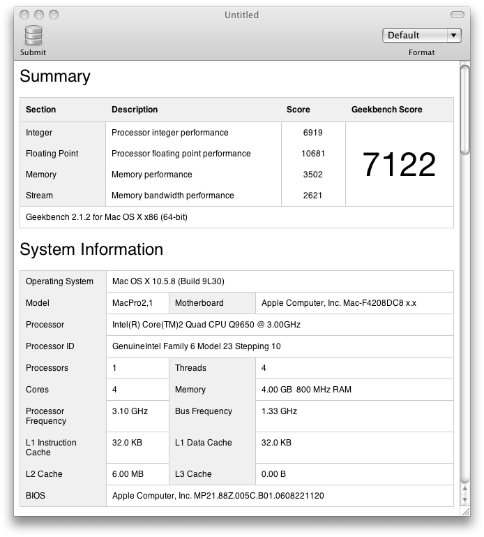

How much was that Q9650? I didn't think the Antec Solo would look that good.
I got one too...
How much for the whole setup and any guide you used?
The Q9650 is awesome. I have a Q8400 in my current hack and its pretty snappy, i cant imagine how quick a 9650 would be.
About $1000 USD, but I didn't buy these components for a Hack-build to begin with. I first used Win 7, and they played very good there too...
You can save a lot of money on a cheaper videocard and a less expensive CPU.
