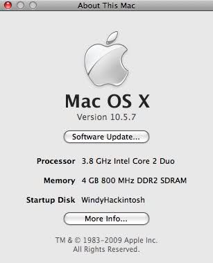

I love the "about this Mac" window! Mine shows some similar numbers with the CPU / Memory. OSX86 Tools has a Fixer that will auto dectect CPU / Memory and fix the numbers for you.

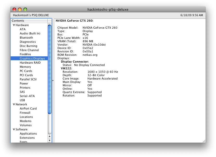

At the moment my Hackintosh 10.5.7 is working perfectly except System Profiler still shows "there was an error" in the Hardware tab and I can't get sleep to work properly (no display after wake up).

Success!
Posted this from my new Hackintosh! It's those little things in life! LOL
Now on to a dual booting solution!

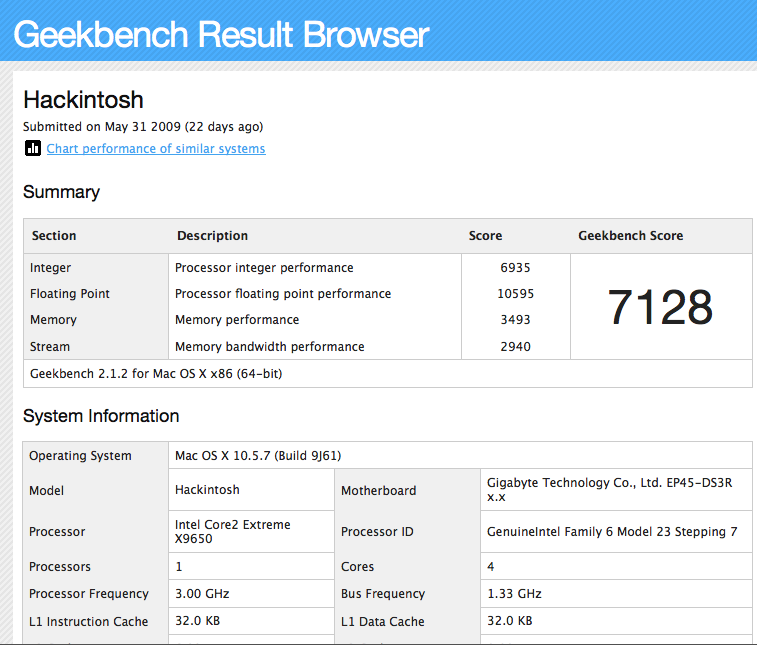

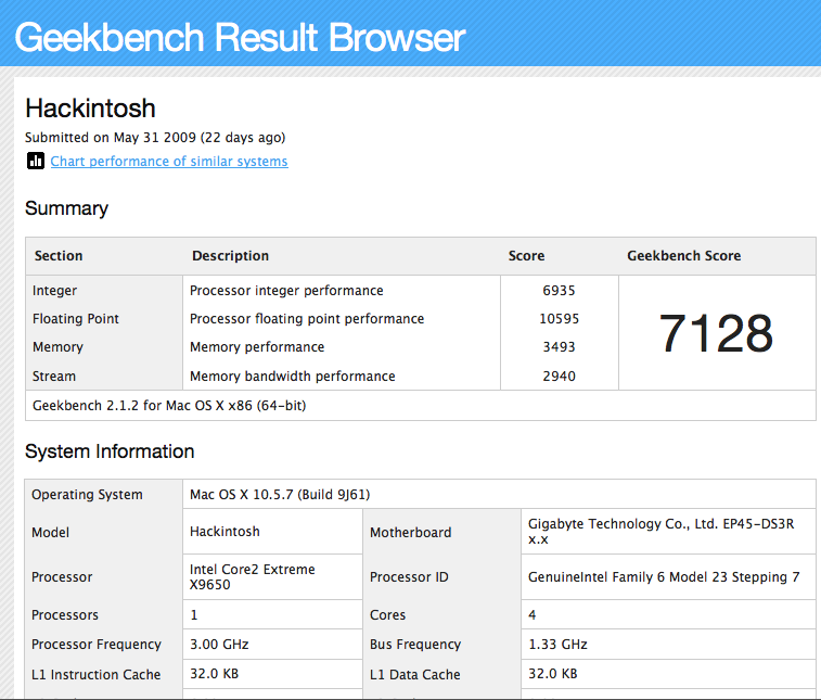

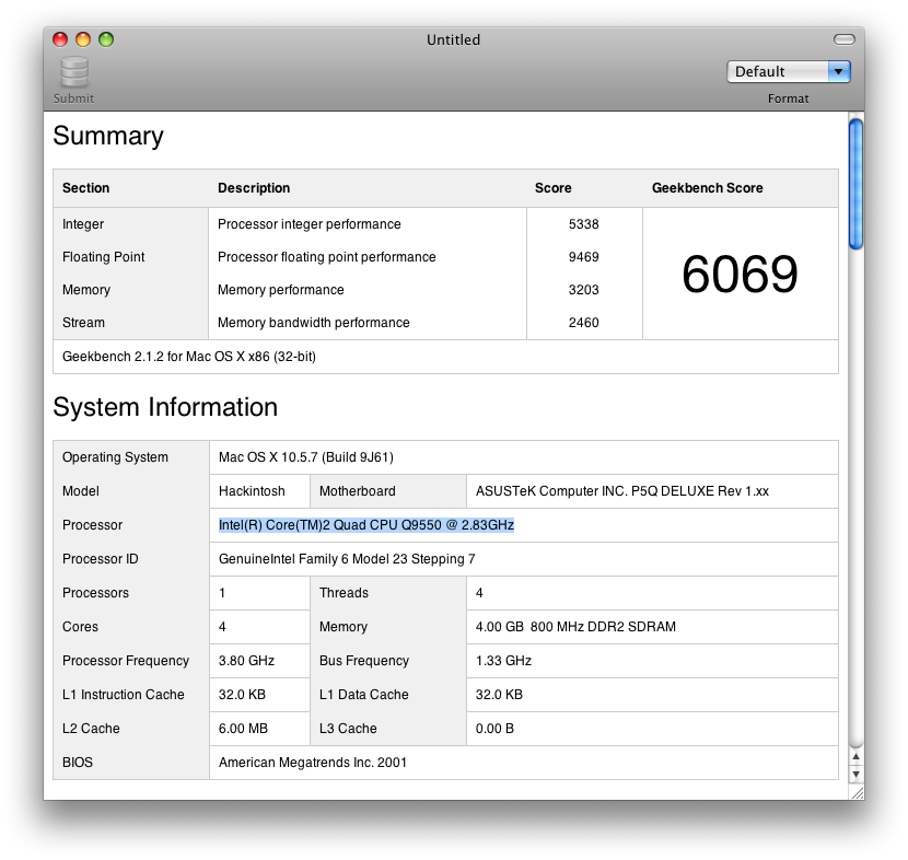

still very very happy with my efi-x chip hackintosh
it a screamer, using mr. jobs words, check out the geekbench
wish I had i7 but I'll live
