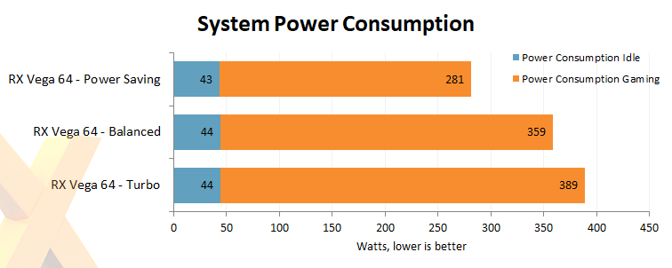

For VEGA 64, the nominal TDP is 295W, while it's just 210W for VEGA 56. Please note that the PowerPlay max power draw is considerably more than just the nominal graphics processor TDP. I'll check the firmware later to see the real total max power draw for a VEGA 64 like I did for the 56 model.

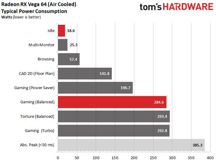

See this graphic:
I think this chart is more useful for cMP users. This is the card's power draw, but not total system power draw.
Tom's Hardware also provide the power draw distribution / pattern.
This graphic show another very interesting thing, the absurd power draw peak of 385.3W.
I've been talking a lot about this and people seems to not hear, a card that has a nominal TDP of 295W has a peak of 385.3W. Modern GPUs can draw much more power than the nominal TDP for short bursts.

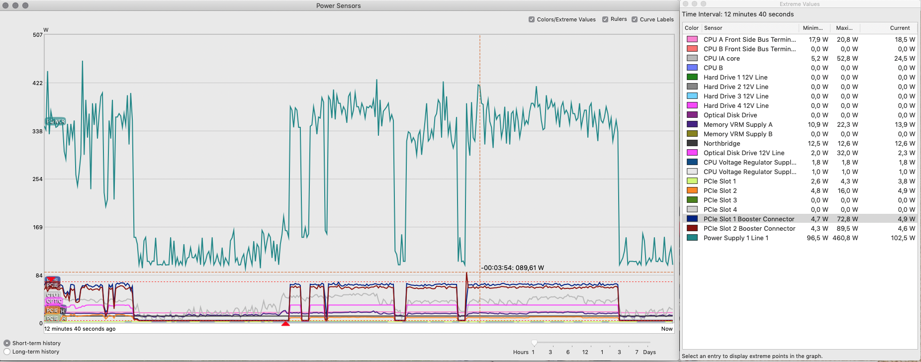

I measured power spikes with the Vega56 low bios mode. Just tried it.
LuxBall = veru low or no spikes, even power draw
Unigine Heaven = low spikes, little higher than LuxBall
TwinMotion = Spikes; 89,5W high spike on PCIe booster 2
So without switching the card to low bios mode I might have had some shutdowns allready because of too high power draw. I feed it with both mini 6-pins to 8-pin, and dual sata power to 6-pin.
Disclaimer: I really really hate the way Tom's Hardware span reviews over 30 or 40 pages, but seems they are the only site that are checking for bursts and spikes of power consumption with scientifically methodology and equipment.
This is the graphic for Vega 56:
So, without using the power saving ROM, the card can have a power draw peak of 376.4W. This is deadly for a MP5,1 backplane.

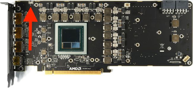

VEGA 56 and 64 cards have a double firmware, selectable by a switch, with normal and power saving settings. See here https://hexus.net/tech/reviews/graphics/108889-amd-radeon-rx-vega-64-radeon-rx-vega-56/?page=3
These are the switch settings for a reference model, non-OC, VEGA 56:
  1. With the normal setting is 165W + 50% PowerTune (max ~247,5W).
  2. With the 25% power saving setting enabled, Vega 56 is 122W + 50% PowerTune (max ~183W).
With the power saving ROM selected, when in full load, a VEGA 56 will requires less power than a RX 580. No Pixla's mod needed.
I think that the safest way is to buy a reference model VEGA 56 and use an eVGA PowerLink and two standard mini-PCie 6pin cables to feed power the GPU. This way you will balance the power consumption between both PCIe AUX A and B simultaneously and always keep the power draw inside the safety parameters of the backplane power plane.
Please note that VEGA 56 non reference models usually use the NANO PCB design and you can't connect an eVGA PowerLink without mods. Save yourself lot's of trouble and only buy a VEGA 56 with the AMD reference layout.

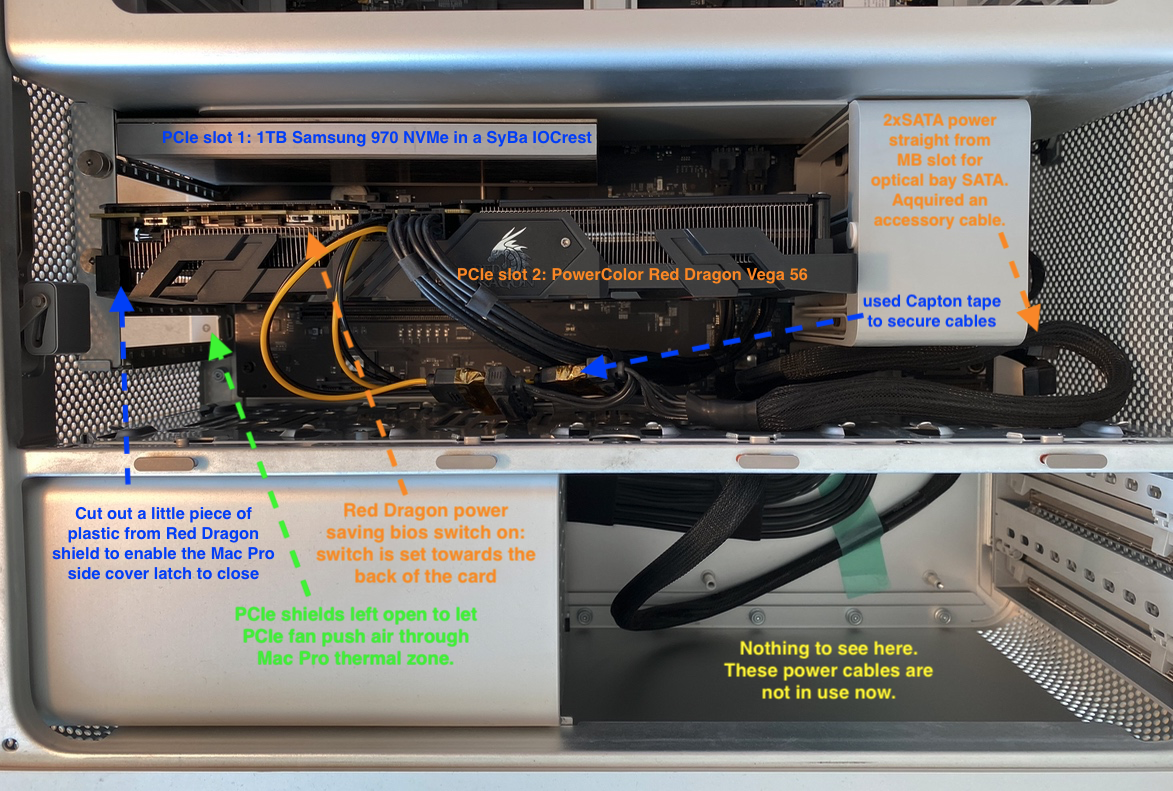

I'll share my latest development here with my Red Dragon Vega 56s. This is my secondary machine, which is for TwinMotion use mostly. BIOS dip switch can barely be seen, but you will get it. There are two of the switches, but I don't for sure know what the other one does. I guess it's the led light for the dragon or something even more important ;).
I have stripped this one down from everything not needed. It's a single 6-core X5680, 64GB RAM, 8GB Vega 56, Syba IO-Crest with Samsung EVO 1TB. No power mods other than dual optical SATA power to 6-pin. The other cable is dual mini 6-pin to 8-pin (like earlier posts). Power graphs can be seen earlier in this thread.
