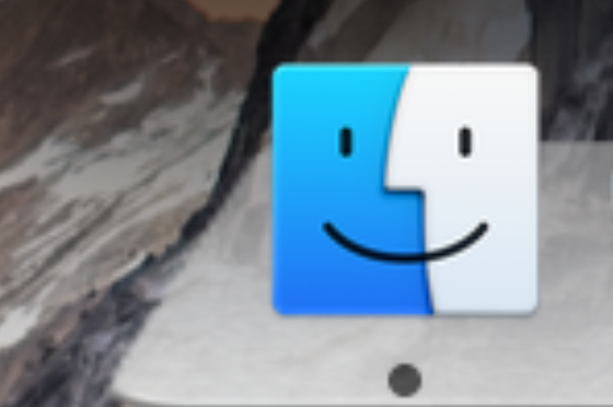

I joined a screenshot. It's as if the rounded corner of the Dock is getting stretched at a certain point, the radius varies. Or maybe it's designed to be like this ?
Edit. ~/Library/Application Support/cDock/3D.png if you don't like the look.
