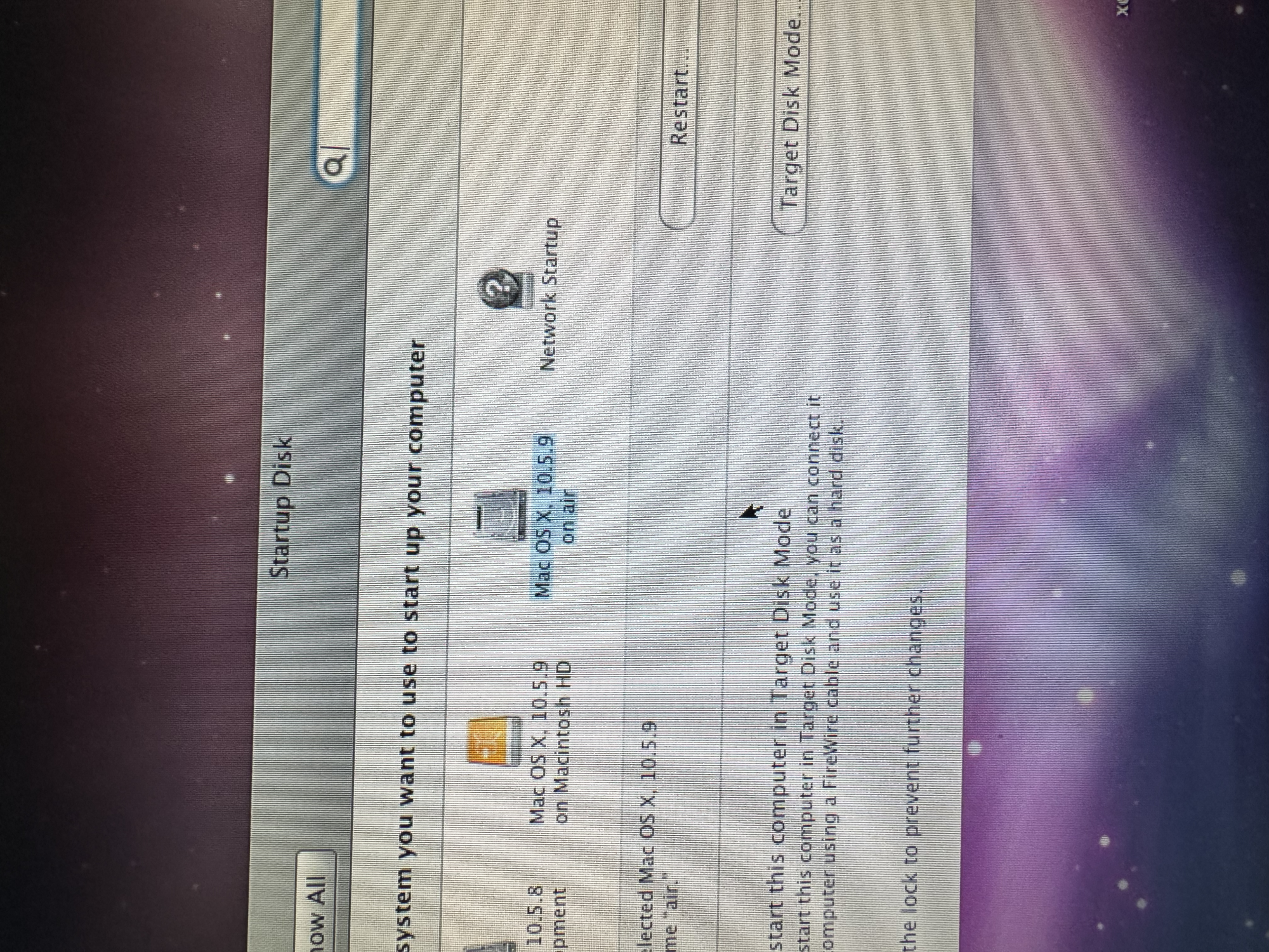

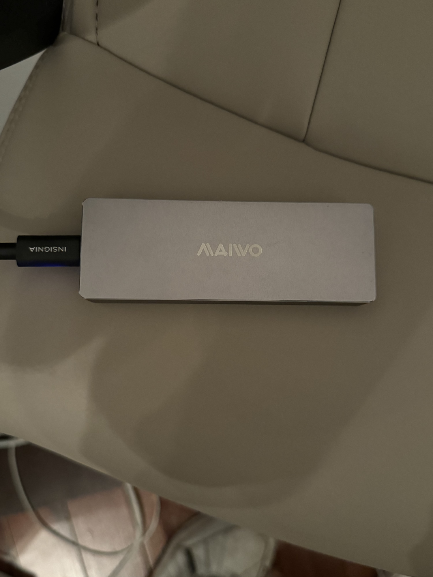

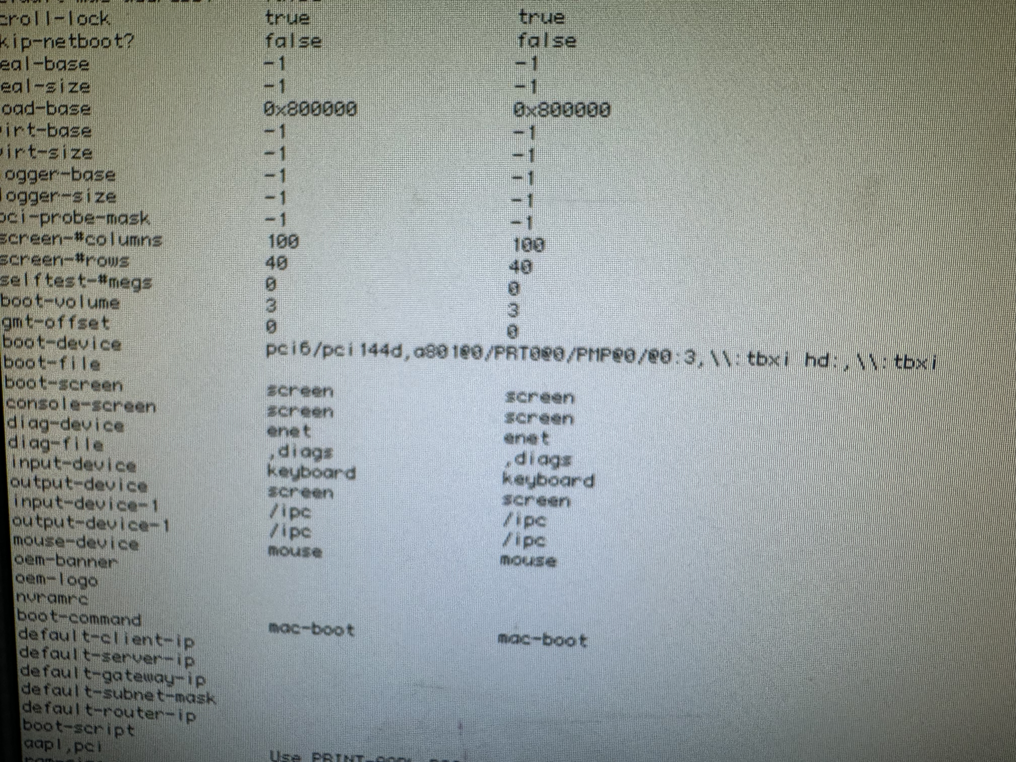

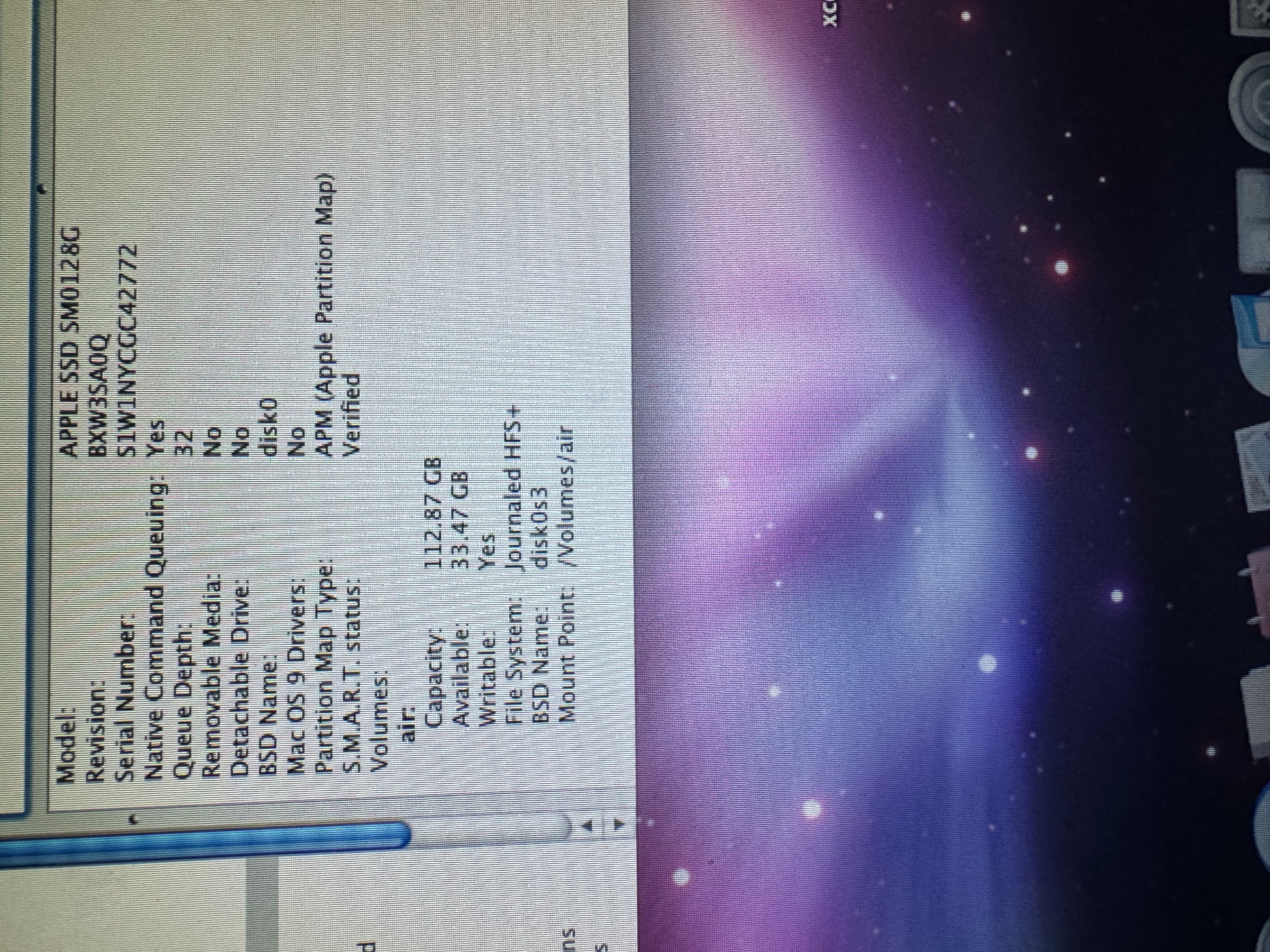

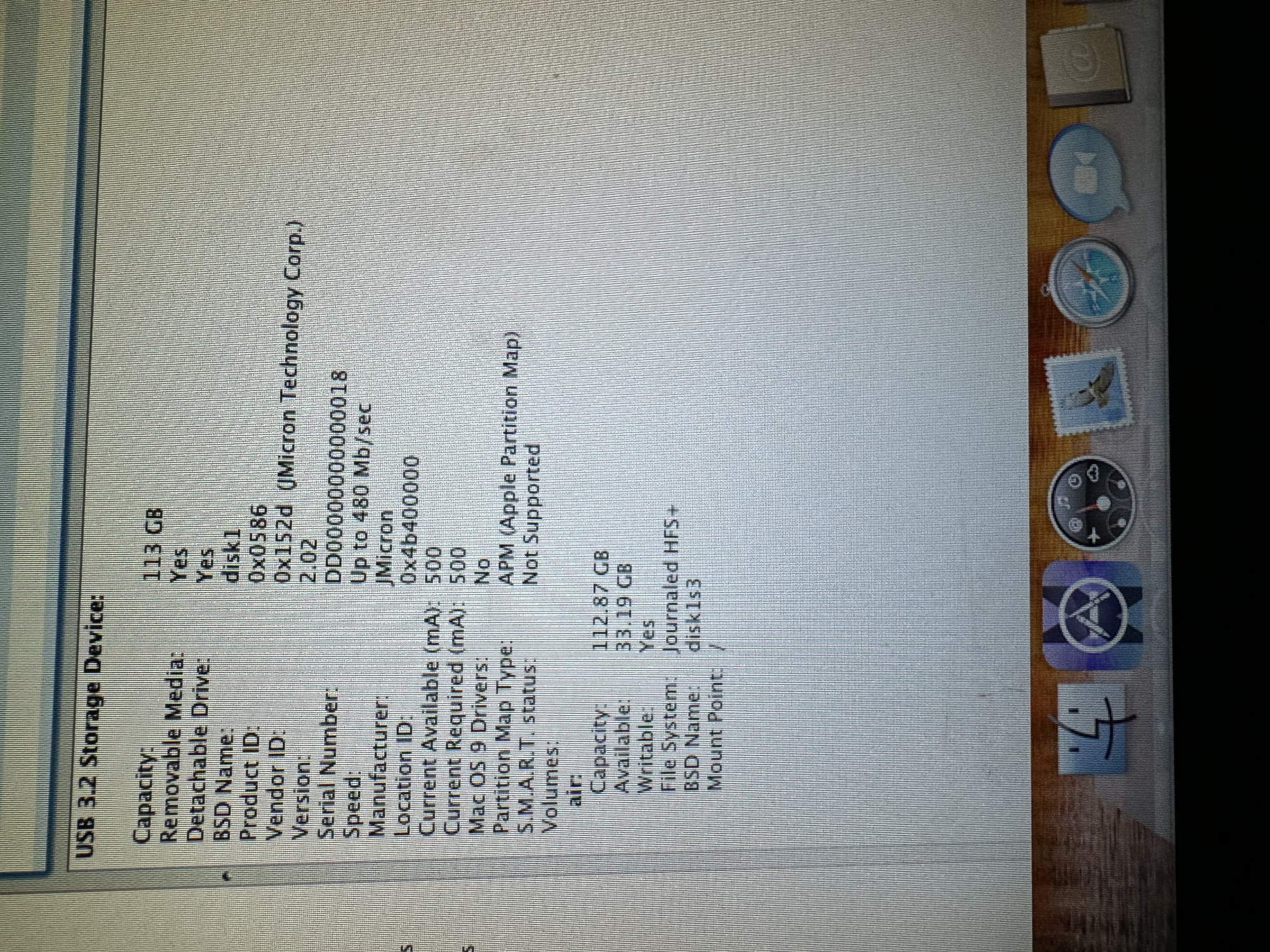

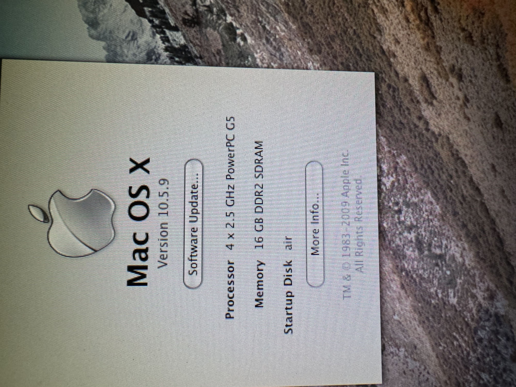

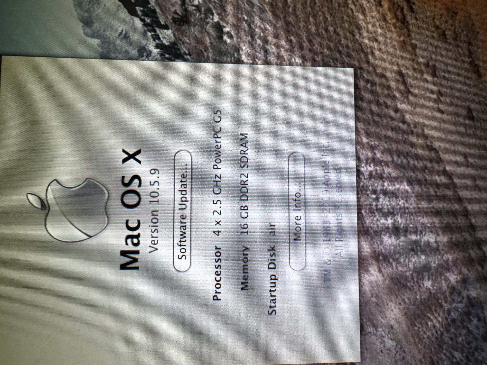

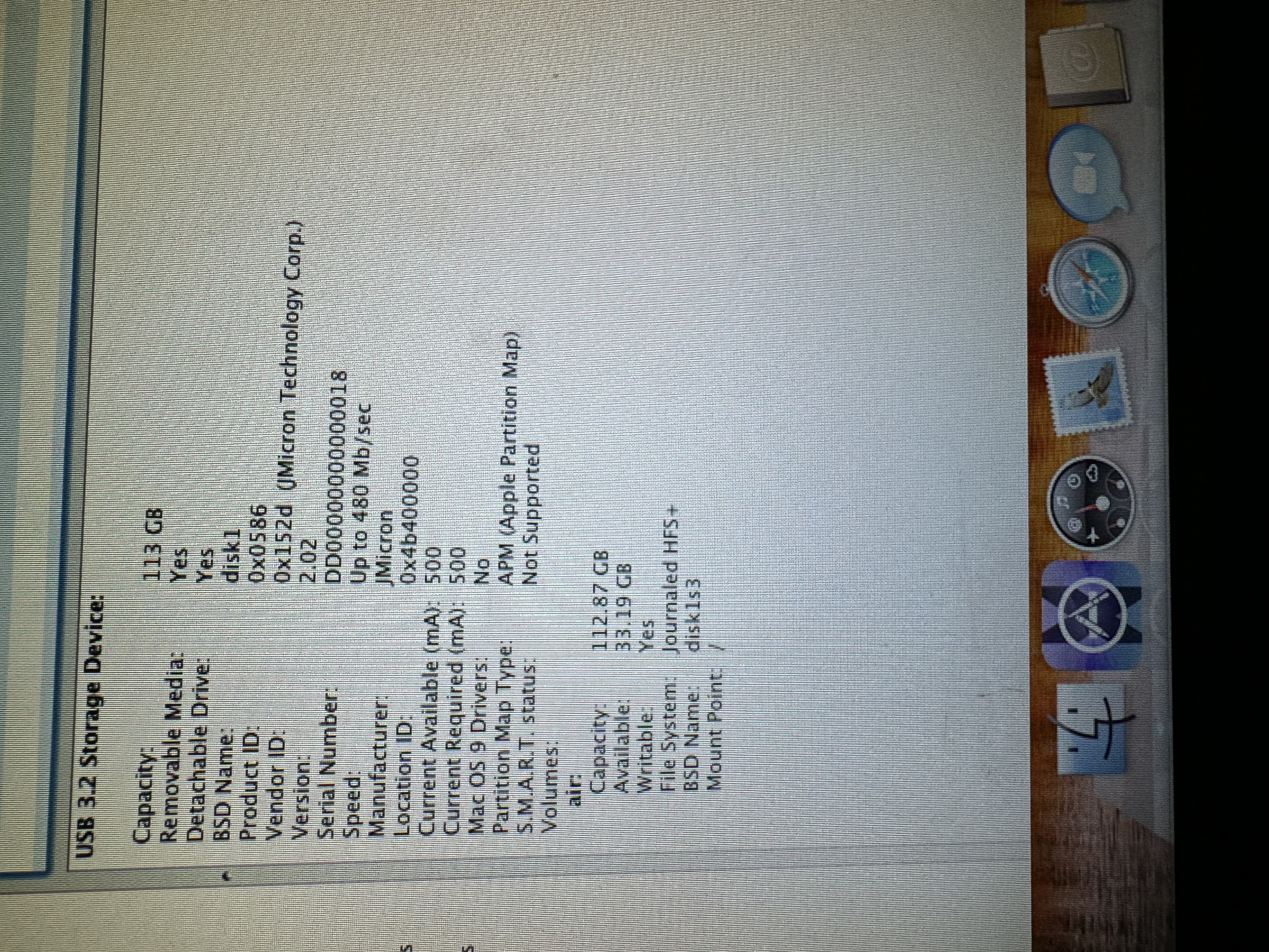

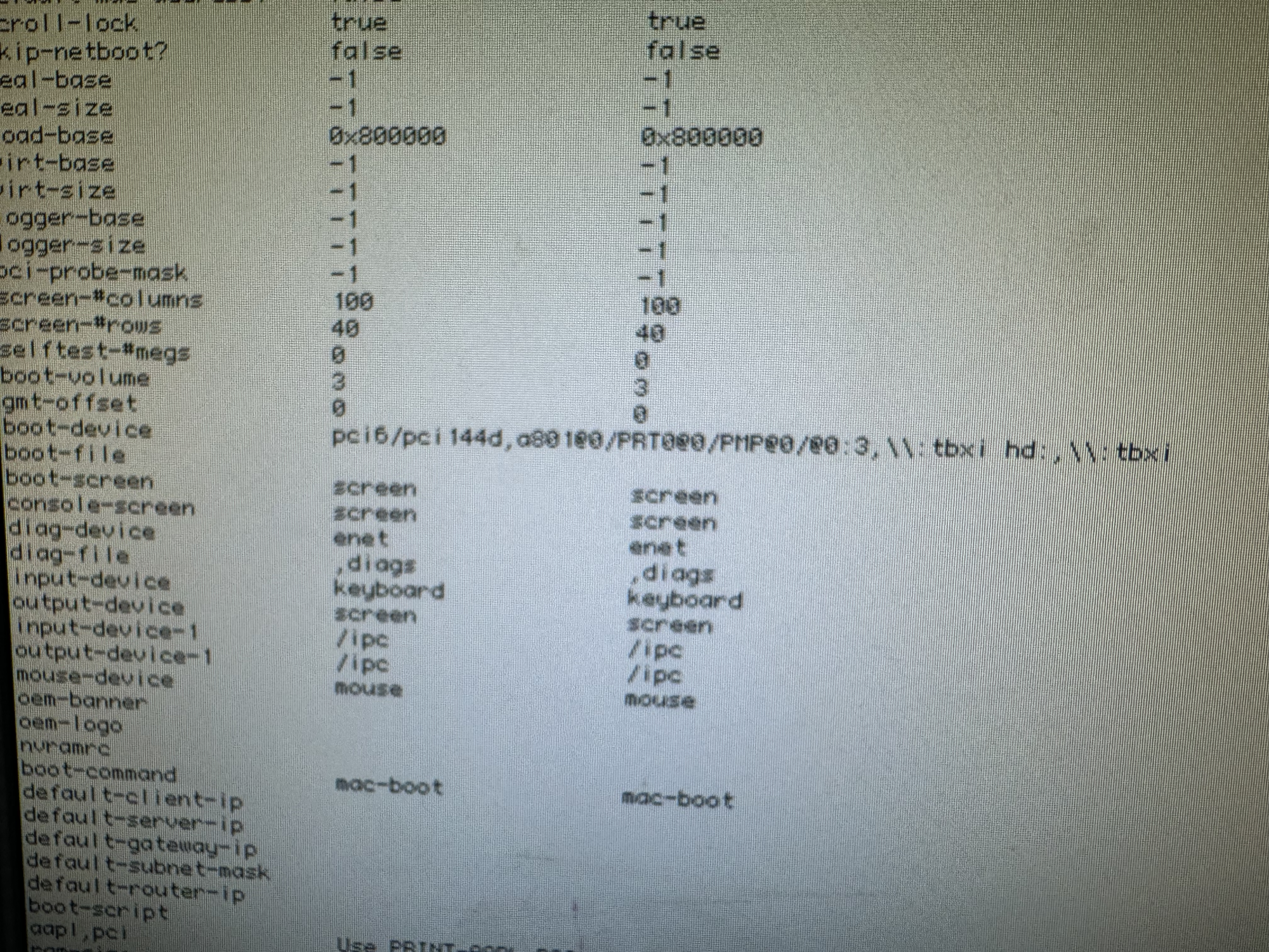

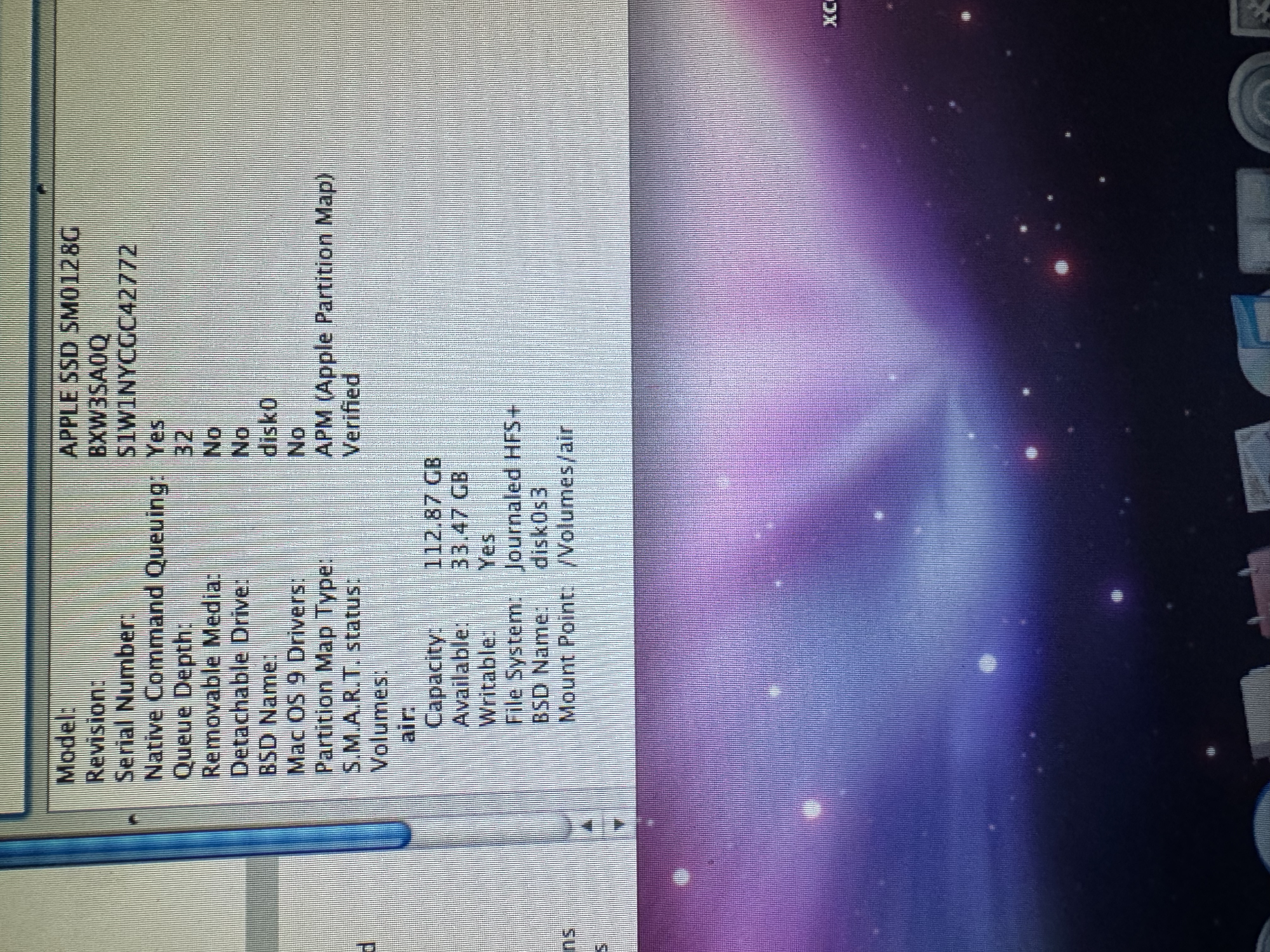

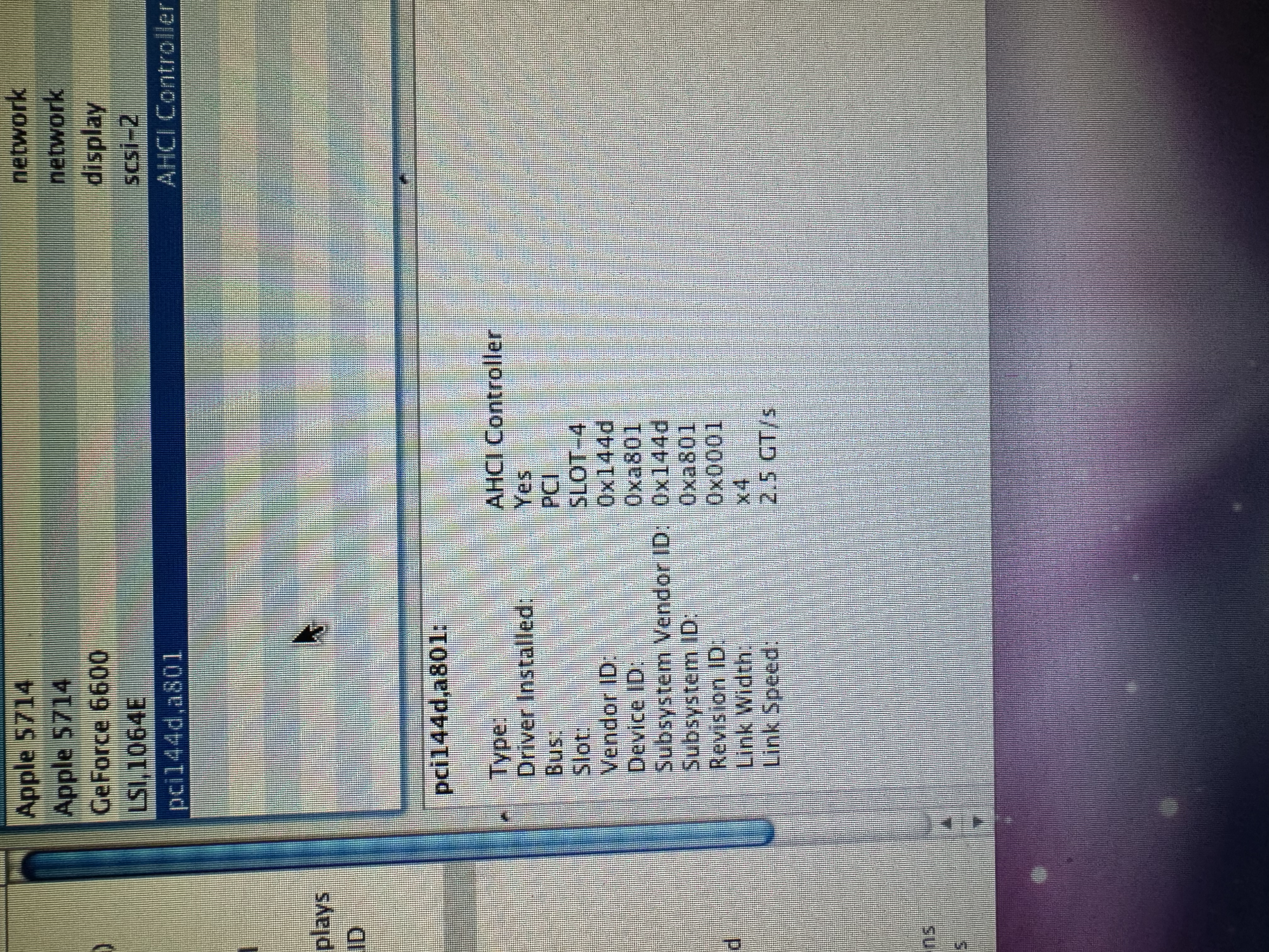

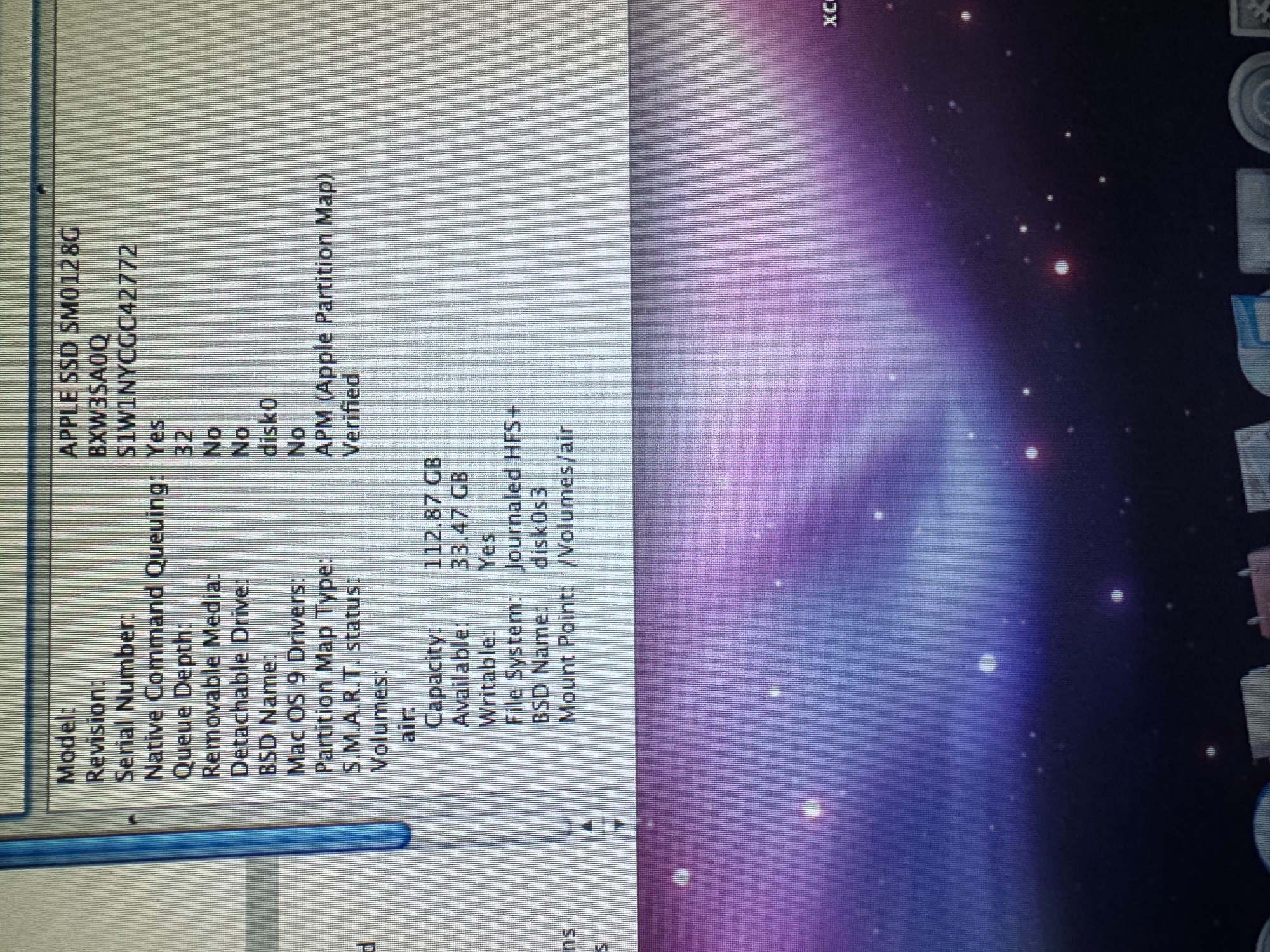

PowerPC G5 Quad I have an 128gb achi drive out of a MacBook air and a pcie adapter . I can load Sorbet Leopard onto it and in startup disks it recognized as a bootable drive but... when you select it it doesn't boot. So I've tried to go into open firmware and "point" to the drive I want to boot but I cannot figure out the commands I need. When I run devalias I don't think you can see the drive but when you run printenv command it clearly shows up..

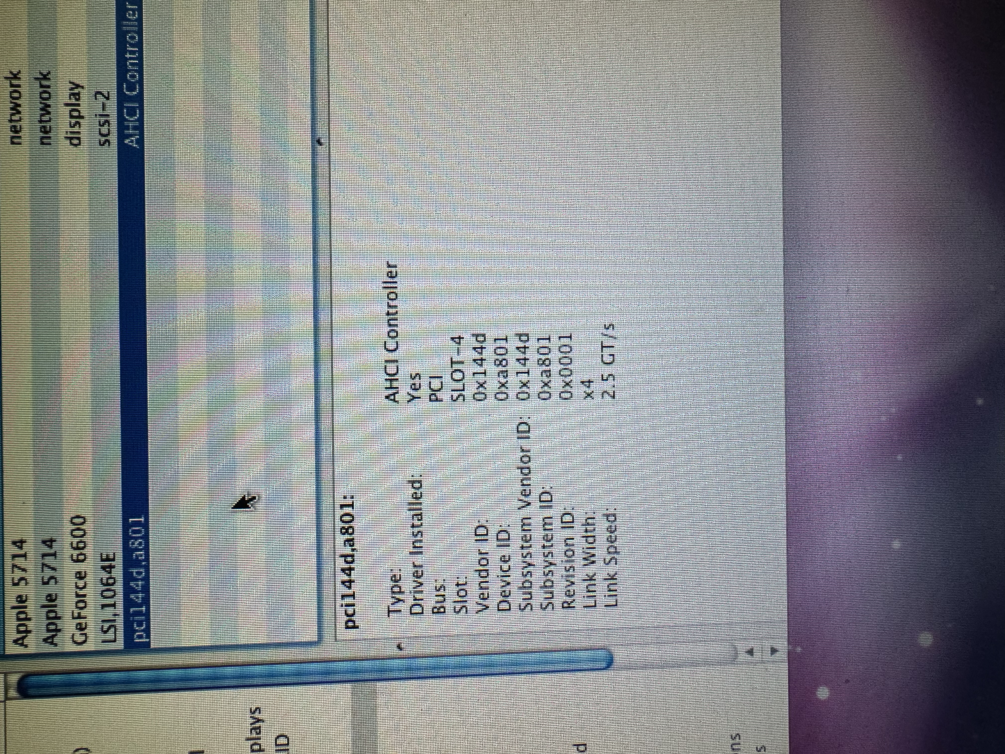

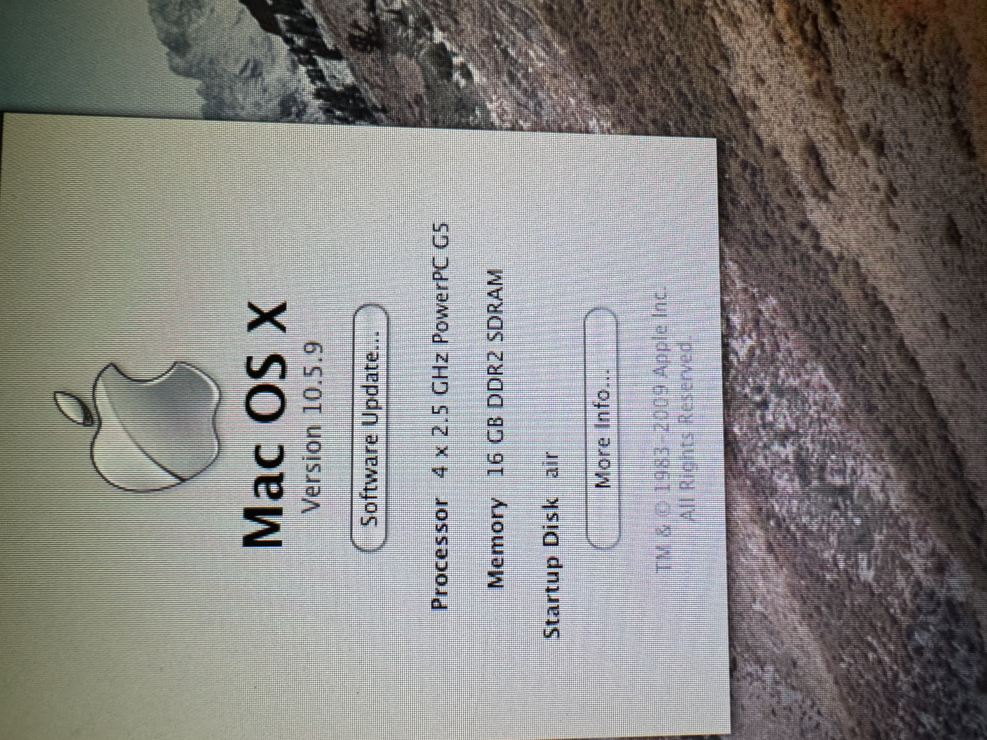

Your AHCI device is this one:
https://admin.pci-ids.ucw.cz/read/PC/144d/a801
If the AHCI device doesn't have a PCI option ROM with Open Firmware fcode then it probably won't boot since the Quad G5 doesn't have an AHCI PCI class fcode driver.
I don't know of anything that has a AHCI fcode driver.

Use telnet in Open Firmware to get the output of the following command:
dev / ls unselect-dev dump-device-tree
We are interested in all the info under the pci144d,a801 device.

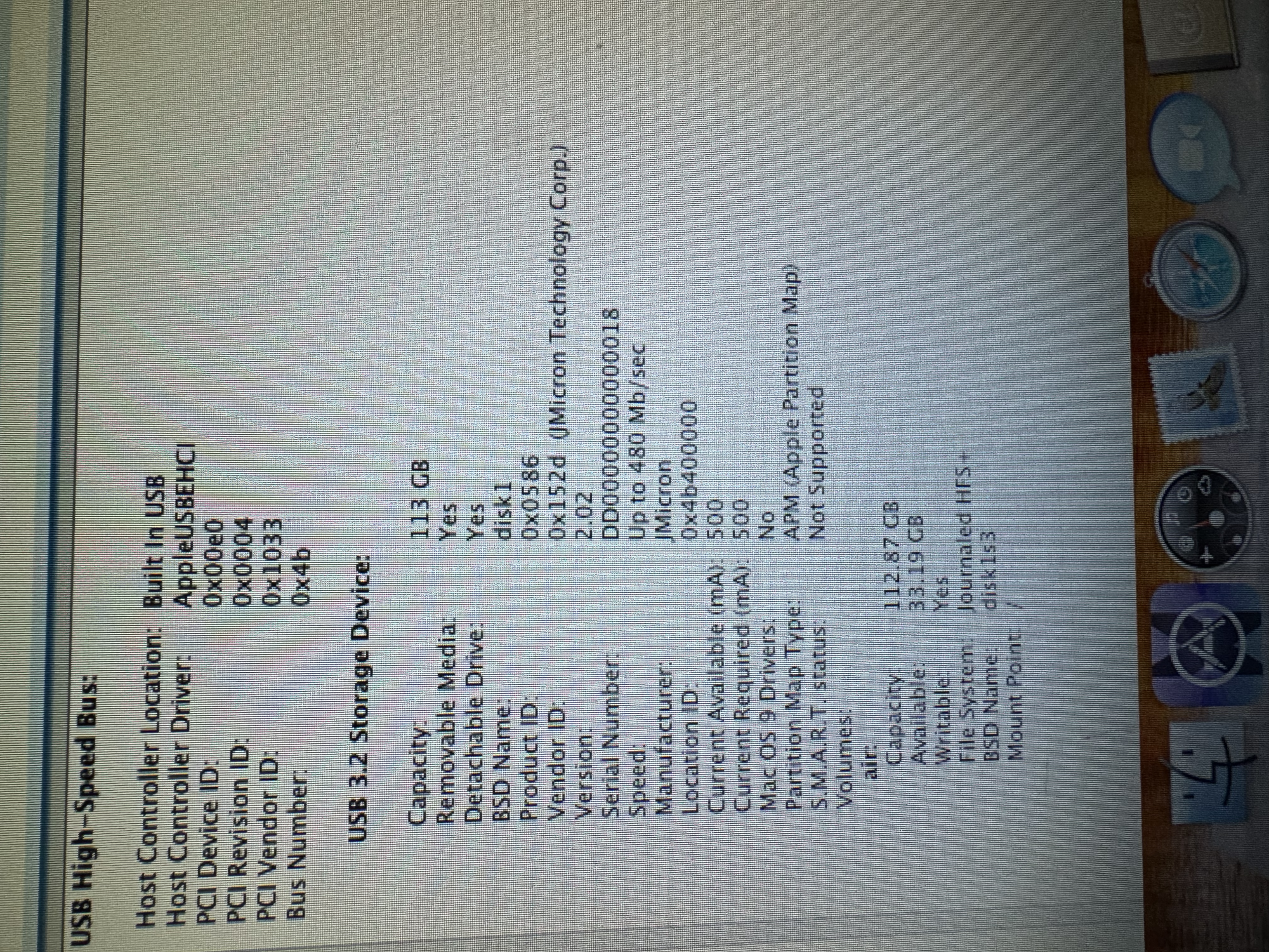

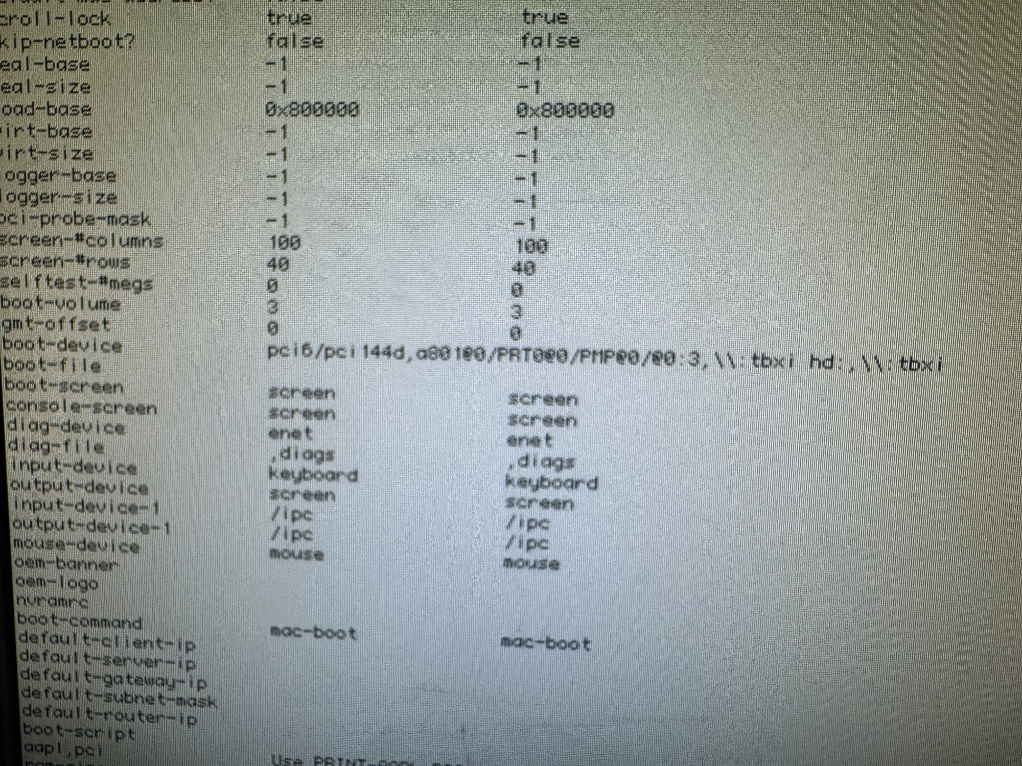

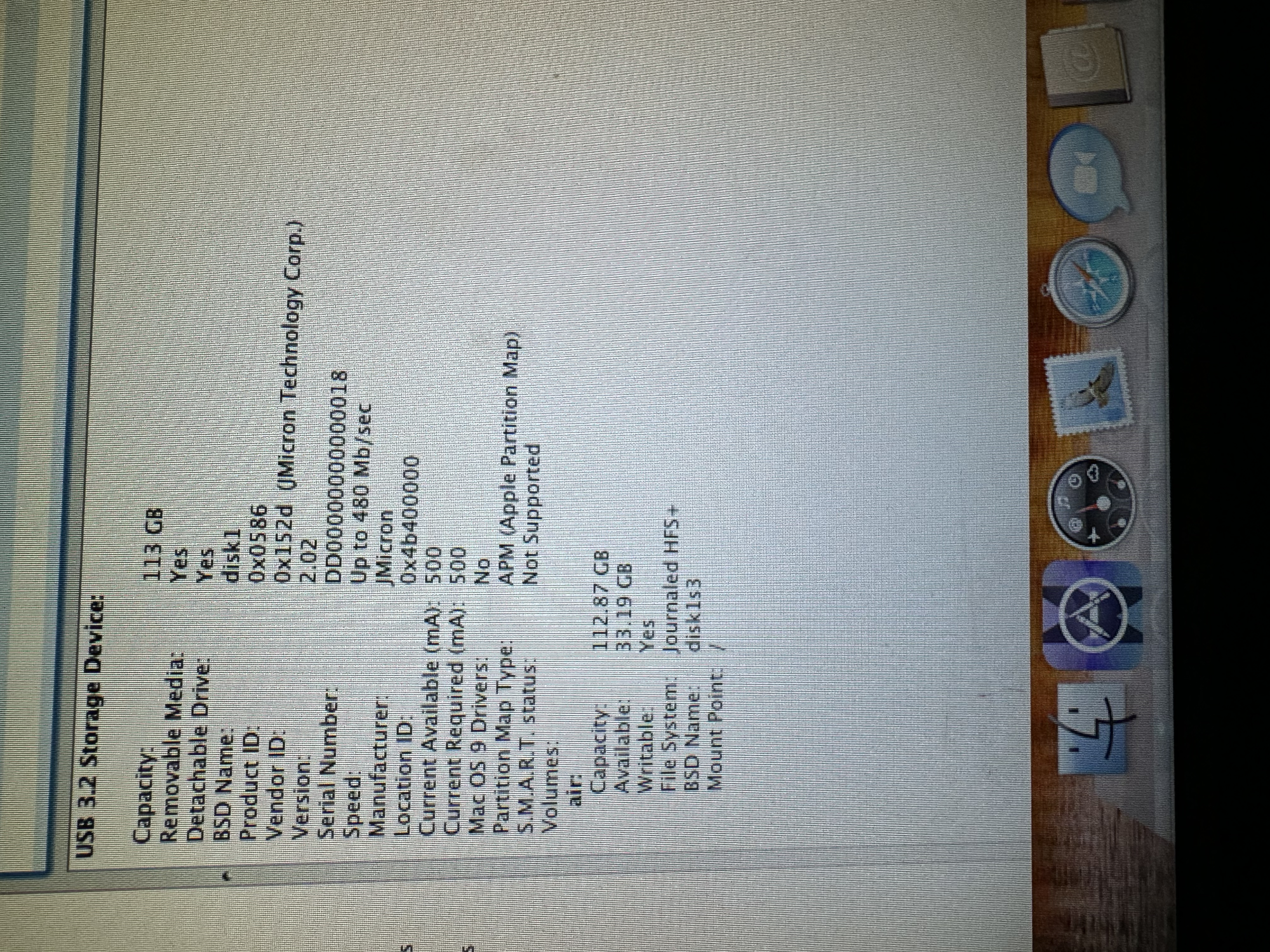

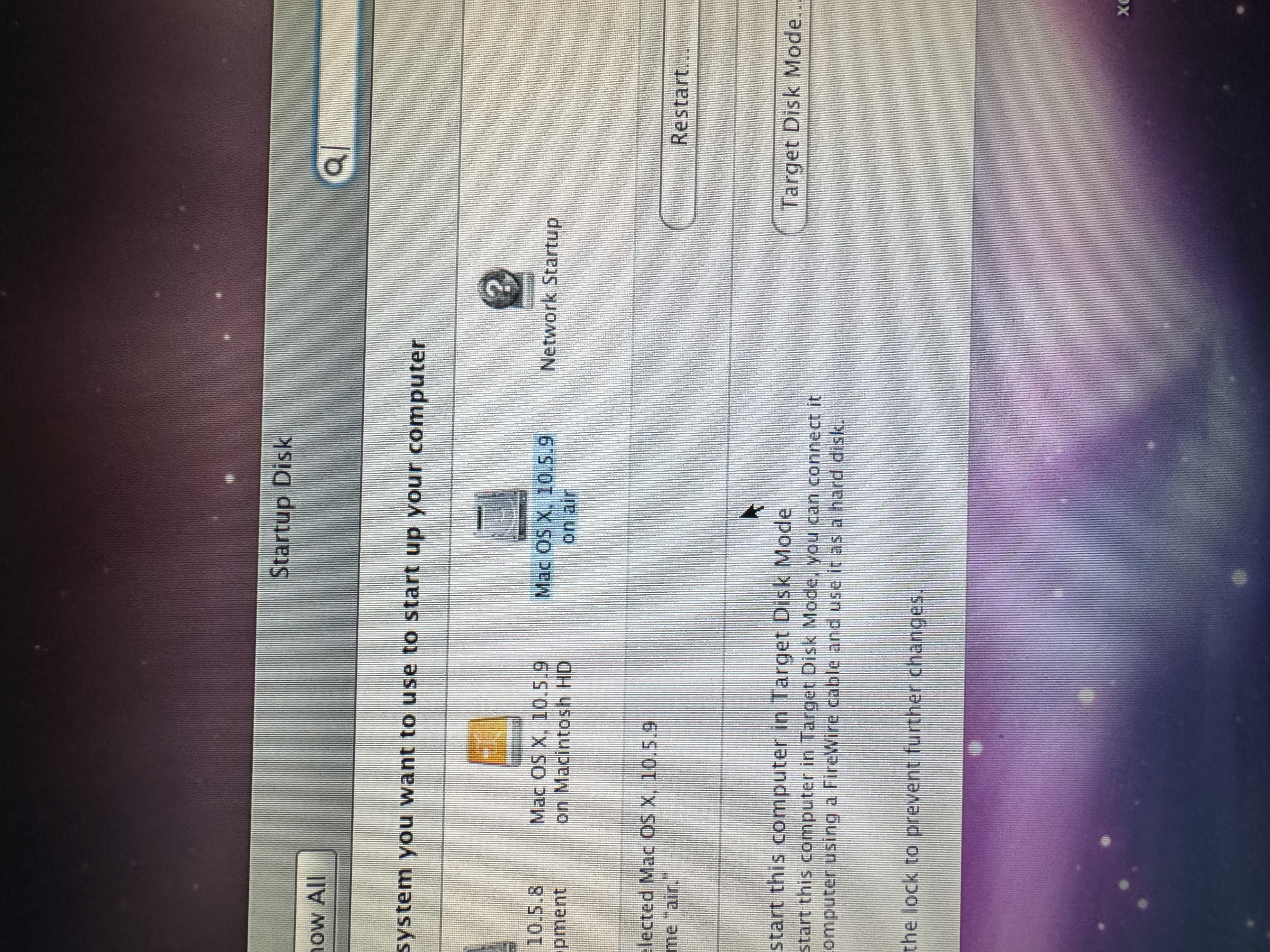

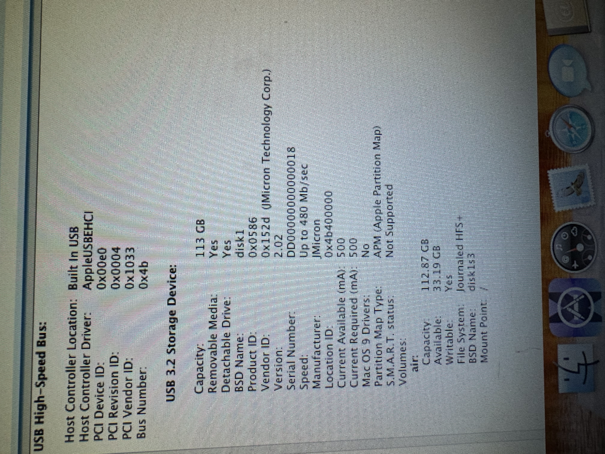

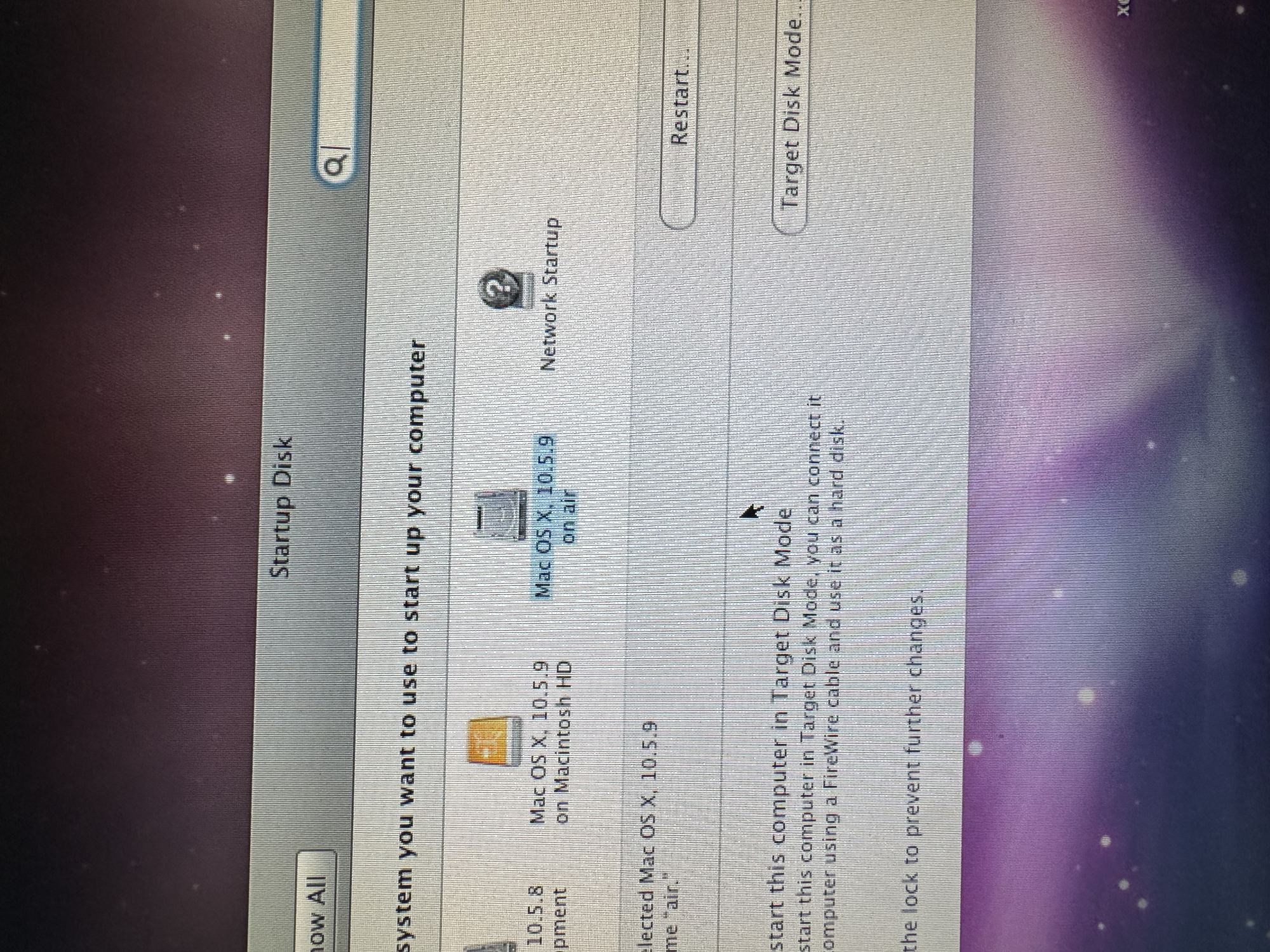

Thank you for the reply . I can tell you that I can get the drive to boot through a usb device The drive itself is out of a 2017 MacBook air. and using the usb device shown it will boot. so the drive is OK the issue is the card im using. I understand you statement regarding a rom on the pcie card but it is advertised and driverless so Im guessing I will need to find someone who can write this fcode driver for the chipset on the card?? That is the only thing preventing this machine from getting full use of the 128 gb drive.

I ran your command and too much data was populated. I have to use a telnet program on my mac and you can't search the output. Ill try with a pc tomorrow
I think you can install telnet from Homebrew on the Mac.
Or you can use an app like Serial.app which supports telnet.
AHCI booting was discussed at https://forums.macrumors.com/threads/booting-from-ahci-ssds-on-powerpc-using-a-redirect.2370850/
/ht@0,f2000000/pci@5/pci144d,a801@0
PROPERTIES:
TCZeroLimited
assigned-addresses 82080024 00000000 80100000 00000000 00002000
class-code 00010601
compatible pci144d,a801
pci144d,a801
pciclass,010601
device-id 0000a801
devsel-speed 00000000
interrupts 00000001
max-latency 00000000
min-grant 00000000
msi-capability 00080050
name pci144d,a801
pci-e-capability 00080070
reg 00080000 00000000 00000000 00000000 00000000
02080024 00000000 00000000 00000000 00002000
revision-id 00000001
subsystem-id 0000a801
subsystem-vendor-id 0000144d
vendor-id 0000144d
PROPERTIES:
TCZeroLimited
class-code 00010601
pci144d,a801
pciclass,010601
device-id 0000a801
interrupts 00000001
min-grant 00000000
name pci144d,a801
vendor-id 0000144d
No surprises here.
The class code confirms it's an AHCI device.
https://admin.pci-ids.ucw.cz/read/PD/01/06/01
There's no list of words (such as open and close) with the properties so it can't be used as a boot device.
If it had a AHCI Open Firmware driver then it would have those words. I suppose it would also have sub devices for each AHCI port or it could have a disk sub device that you could use to specify a AHCI port (like how SCSI has one disk sub device that can be used to open any disk attached to the SCSI bus with one of the seven possible SCSI IDs).
No surprises here.
So does that mean even if there was an open firmware "driver" it still wouldn't boot?
It means an Open Firmware driver is needed to create all the parts needed to boot.
Someone would have to make a AHCI driver for Open Firmware. Sources of info: The AHCI specification, Linux AHCI driver, UEFI AHCI driver, Open Firmware specification, various Open Firmware bindings for mass storage device related buses (scsi, usb, floppy, etc.)
