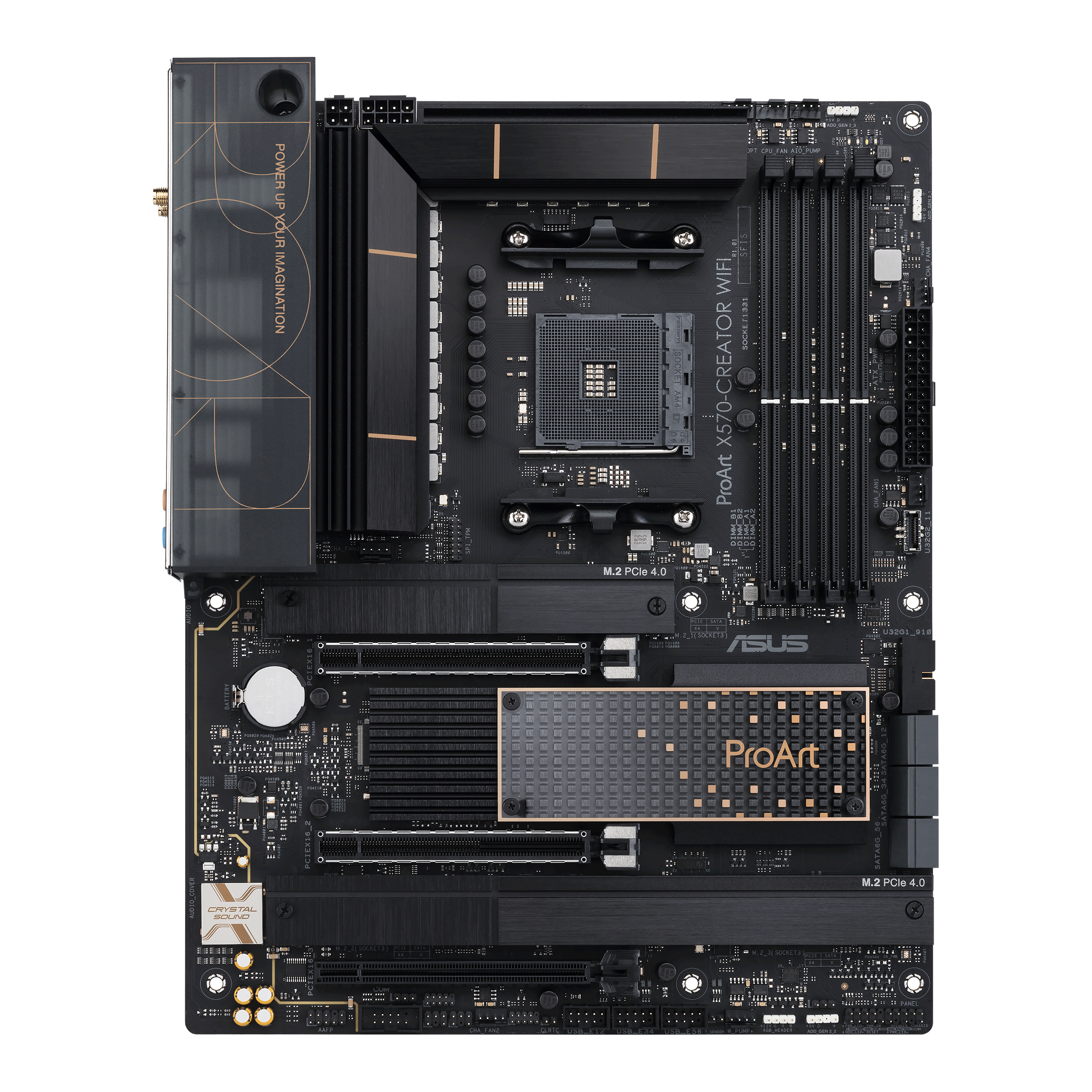

ASUS just introduced a new ATX motherborard for creatives.
3 wide spacing there for non slot blocking? Nope.
Standards like ATX and EATX are also fixed in size. If given a fixed amount of space if the board maker tries to increase the space between slots then will likely have to trade something off. (e.g., give up a slot ). Slot numbers sell on most enthusiasts groups more than "better spacing".

Interesting. So it’s the 3-wide cards that are the anomalies. Seems like a problematic choice to go 3-wide if no mobos can accommodate them.
joelypolly
macrumors 6502a
Sep 14, 2003
521
249
Bay Area
Thats why on a standard ATX more you usually can only fit something like 6 to 7 one-wide cards which means on average you can fit 2 maybe 3 two-wide cards. The benefits that ATX motherboards have is that the last slot can fit as wide a card as will fit in your case.
