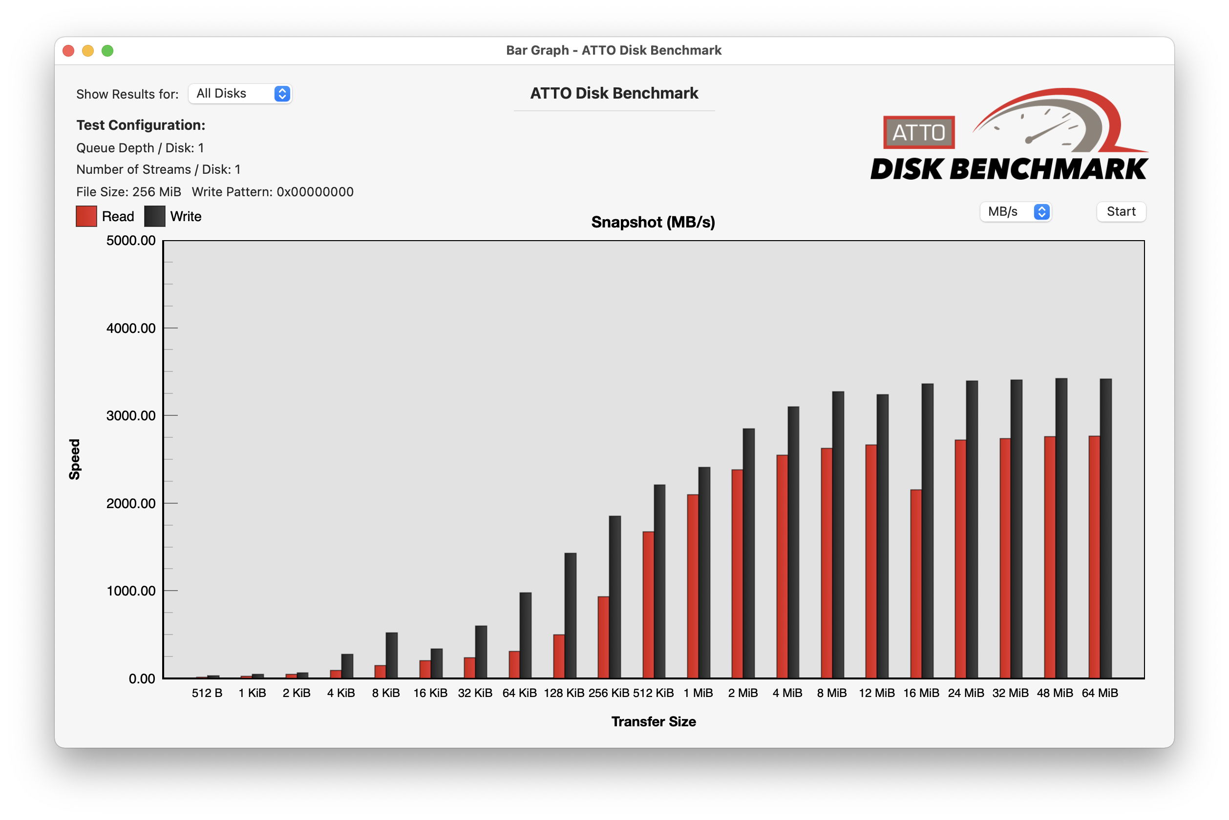

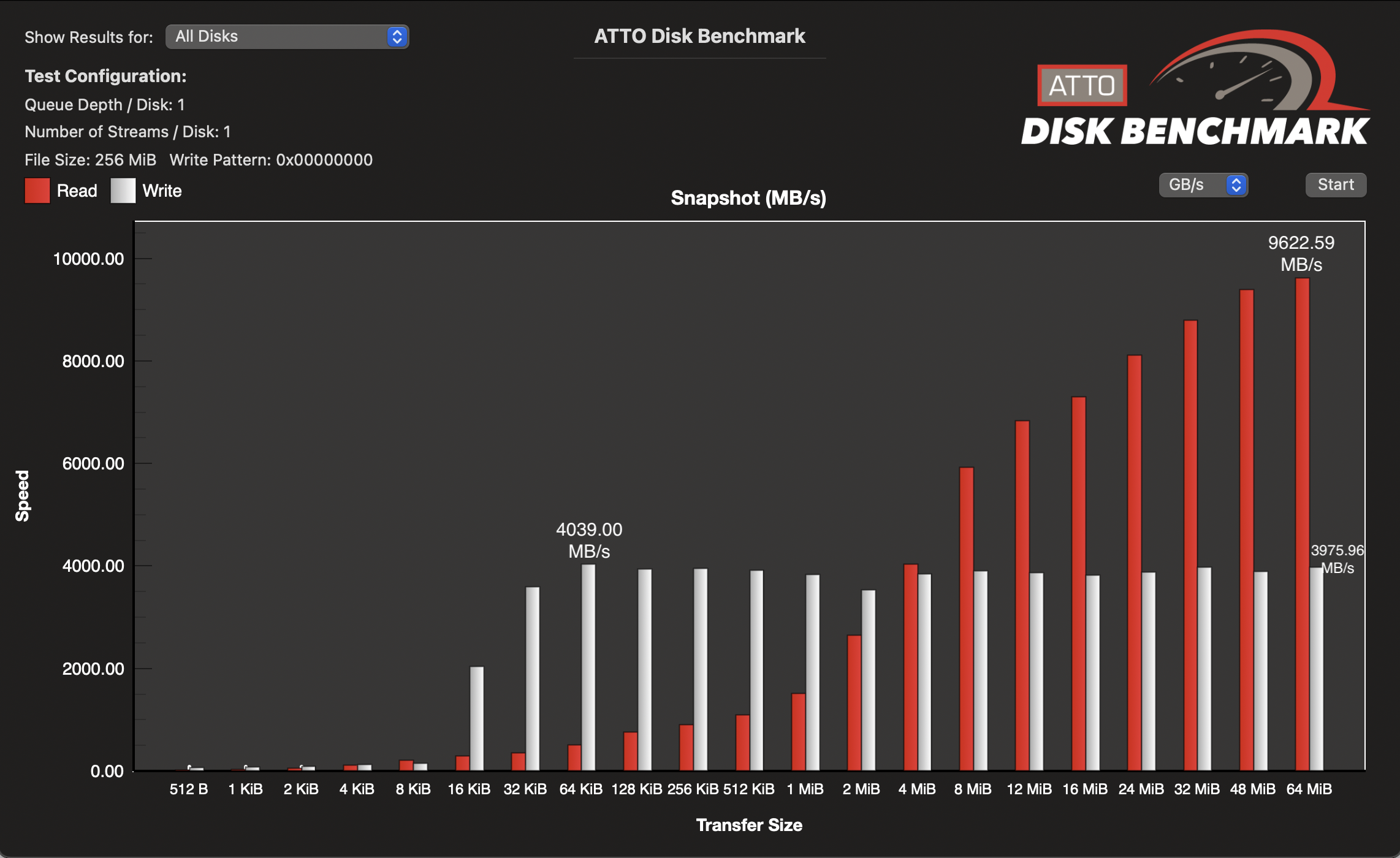

There are some reports of significant SSD speeds from these M1 macs with speculation that the storage controller built into M1 is perhaps responsible
looks like reads in chunks of 8MiB through 64 MiB are seriously fast, reads are consistent from 64 KiB through 64MiB.
i look forward to the further analysis.

In terms of swap behavior, the key indicators are 4KiB (Intel) and 16KiB (M1). Those are the page sizes for macOS on the two architectures, so page faults will be using those read/write sizes. Some of the other read metrics are important, but in more specific scenarios where we might be loading many pages into memory at once and can issue larger bulk reads instead of treating them as a series of page faults. App launch comes to mind as a good candidate for this.
So two things to point out:
  • The 16KiB read speeds are pretty similar between the two platforms. While the 16KiB write on the M1 is much faster. Makes me wonder what sort of write buffer Apple has here.
  • The 16KiB read speeds on both platforms look about 4x faster than the 4KiB.
So the general take-away is that if I have to fault pages in on the M1, it takes about the same time to fault in a 16KiB page on the M1 as it does a 4KiB page on Intel. So there's two ways a process benefits. One is that they page fault less frequently when working with small chunks that might be nearby other small chunks. Second is that when a process reads in a larger chunk of data that lives in swap, say a 128KiB buffer, the M1 needs only 8 page faults, while the Intel system needs 32. So the M1 will still read that larger buffer into RAM 4x faster, despite not having a distinct read speed advantage at 16KiB read sizes vs Intel.
The higher write speed also probably helps, to a point. But since macOS aggressively writes to swap before it needs to, then it's more likely that a page fault will only ever be reading a new page into RAM, and not doing both a write and read. So the write speed at 16KiB is probably not as big a deal as it seems at first.
But there's read/write latency that would be important here too. If the M1 SSD controller has good latencies at 16KiB, then that's another way to pull even further ahead in swap performance over Intel.

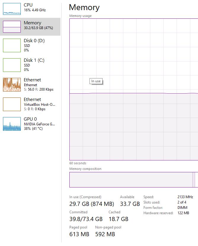

My current i7-10700 desktop:
Could I run this with 16 GB of RAM and swap like mad? Sure. But why bother when RAM is dirt cheap.

I upgraded a 2008 Dell XPS Studio 435mt to 48 GB of RAM and that thing is quite usable given its age. It has an i7-920 so far more CPU horsepower than the Late 2009 iMac and 48 GB of RAM means that everything is in memory.
I have the same system, with 24gb i7-960, I always thought that was the max ram.
I did too because every place I looked said it was the max. But they set the max at what they test for and I guess the 8 GB DIMMs weren't out then. So I took a chance and bought two sticks (they're cheap), and it worked, so I bought another four. I't nice for running VMs and it's overall fast because all of your files are basically cached.

Obviously SSD is now more important than RAM in usual tasks. I'm using base MBA with 8 GB of RAM and it has never slowed down, but for now when SSD is low (~40 GB). Moves files to external and it becomes snappy again.
Yes, this is a well-known issue with SSDs, pasting a link below that explains a bit (you may know but in case of interest from others).
But I'd note: if a base machine with 8gb has to swap much, the effects will be cumulative - i.e. the more it writes and reads and deletes items from swap, the more likely the slower write operations of a more-full drive will be noticeable (for the reasons noted in the article). The effect of these cumulative slowdowns are probably not linear - combination of swapping + write slowdowns far worse than either of these individually, because they're going to overlap quite a bit.
In other words: in a sense the performance hit you're seeing is not just the ssd-full issue, and in fact boosting the ram might be an important part of a solution.
Beyond that, it's going to depend on your 'usual tasks' and specific use profile and whether having an external is a good/cost effective solution for you, or more ram, or a larger internal SSD or some combination. For some the external drive may be just what they want, for others, inconvenient. Even the task of moving files off computer and then finding when you need them involves some time and effort, which should also be included in 'slowdowns' in some sense.
Again, I'm not being prescriptive - I know I want / need the 16gb, and will plump for a larger ssd as well. But that's for my needs and use.
