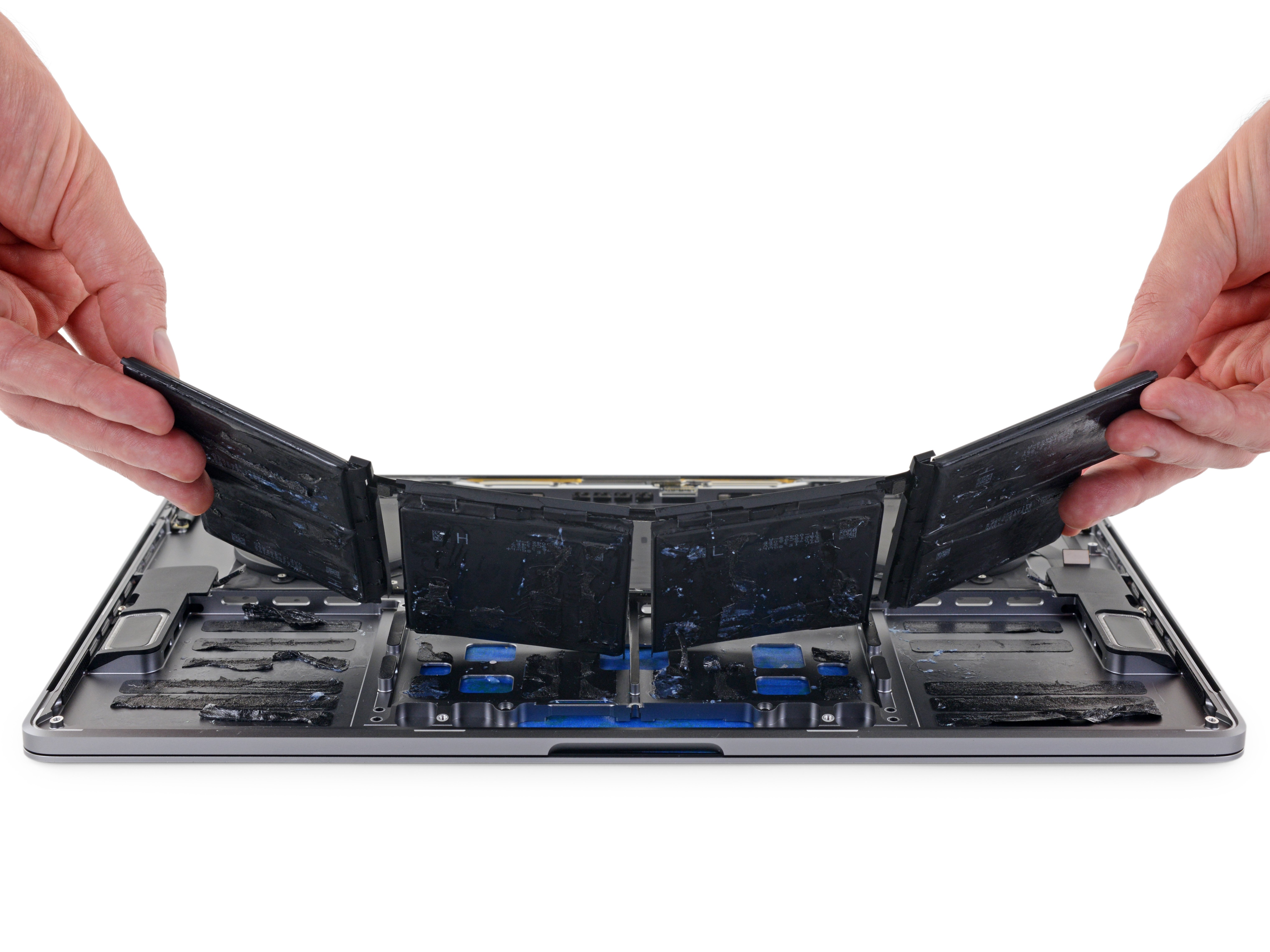

Here's ifixit.com 's take on swollen batteries. They are reliable, authoritative source of information about Mac repairs, not just some bloke on the internet.
Removing a swollen battery can be hazardous, but leaving a swollen battery inside a device also poses risks. To prevent potential device and bodily harm, don’t operate your device with a swollen battery. These guidelines offer best practices for removing swollen batteries, but can't guarantee a safe repair. If you have doubts, power the device down, place it in a fireproof container, take it to a repair professional and ask them to remove the faulty battery. Don't delay battery removal.
