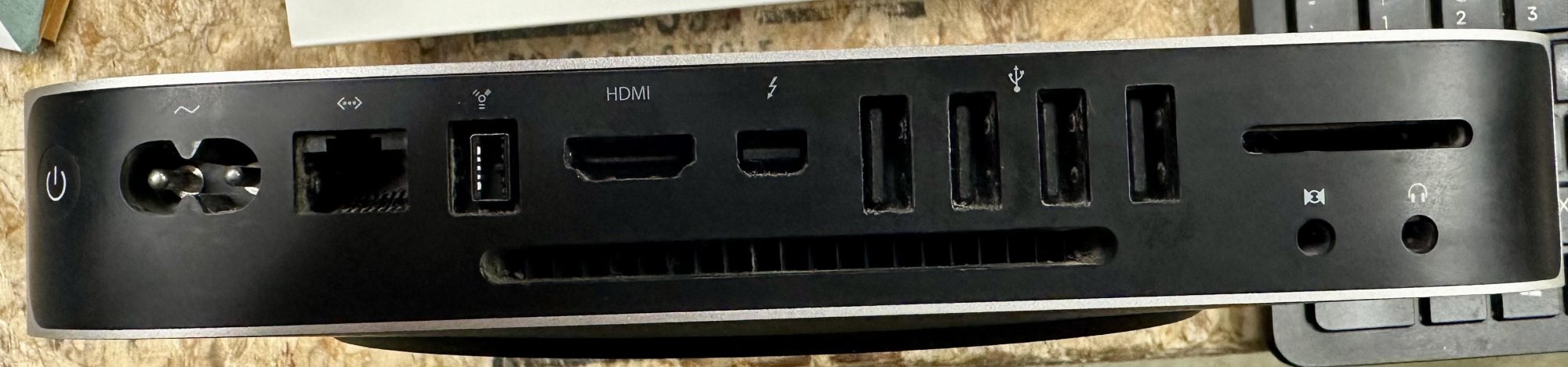

What port(s) would I use to connect? Do you think I could get one that is stackable?
The Thunderbolt 1 port, the one in the middle of your photo.

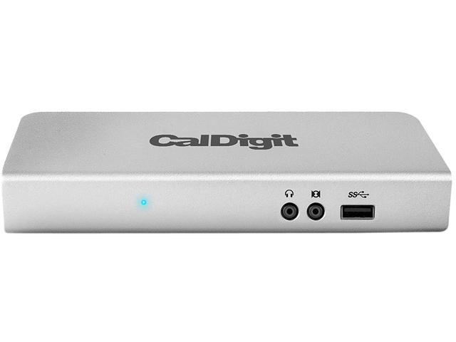

Not stackable, but I like the Cal Digit docks. They work well and have the TB3 version that I have works well with older TB1 and TB2 Macs.
I have the CalDigit CTS-US-60, it is a TB1 dock. You can find them for really cheap on eBay now:
I also have a CalDigit TS-3 Lite TB3 Dock, they also can be found a decent prices on eBay, and it works well for earlier TB1 and TB2 Macs:
