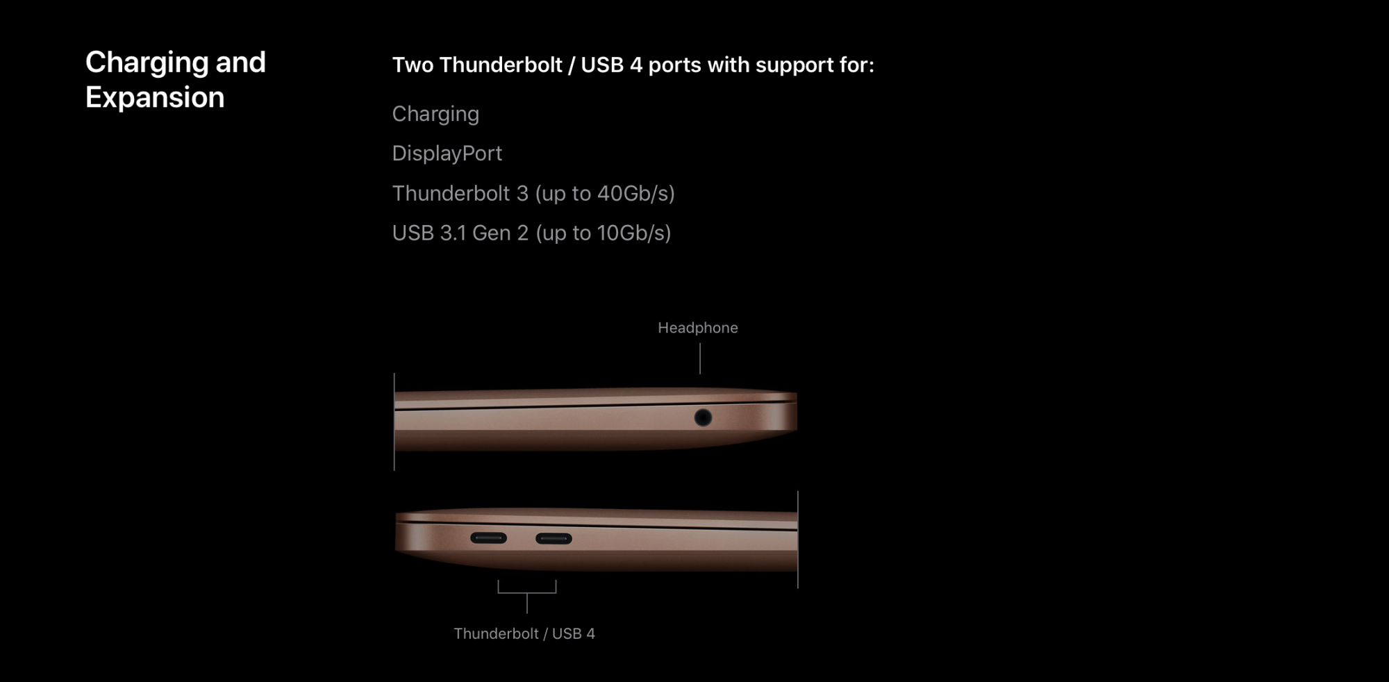

Apple's tech specs are pretty clear. You get up to 10 Gb/s with USB 3.1 Gen 2. There is no mention of 20 Gb/s. View attachment 1687565
That’s very interesting. I know that USB4 does not require devices to officially support 40Gb/s speed, but don’t they require support for atleast 20Gb/s?
Also if M1 ports are USB 4, but only offer 10Gb/s max USB speeds, then what special characteristic of USB4 are they offering?

I think that the USB4 part is a slightly modified version of Thunderbolt 3. But since there aren't any USB4 devices yet I don't think anyone really knows what the ports can do. Apple makes no claims at all for USB4 on the technical specs page. For now, if you need over 10 Gb/s you need TB3 compatibility.
The tech specs page says:
Two Thunderbolt / USB 4 ports with support for:
  • Charging
  • DisplayPort
  • Thunderbolt 3 (up to 40Gb/s)
  • USB 3.1 Gen 2 (up to 10Gb/s)
  • Charging
  • DisplayPort
You mean like what I posted 3 posts before yours? :D

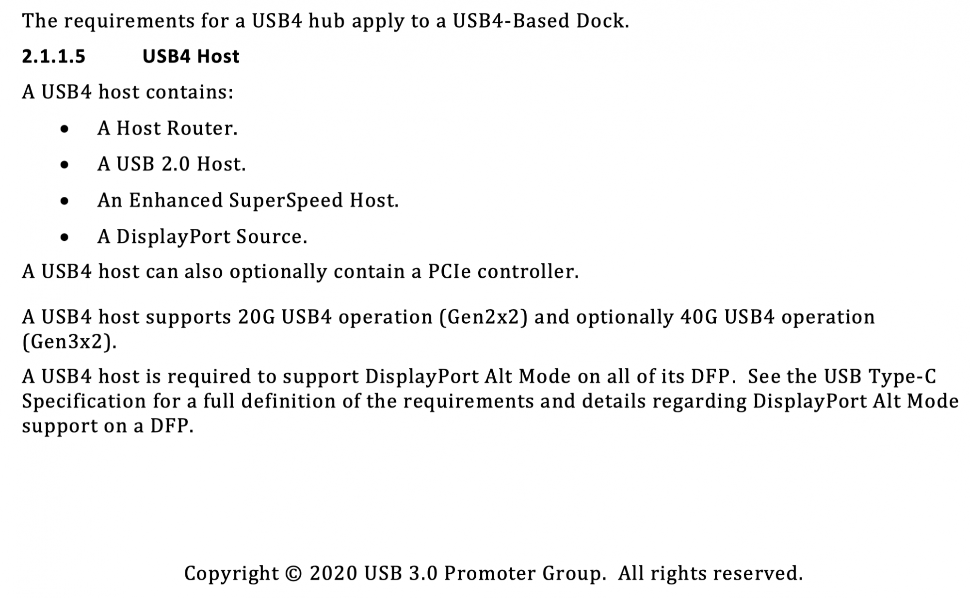

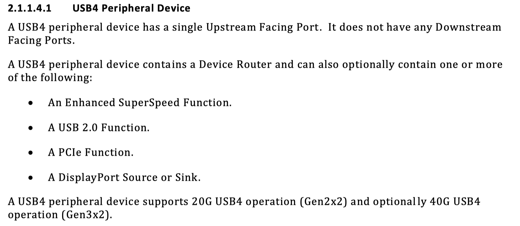

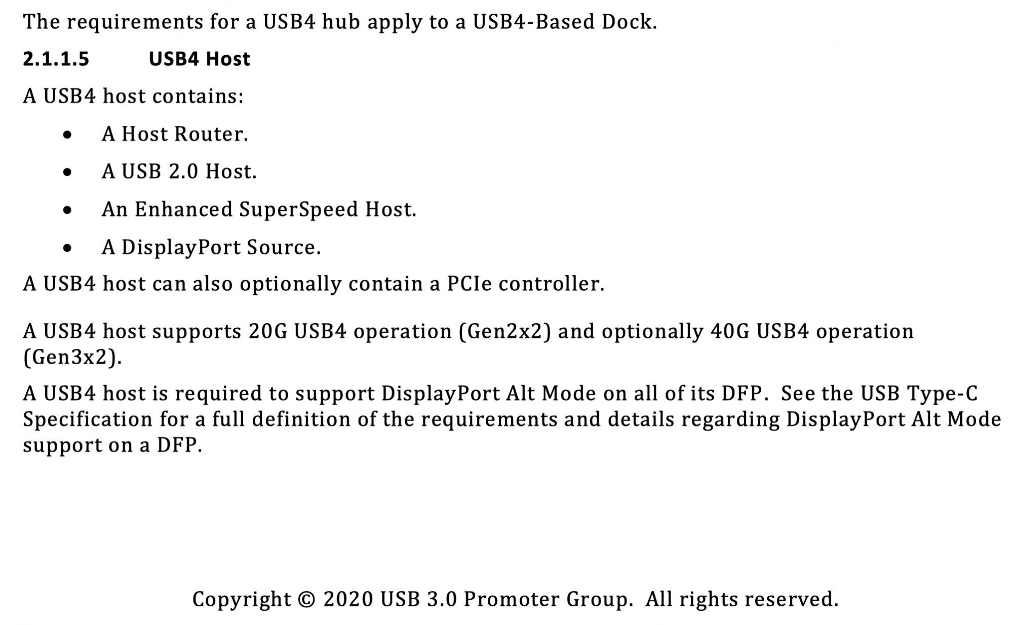

Yes, the IF Spec shows:
So presumably if Apple is claiming these are USB 4 ports, they should support 20 Gbps when USB 4 (Gen 2x2) devices start hitting the market even though they are not fully backwards compatible with USB 3.2 Gen 2x2 devices at the full 20 Gbps (as the term they use "Enhanced SuperSpeed Host" I believe can refer to either the 10 Gbps or 20 Gbps USB 3.2). As we know these M1 Macs also have a PCIe controller, I assume that USB 4 (Gen 3x2) docks, hubs, and peripherals, when connected to a M1 Mac, should support the full 40 Gbps.
You just have to laugh at how everyone kept telling us in 2016 that USB-C would simplify everything. Oh it sure simplified things alright.

I couldn’t help but notice the irony in the Copyright text ?
LOL!
They really need to hire a staff member who specializes in communications. It looks like they have not only managed to confuse all of us, but that they have also managed to even confuse themselves.
The amount of USB rebranding and renaming literally makes my head hurt. They have one of the most ubiquitous products in the world, and yet the way that they manage that product family is just absolutely chaotic.
