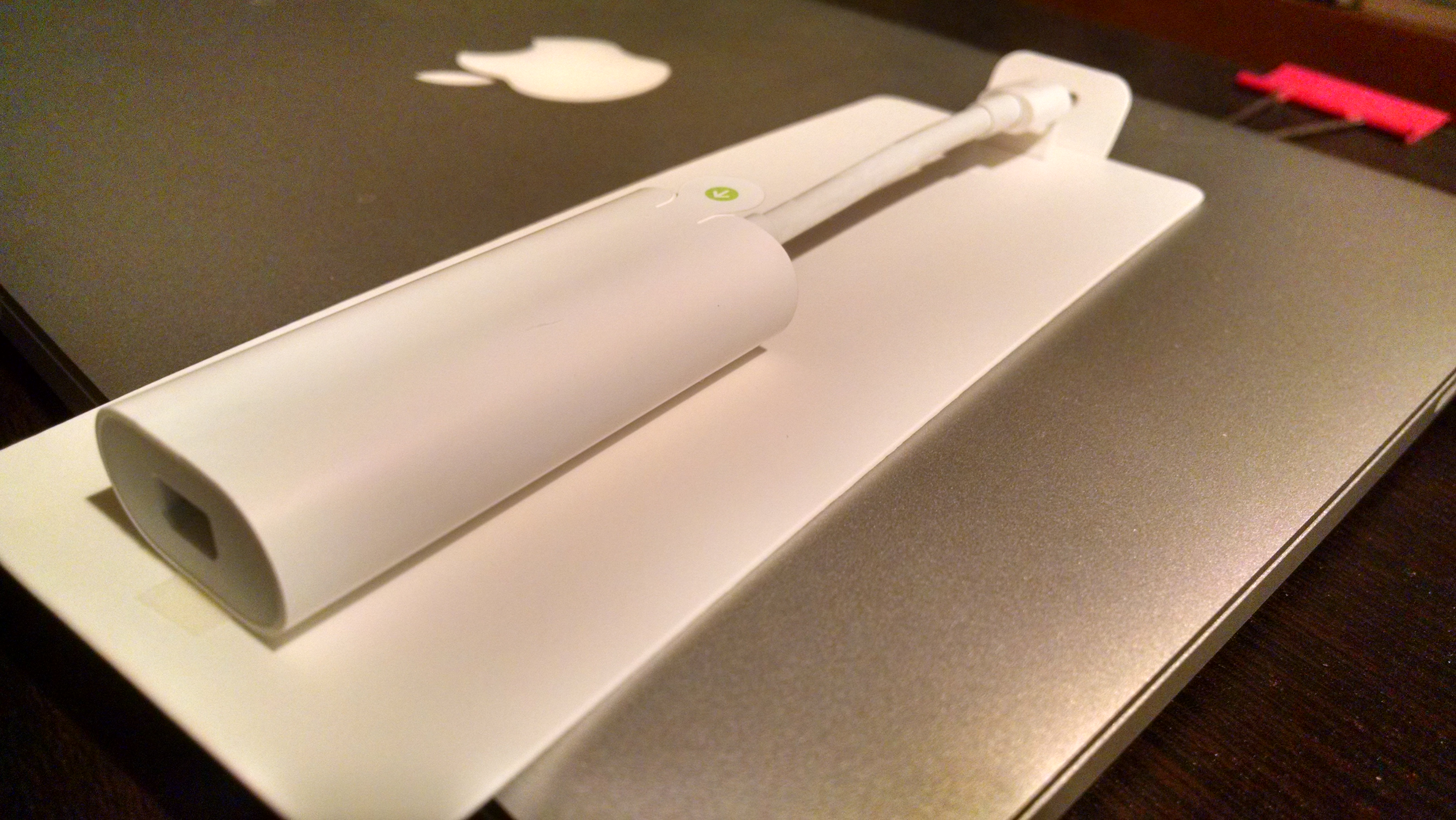

Not sure I completely understand your question. That adapter has tb2 female on one end and tb3 male on the other end. Below is picture.
Therefore such an adapter as the Apple one plus a TB2 cable (which I suppose comes with male plugs on both sides, suppose...since I never had one in my hands) should do the trick.
Correct. You need a TB2 male-to-male cable. A mDP will not work.
Thank you very much!
[doublepost=1531662842][/doublepost]
Exactly. The male TB3 will be used for a TB3 device, for instance a TB3 dock.
In the female TB2 plug comes one end of a TB2 to TB2 cable and its other end enters one of the TB2 ports of the MP End 2013.
In such a way the TB3 device works with the MP and the speed is of course the TB2 speed.
