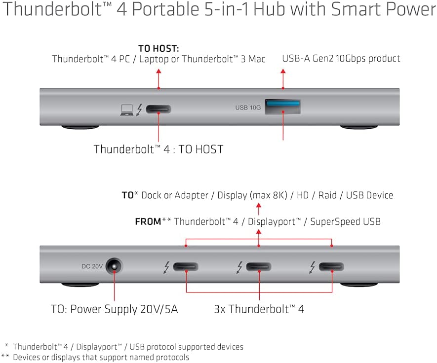

This is what Club3D had to say about using their Thunderbolt 4 hub with their USB-C to DL-DVI adapter, with a non-Thunderbolt host.
Club3D said:
We have just tested this setup with an RTX2080Ti and connected to the CSV-1580 to a CAC-1510 and its Passed So if the devices used support it, the hub will work with USB C ports - please note that the support will be limited to the specifications of your USB C device.
FWIW, my 2017 12" MacBook is non-Thunderbolt, and it supports DisplayPort 1.2.
CSV-1580 Club 3D Thunderbolt 4 Portable 5-in-1 Hub with Smart Power
CAC-1510 Club 3D USB-C to DL-DVI HDCP-off
You can't trust technical support people to be technical. Did they test with a dual-link DVI display, either 2560x1440@60Hz or 2560x1600@60Hz or 3840x2160 30Hz?

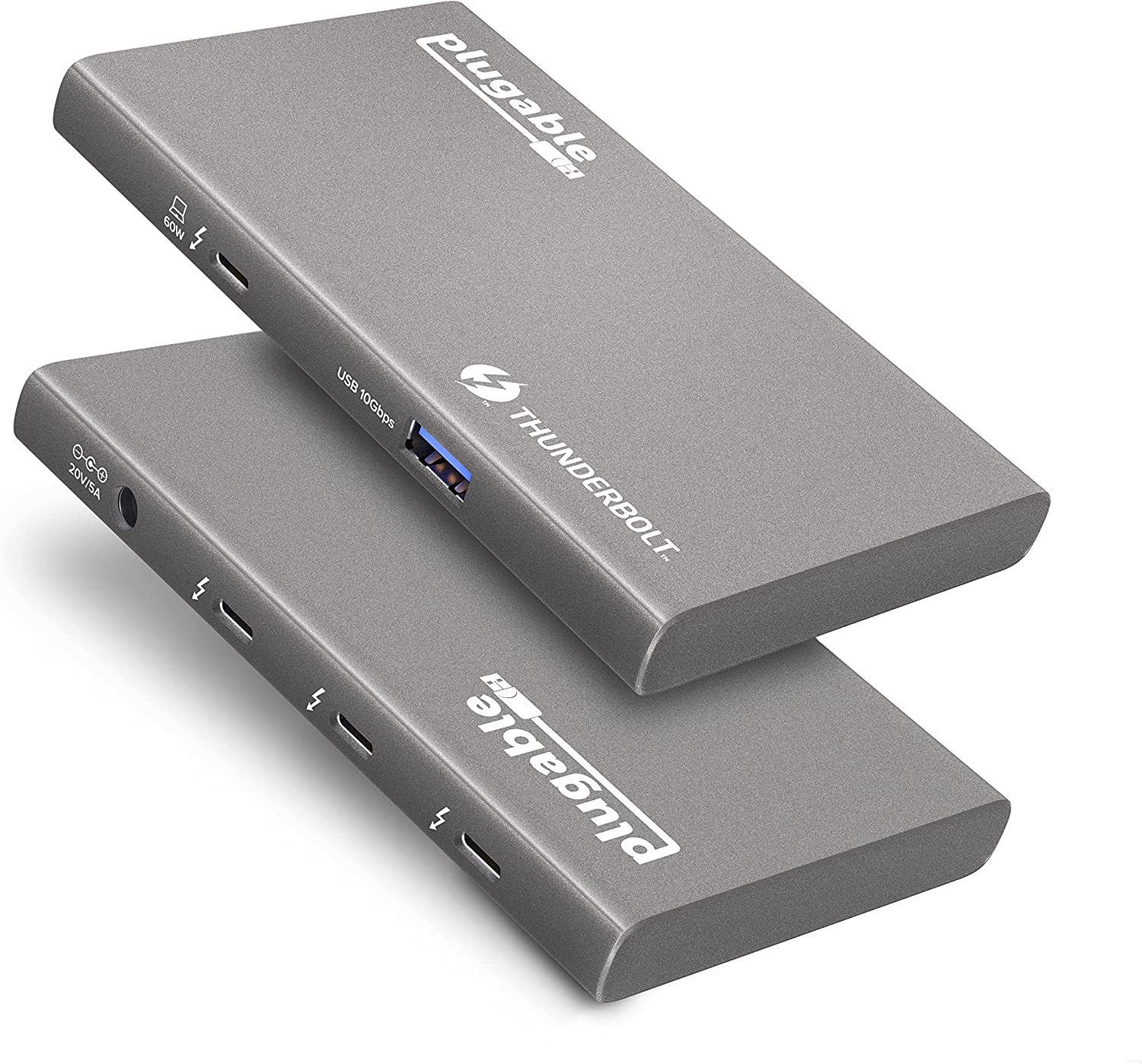

I didn't buy the Club-3D Thunderbolt 4 5-in-1 hub. I bought the identical Plugable Thunderbolt 4 5-in-1 hub which is currently on Black Friday sale for US$135.20 at Amazon.com or CA$207 at Amazon.ca. It comes with a free 4K USB-C -> HDMI 2.0 dongle in the box.
With a CableCreations HDCP-on USB-C -> DL-DVI dongle directly connected to my USB-C (non-Thunderbolt) MacBook, I get full 2560x1600 resolution with the 30" ACD. However, if I connect it through the Plugable hub, as expected, it gets detected only as a 1280x800 monitor.
Through the hub, I also tried using a USB-C -> DisplayPort dongle and then Apple's mini-DP to DL-DVI adapter, and again, it gets detected only as a 1280x800 monitor. This works fine at 2560x1600 if directly connected to the MacBook without a hub.
Not a big deal though, as I didn't buy this Thunderbolt hub to use with my non-Thunderbolt MacBook. I've just ordered a used M1 Mac mini so it should work with that. One USB-C port for the monitor, and one USB-C port for the Plugable hub.

With the above Plugable TB4 hub I was having intermittent issues with one of my USB-C SSDs losing the connection on sleep, and very recently I noticed my Huawei MateView 28 monitor occasionally briefly losing the connection. I was afraid it might be the hub slowly dying.
It turns out it may be the TB4 cable Plugable supplied. A week ago I swapped out the Plugable cable with a Spigen Intel-certified cable and all those problems went away. I’ll continue to test it out and see how it goes. If it continues to work well over the next several weeks, I’ll ask for a new cable from Plugable under warranty.

I occasionally had the same external USB-C SSD* sleep problem with the Plugable 5-in-1 TB4 hub, but that issue went away when I replaced the original Thunderbolt cable that the hub came with. Actually, the only reason I replaced the cable was because I later started to have random USB-C monitor* disconnects too, but when I replaced the cable, it corrected both the monitor disconnects and the SSD sleep disconnects.
I asked Plugable for a new cable under warranty, but did mention that rarely when I bumped the hub it might disconnect even with the new cable. Interestingly, instead of sending me just a new cable, they actually sent me a completely new hub with all the included accessories. So now I have two TB4 hubs. :) Perhaps they figured the TB port or AC plug might be loose or something.
