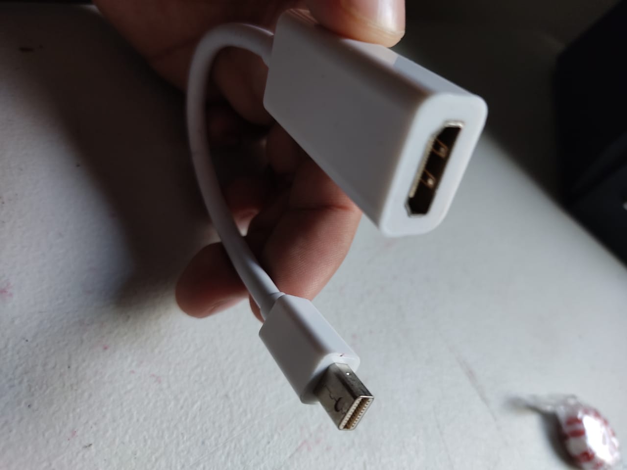

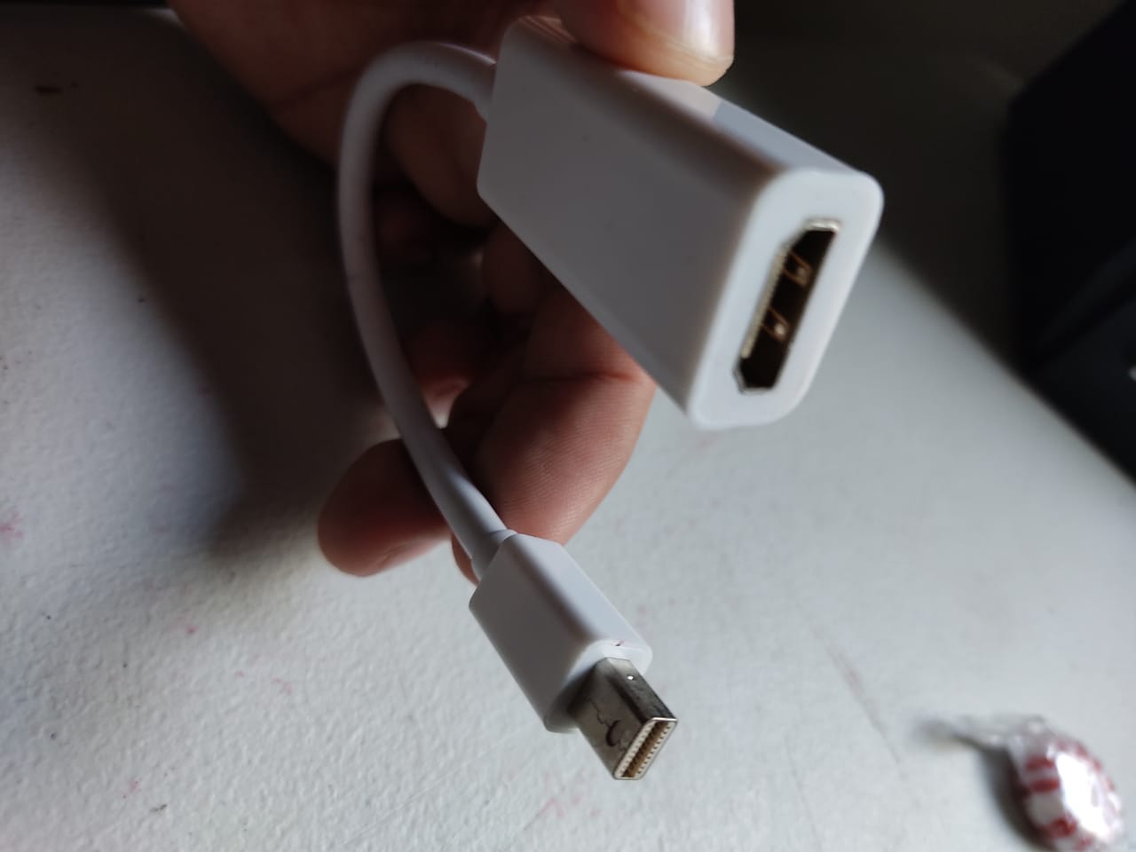

I own an old macbook pro (late 2011) that doesn't have an HDMI port so I bought a Thunderbolt to HDMI adapter to use a second display (LG Monitor). So far I have bought 3 adapters from different brands and all of them have stopped working after a week of use. The display stays blank with a "No signal" message. I've tried every solution I could find online but nothing has worked for me. To be honest, all of of these adapters have been fairly cheap but I don't understand why the same thing keeps happening. Is there something wrong with my macbook or could it be that I should buy a more expensive one? and if so, which brands are the good ones for this adapter? Please help, this is very frustrating.

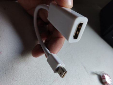

This is the adapter. I have 2 of these and they are pretty much the same, just different brands. I connect it to a regular hdmi cable and it works just fine with a windows laptop. Also, I have tried using a different display and it doesn't work either.
Today I'm getting a replacement and I could bet my life it is going to work and then stop working again. I'll keep this thread updated.

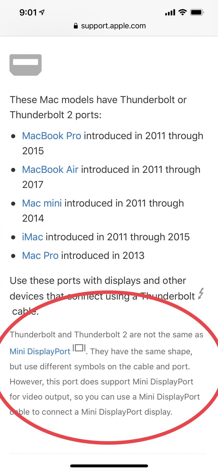

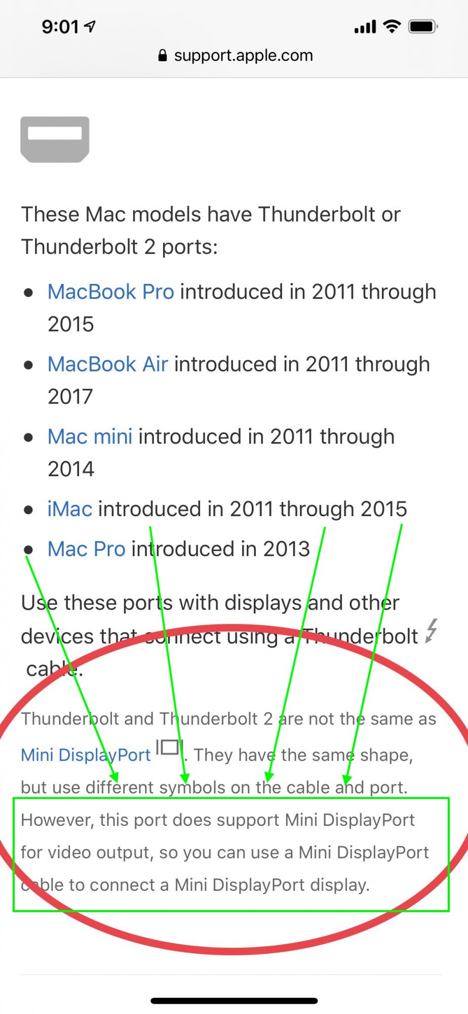

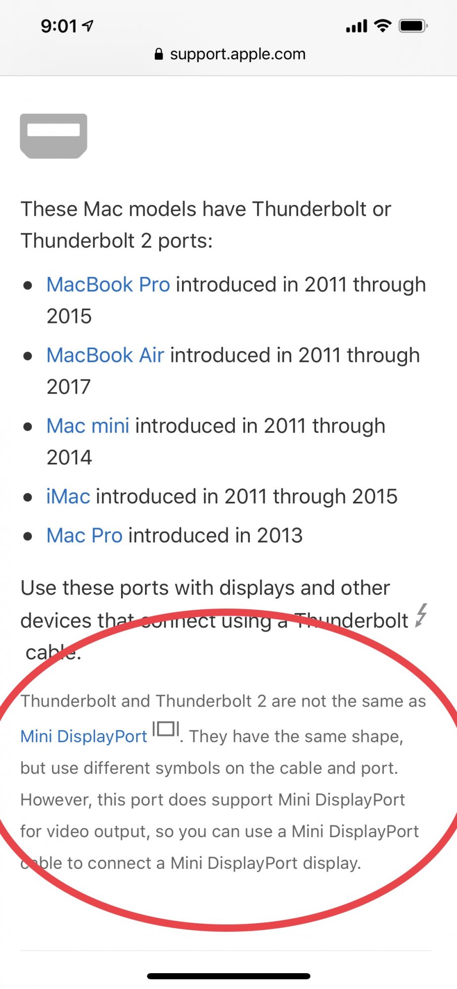

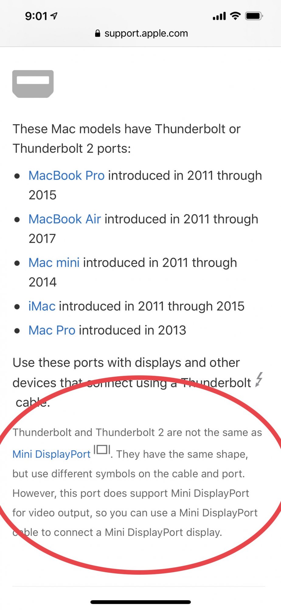

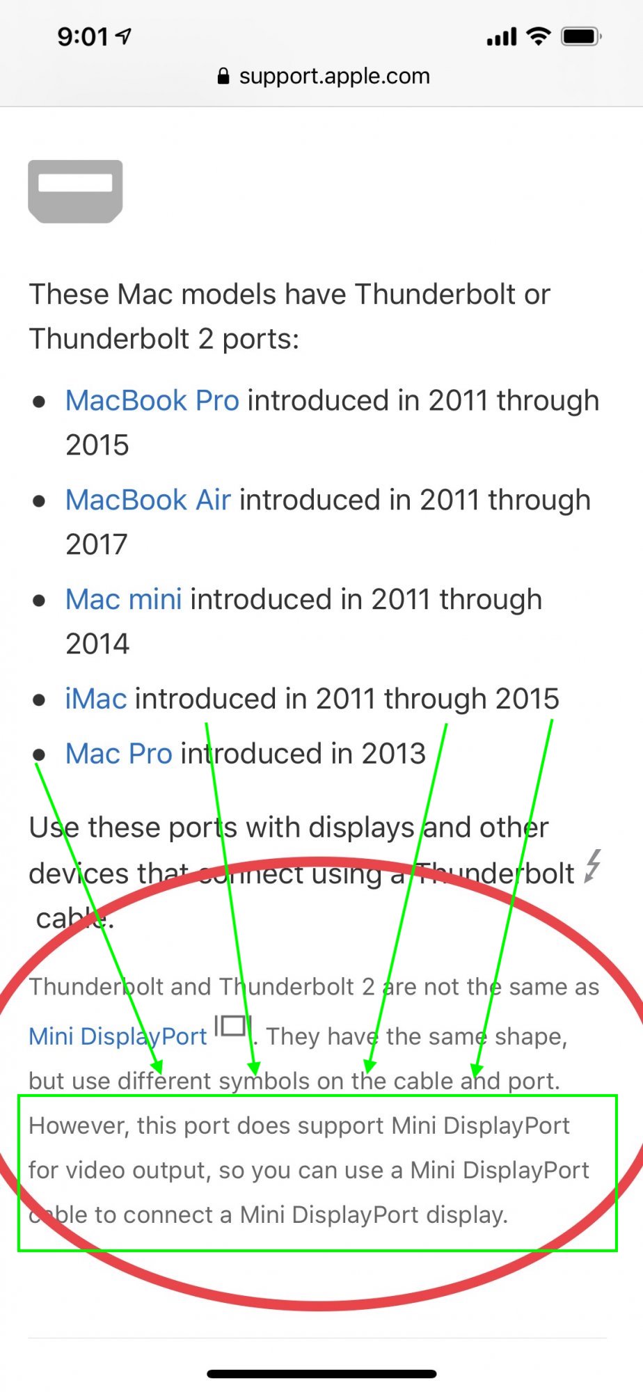

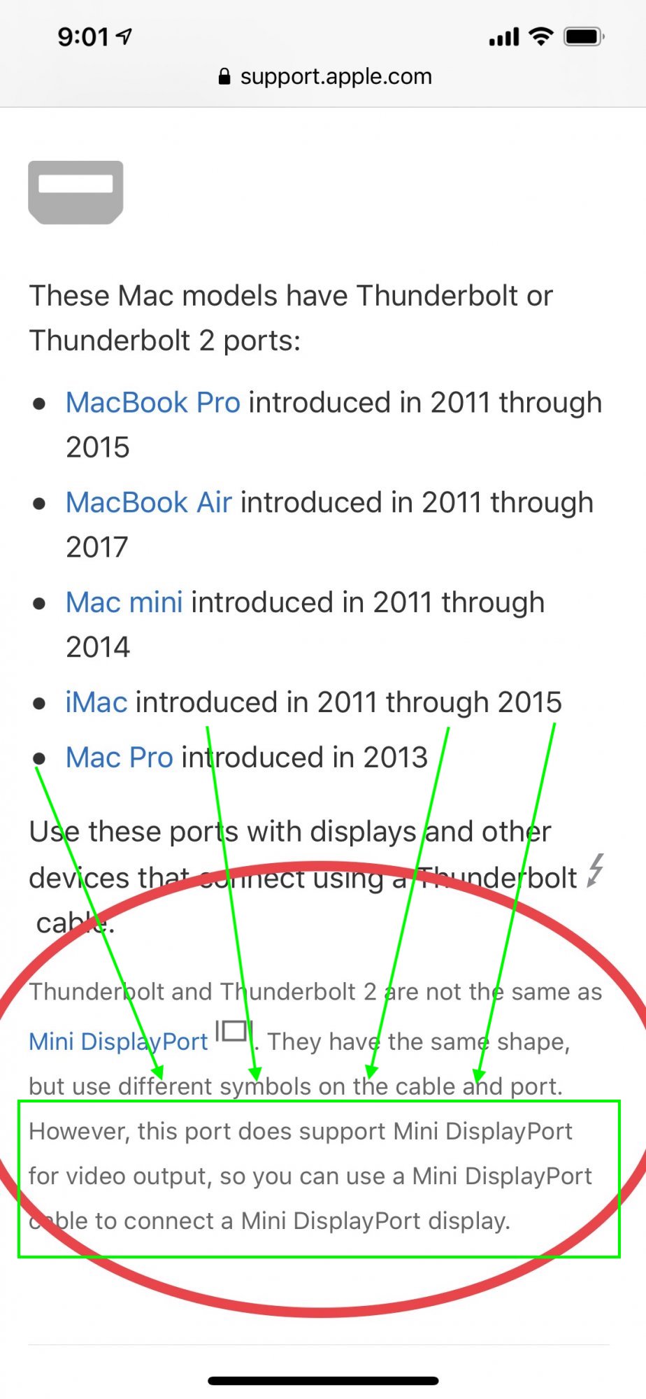

Try a minidisplayport (Mac end) to HDMI adapter (display end).
A 2011 MBP DOES have displayport output.
It's the thunderbolt port.
They are THE SAME THING.
Same port with different names and functions, depending what's plugged into it.
The minidisplayport to HDMI adapter plugs right into the tbolt port.
Look here:

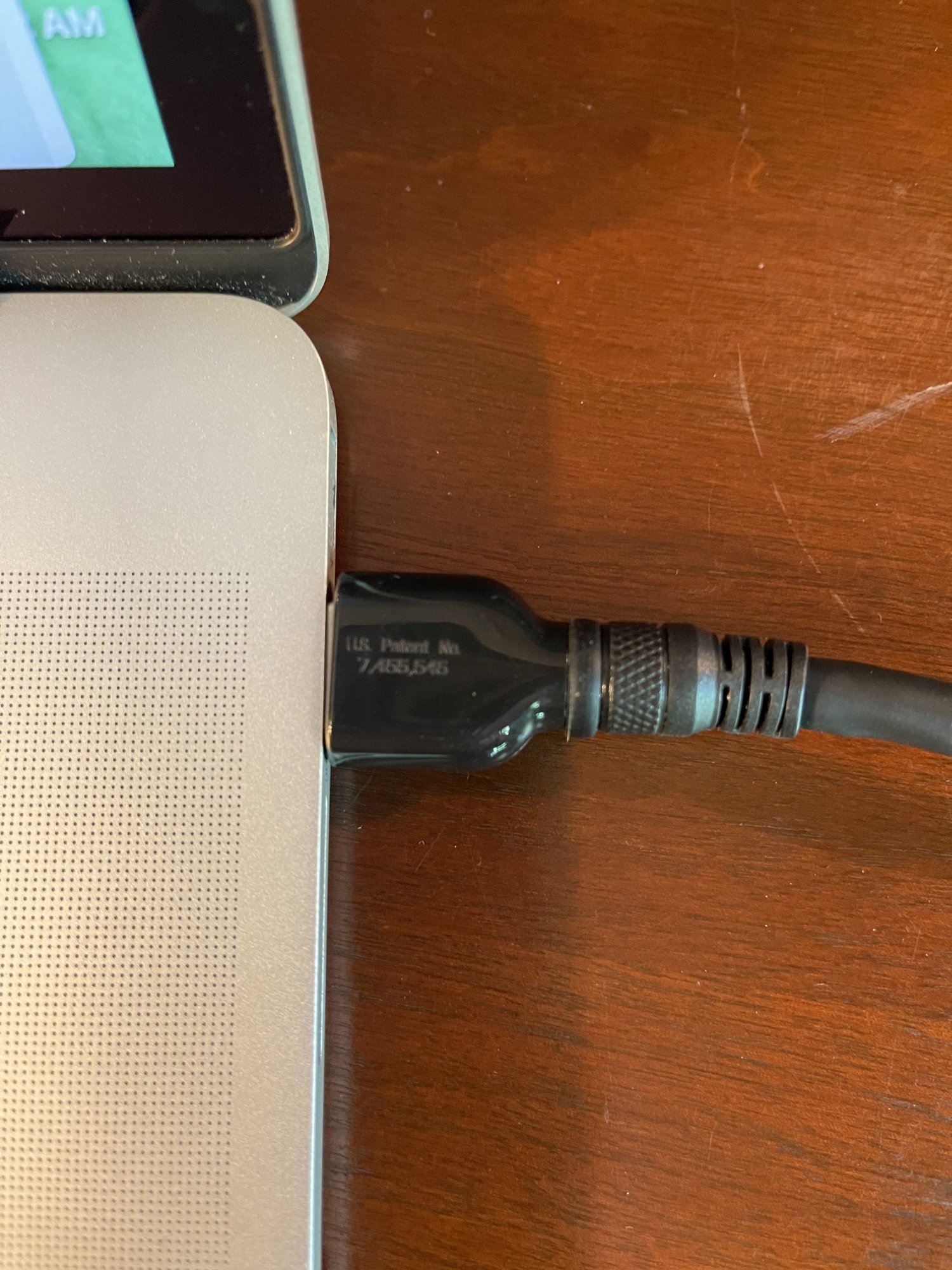

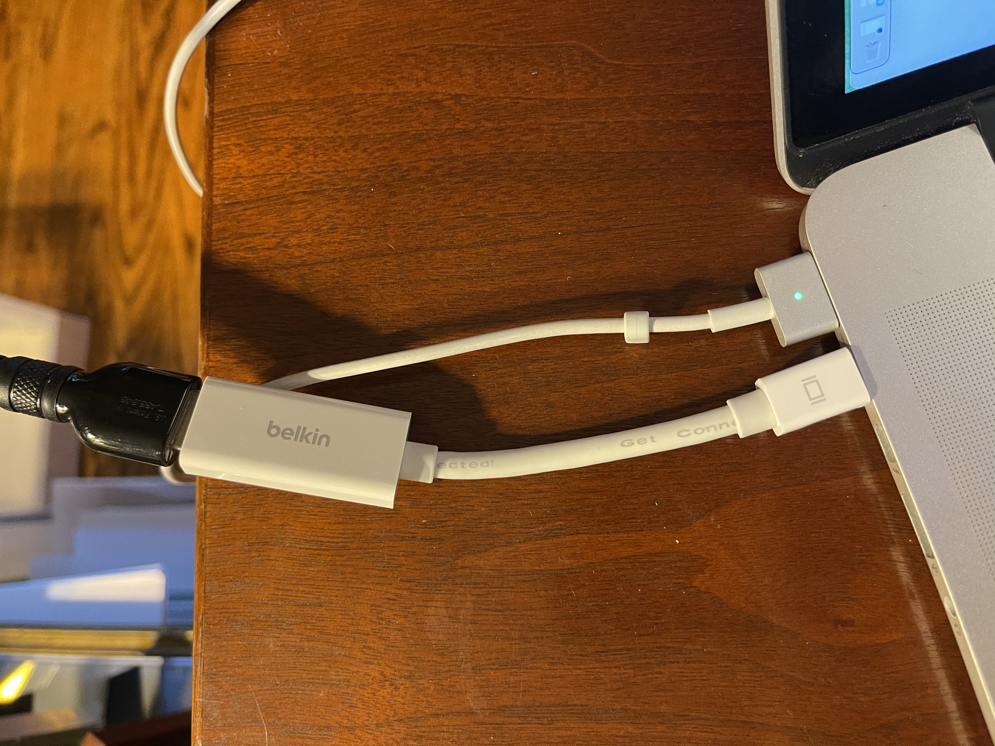

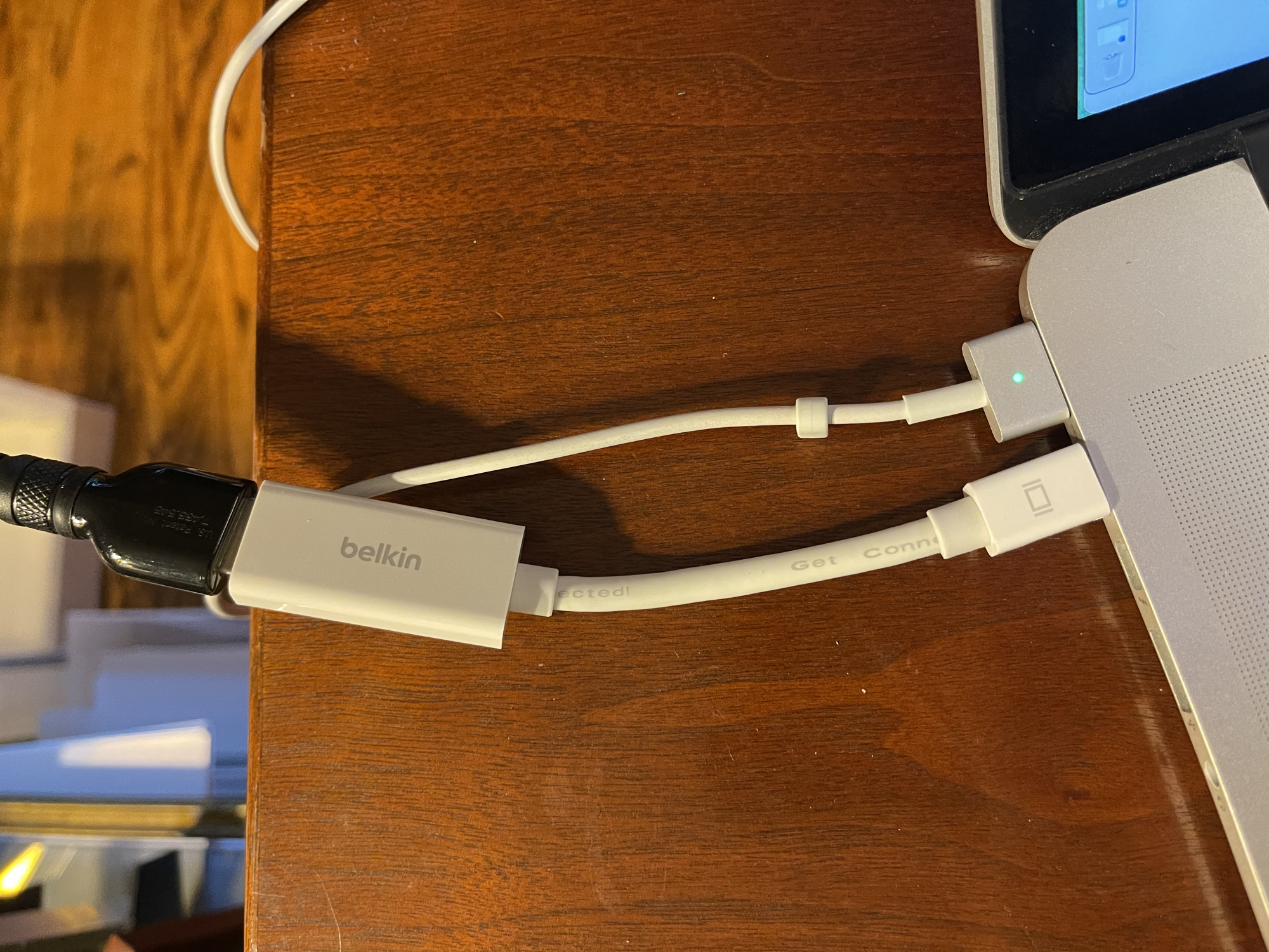

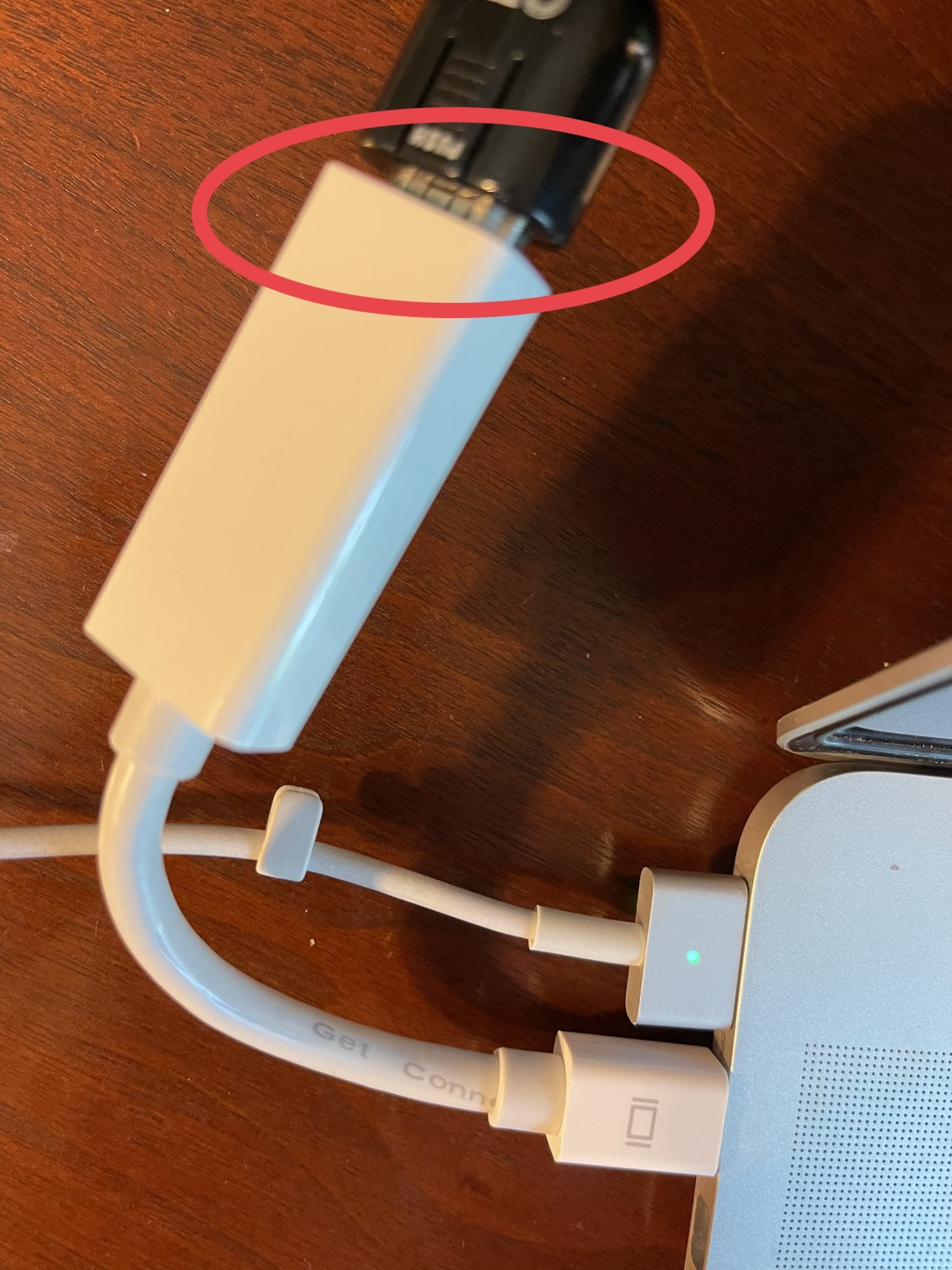

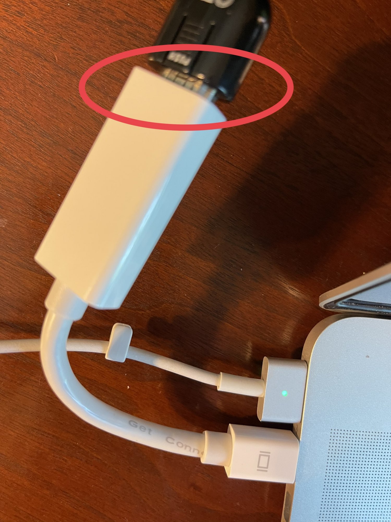

Ok Vertical Smile. I caught your drift. Maybe you can help me with this. I have a 2015 MBP (Retina, 15-inch, Mid 2015) running Big Sur 11.3.1. A vizio razor LED was running great as an external monitor by an HDMI cable from the monitor to an HDMI slot in my MBP until this past Monday, May 3rd. I have read about all sorts of issues of incompatibility with Big Sur. I purchased an adapter from Apple (Belkin HDMI to TB1 or Mini Display Port). I still get No Signal on my monitor. Here are 2 pictures. The first one shows how flush the HDMI cable went into the HDMI slot. The second picture is the way my adapter looks plugged in. The HDMI cable does not appear fitting flush into the adapter. Could this be the problem? Why doesn’t it fit flush into the adapter? Thanks for any insight someone may have.
Here’s the HDMI shown fitting flush into the HDMI slot

ere are 2 pictures.
I think you may have forgot to post the photos.

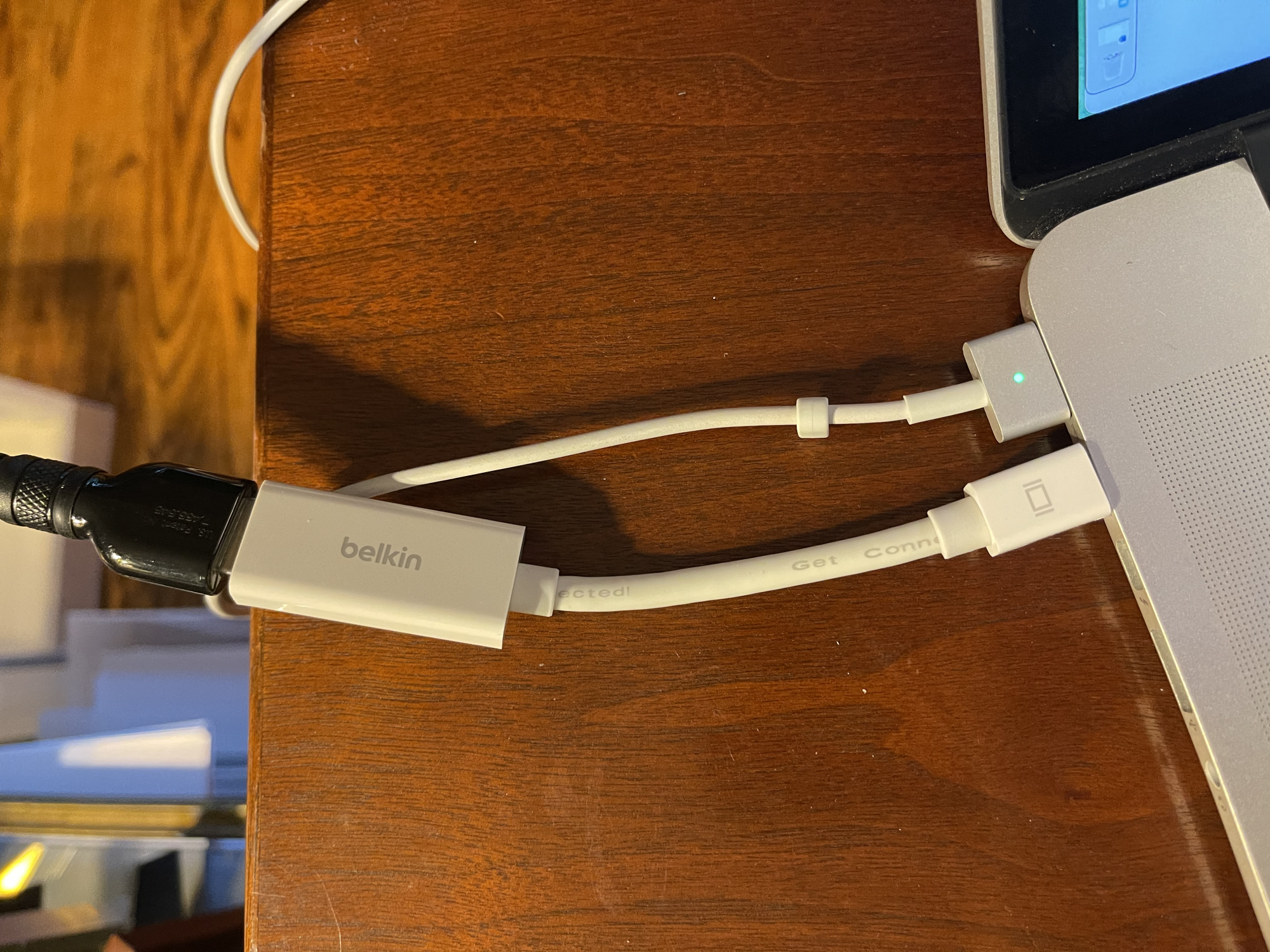

Can you post the adapter you purchased?

Can you post the adapter you purchased? It's posted below.

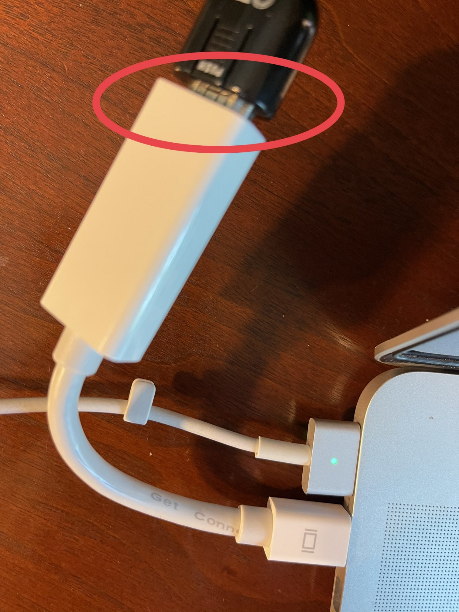

I don't think so.
The pictures look normal, I just think the adapter has a more shallow port compared to the MBP. If your HDMI port on the MBP worked, but the adapter didn't, I might think that maybe there is something wrong with the adapter, but since they both don't work, I would suspect a SW problem, or maybe a HW problem.
