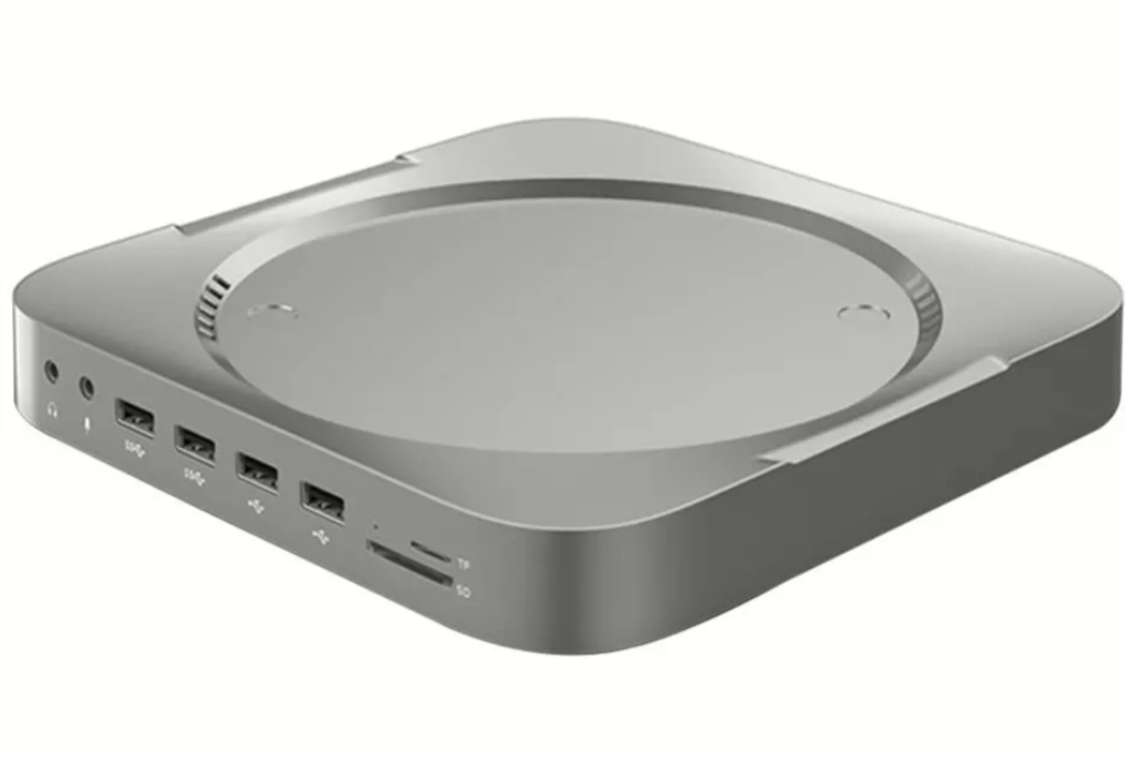

They are all pretty much generic ones using 3 or 4 reference designs under a panoply of brand names. Something like this:
They look to be much of a muchness feature wise - some offer storage, usually SATA. I shall do the usual due diligence before plumping for one but at least it should have a fighting chance of actually working.
I can see the aesthetic appeal matched up with a Mini. :D
