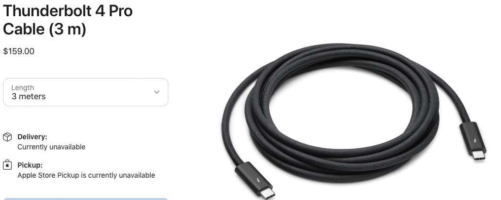

Thanks for the info.
So if I want a longer cable between the Studio Display and the Mac Studio, is this the correct cable:
The confusion is aggravated by people's constant incorrect usage of "USB-C" in this context.
All "USB-letter" terms only relate to the connector and NEVER to the data protocols supported except that some connector set an upper maximum in their range of protocols. Combine that with the fact that Thunderbolt never has had its own connector and merely piggy-backed on some other connector (mini-DisplayPort for TB1 & TB2 and USB-C for TB3 & TB4) and the confusion expands. The 3rd compounding factor is that the USB consortium has (foolishly?) chosen complex terms for their data protocols/speeds which humans naturally try to trim to shorter "nicknames", often incorrectly using the connector's name.
Agreed. Retroactively rebranding USB 3.0 to USB 3.1 Gen 1 (and then doing it again with USB 3.2) made it difficult to make any sort of sense whatsoever of what speed you were actually going to get.
The whole USB-C connector itself is great, having one type of port for multiple protocols is great for backwards compatibility and for supporting future protocols without making a mess of new ports. But the cable situation (and the complex naming) is an absolute dumpster disaster that is making it even more complicated than the old way of doing things. In my opinion, unlabeled power-only cables shouldn't even exist. Every USB-C cable should be mandated to support, at minimum, "USB 3.2 Gen 2x2" (20gbps), or otherwise be labeled as a PD-only cable. And any cable that supports TB3/4 must do so at 40gbps (actively or passively) and be labeled as a TB cable.
Instead, we've got a plethora of unlabeled USB-C cables that only support 5gbps USB, some that don't even support data at all (or do so at USB 2.0 speeds), and others that claim to support Thunderbolt 3 but only do so at 20gbps (and worse, this isn't even technically incorrect since TB3 allows this for passive cables). And then there are even more that actually do support full speed thunderbolt 3/4 but aren't certified to do so, and thus don't have the lightning symbol on them. It's an absolute mess and it's almost impossible to actually know what you're going to get without looking at the manufacturer's spec sheet.
