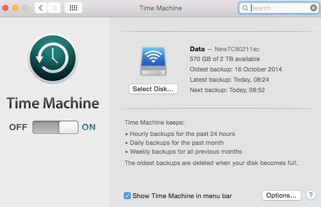

I don't think this will help anyone, but the only thing I did was to restart my TC using the Airport utility on my iPhone.
Once it had restarted, it was again visible in Finder and Time Machine seems to have been working perfectly ever since:

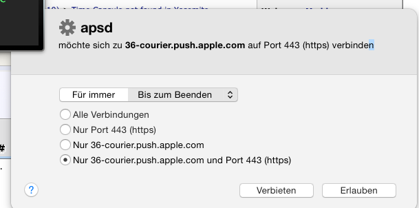

after some try and error i think i got the "bad guy" for me.
But i'm not able to recordnize why?!?
It seems that it is the "apsd" service respect to "LittleSnitch"
If i leave the "allow any connections" rule deactivated - everything went fine.
If i activate the rule i can't connect to the TC ?!?
don't know why, because the rule is set to "allow any connections" ?!?
