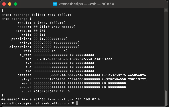

Curious about this command.
sudo sntp -sS time.nist.gov
Is this a one time time check or does it run in the background continuously?
Here is what I get when I run it.

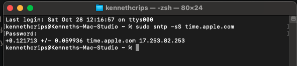

Here is the Apple time server command.
sudo sntp -sS time.apple.com
With this command this is what I see on the terminal display. It is obvious which one is better.
Yet again, I'm going to refer you to my ham radio blog.
This is the method I used to recommend, see here. However, tt does nothing from Big Sur onwards. I can't stress this enough, it does nothing, it does not work. Hence why I (and others) suggested ChronyControl. This is all detailed in the first few posts of this thread.
