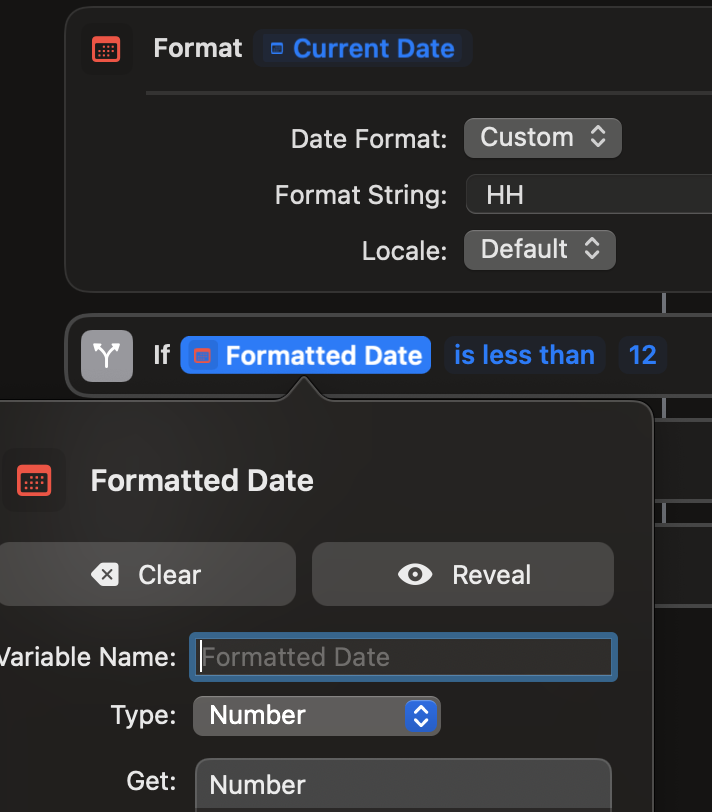

I just started experimenting with shortcuts and I need some help to figure things out. I want to create the following 2 shortcuts/automations.
Automation 1: When the iPhone connects with CarPlay, if the time is before 12:00, say good morning. In this automation I can't figure out how to discover if the time is before 12:00. I can see there are options for date and time, but not just for time.

Re: #1. Easy. The Format Date action allows for custom formats. Select custom and specify "HH" (no quotes), pass "Current Date" variable. Action will return 0-23. Pass that value to your if statement, making sure the passed value is treated as a number.
