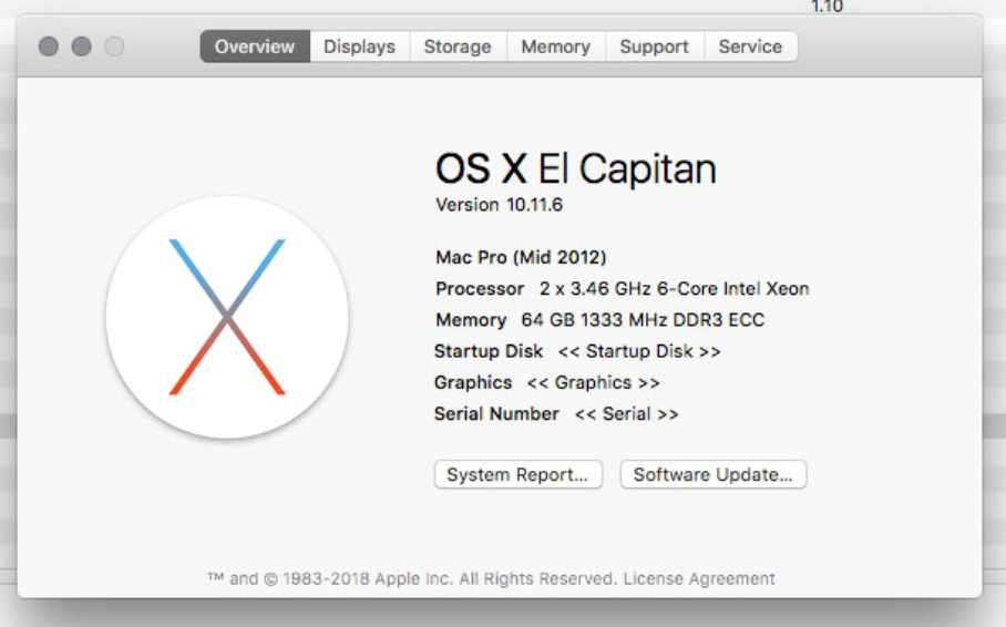

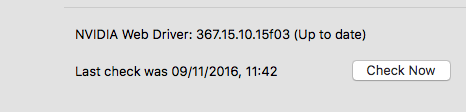

As far as I know I have the latest drivers and the latest install of Sierra. Below are the details

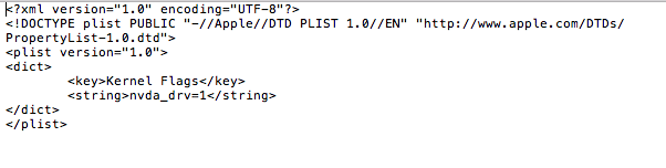

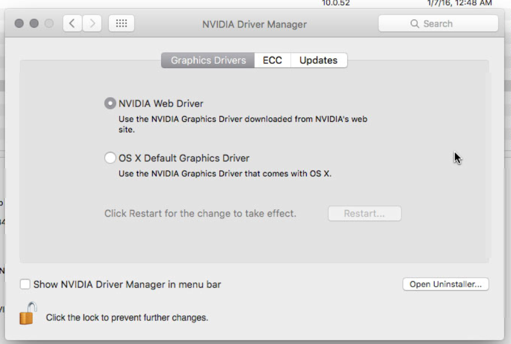

I've tried adding a Kernel to the com.apple.boot.Plist as advised by Macvidcards in his Blog to get the system to boot using the Nvidia driver.

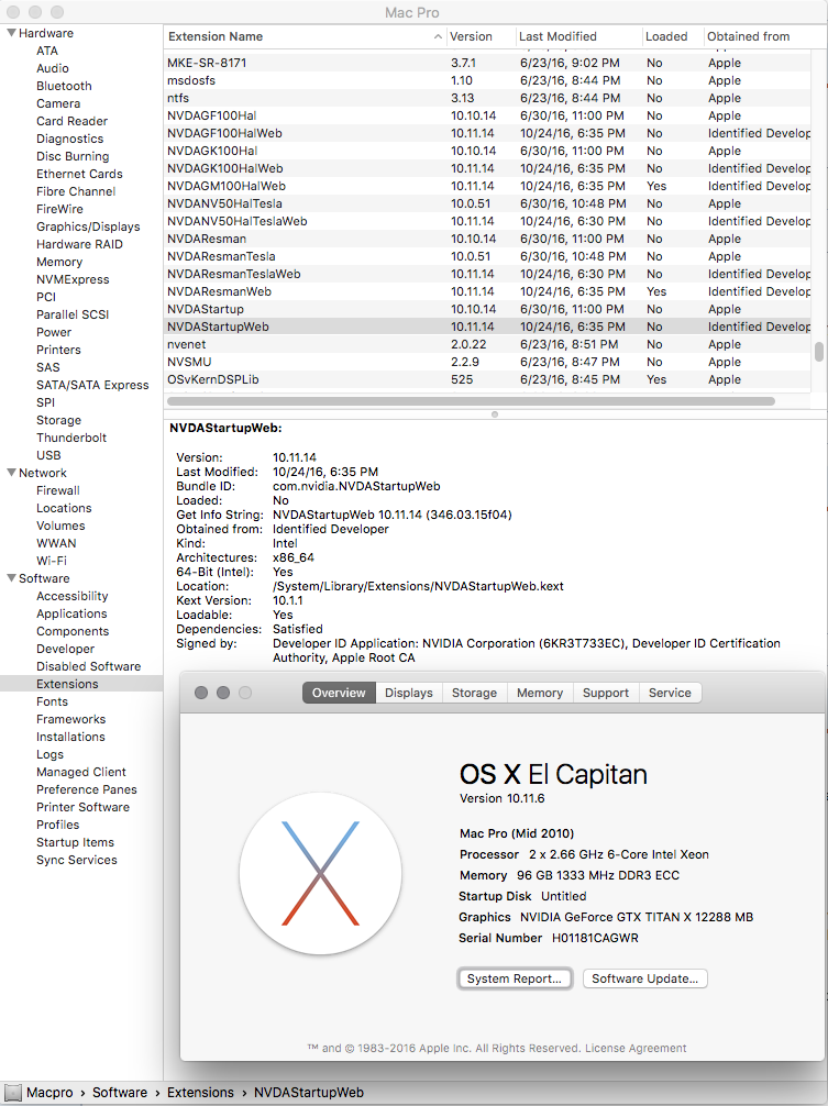

And as far as I can tell the system seems to be using the drivers even though the Nvidia panel shows the default OSX drivers to be selected.

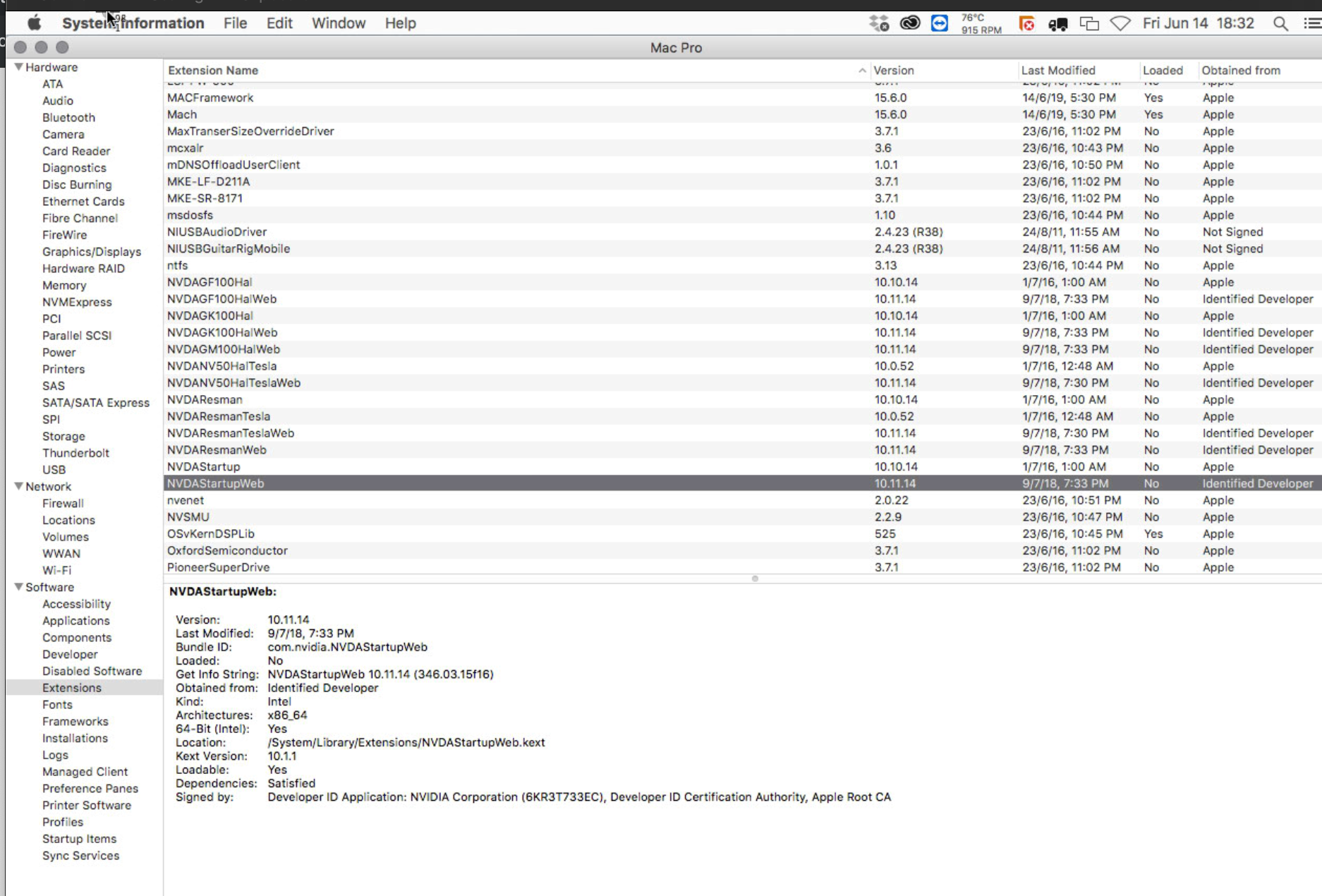

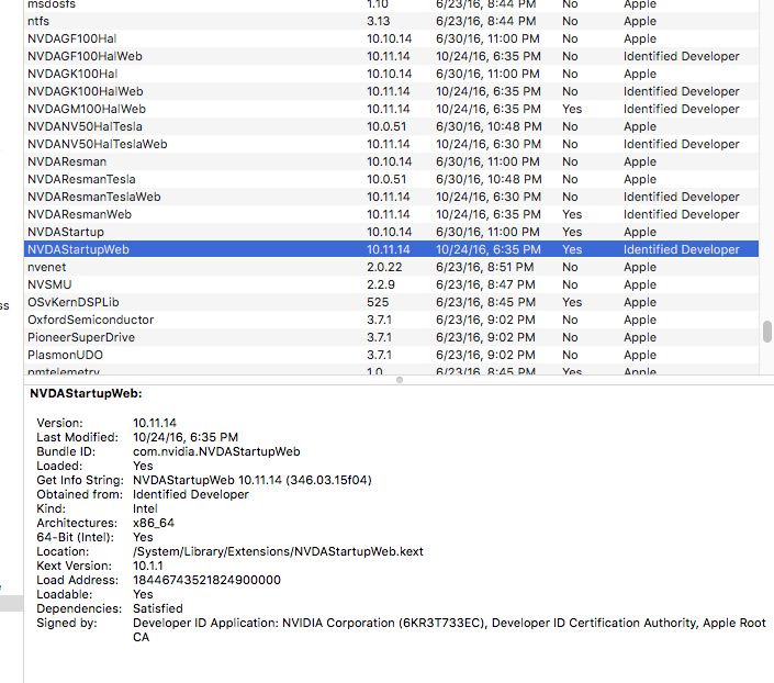

So correct me if I'm wrong but to check that the drivers are being used I go to my About This Mac system report Extensions and then the section that says NVDAStartupWeb

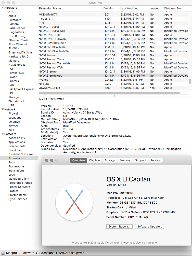

How about keep SIP disabled?
Anyway, your screen capture clearly shows that the web driver is not loaded.
Peter,
In the extension list you posted the loaded column for your selection says 'No'.
Are you having trouble selecting NVIDIA Web Driver from the desktop pull down menu at the top right?

Hp82: I haven't tried loading it with SIP disabled. I'll give it a go.

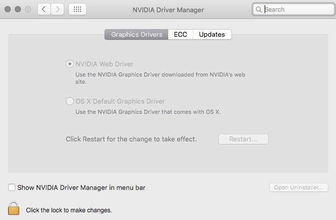

Pending: Wow can't believe I didn't see no to loaded, I think it's because I saw the yes for loadable.I don't have trouble selecting the Nvidia option but it then says restart the computer, which then resets it back to the default OSX driver.
So if my driver isn't loading, how do I activate it?

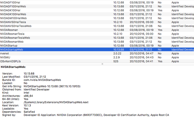

Reading this lead me to check the same and I find mine is not loaded either. This is on a clean install with the TITAN X in the machine the whole time.
But the nvidia system pref shows the nvidia driver selected. So what's going on here? kext says not loaded, system pref says it is.

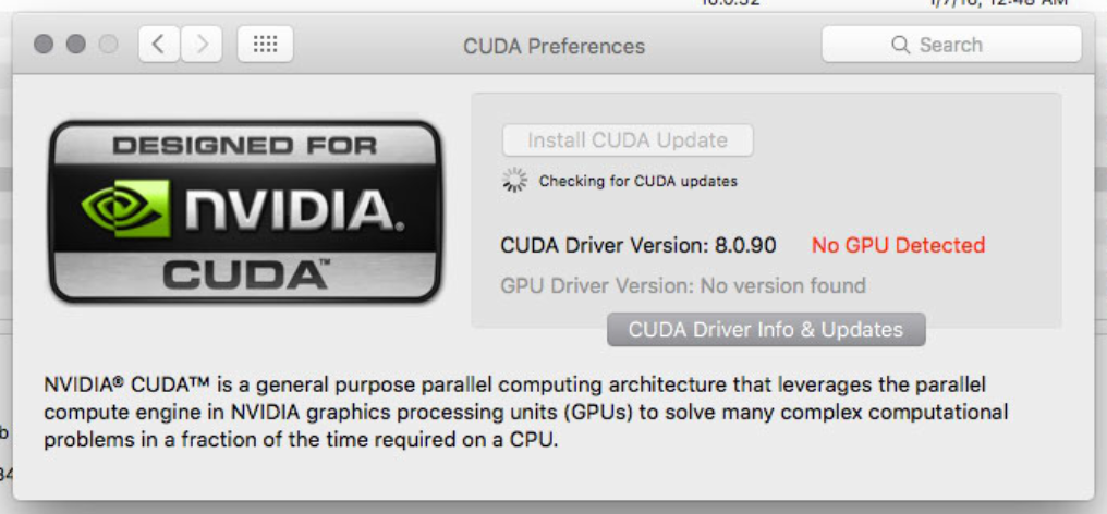

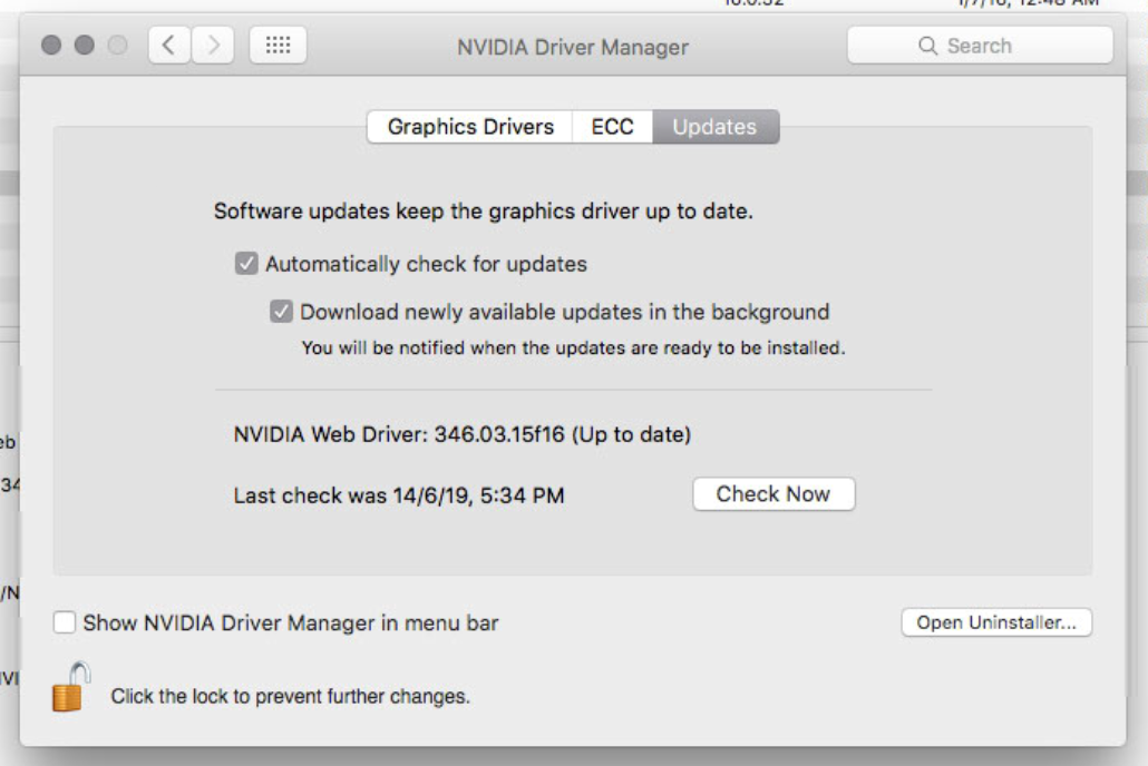

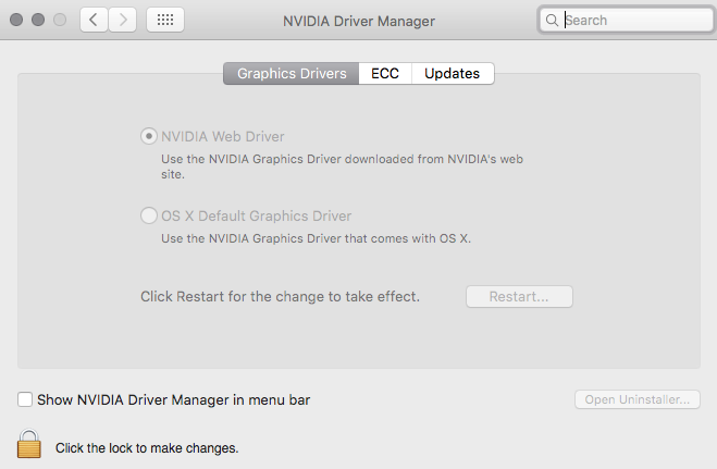

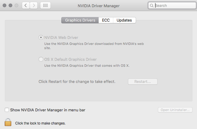

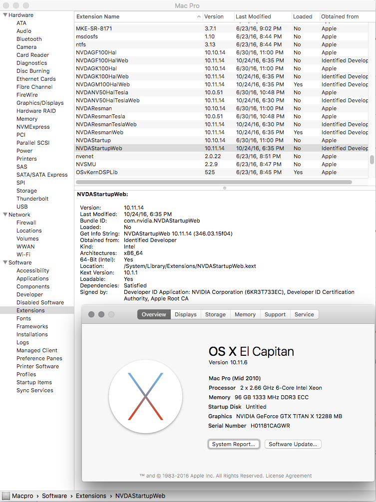

Guys, I also got a TITAN X,
I did the scheme to connect her in the sata power and the minis 6 pin.
But the screen goes black!
I access macpro via sharescreen with my macbook, so I updated the system to the latest version of (El Captain) and downloaded the latest updated driver for that one, but it still does not work!
I saw you ask to turn off PRam and SIP, but I do not know what these two things mean! heheh could someone help me, I'll pass the screens here for you to see!
