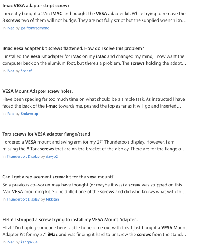

Yeah... personally the Apple VESA mount wouldn’t be an option. It is supported by those fragile brittle screws. If they snap, everything is crashing down.
With that in mind, I’m not even sure I’d trust the Apple stand either. It attaches to the same point.
Personally I would have designed an interlocking connection that didn’t require screws to stay assembled or supported. The screw should simply be a retainer not a supporter.

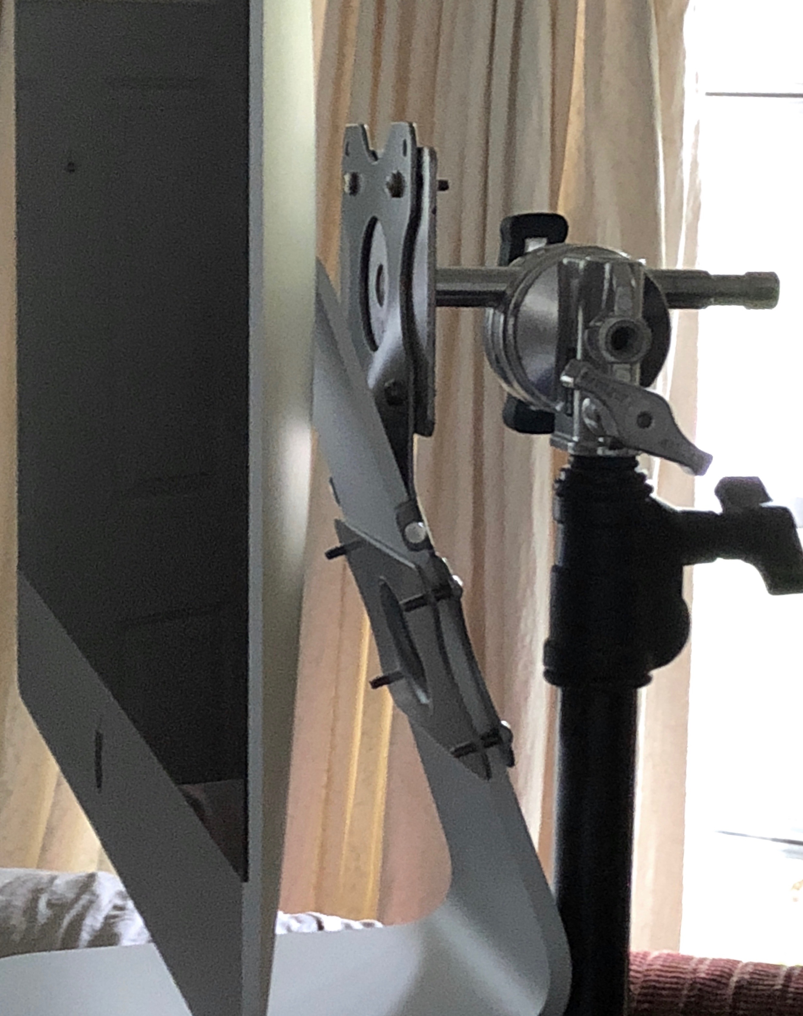

iMP Pro owner here, with the iMP mounted to a Herman-Miller Flo Plus. I used the stand for a few weeks, read the BS claims about the fragility of the screws and happily mounted my $5k iMP to the adapter. There's 4 more in my offices that are mounted to arms, all work just fine.
Regarding the screws, the units in the 5 adapter kits were all steel. Zero issues. As to others claiming that the screws are zinc, I'll call BS from my own experience. As to others calling out the screws as fragile, I'll ask them to prove it - I included photos on AppleInsider in a post and, it'd be a waste of my own personal time here I wouldn't put it past the makers of the adapter kit to put "Chinarello" fakes on the market. I'm still going to call out the nitwits on YouTube about this issue after seeing first-hand how ham-handed some of them have been with drills - I've designed and built about 70 bridges and seismic upgrades over 25 years and have seen great work and work that have landed people in jail for faulty work, and what I've seen on YT leans toward the latter, in that I'd fire them on the spot and ban them from my project sites. I also used my Effetto Mariposa Giustaforza II torque wrench with the existing and new screws, installing the new screws to the same setting as the existing screws - QED.
The adapter in the non-iMP iMac is not the same as the adapter used in the iMP, with a different connection method. Also, the iMP weighs more than the VESA iMac. And, Apple has been shipping a VESA iMac for about 8 years or so - and there's been no doofus on YT using a drill on the iMac you're alluding to. That yammering that idiot posted has nothing to do with the unit you're asking about, they're two different mounting systems. My offices have 5 VESA mount iMacs, and there's been zero issues with any of them (I write the checks, it's my company, so I know if there's a fault or other issue...)
Honestly, just ignore anyone who has zero experience with these adapters. The means of attaching the adapter puts minimal stress on the fasteners if its installed properly. Maybe I don't know what I'm writing about, although last time I checked all of the bridges I helped design and build in the past 25 years are still standing...

Apple discussions:
No need to wait for a vesa mount. Good luck finding one in reburbs. If you are going to ship or car carry your iMac, all the most popular choices are designed for the desk stand. By Vivo, marketed by TeetherTools too (for about 4x the money). Paid $20. Have seen it for less since. That is a six inch baby plate (wall plate) in the photo using the 75mm mounting holes. Lots of other options to the baby plate if you want to spend more money. Upgraded the fasteners to stainless allen heads. Yes, shorter screws would look better.
Nope. No affiliation. Just sharing. ~J
Apple discussions:
Saw those, the YouTuber was who I was alluding to, the idiot with the drill...
They're not just screws, they're screws with threadlocker on some of the threads. I took a few minutes to look closely at the YouTube vid that you embedded as in using the 4k resolution from about the 1:35 point to the 3:30 point and IMO he did not properly install the fasteners. My nits to pick are that all of the screws in my kits are steel, the YouTuber didn't offer which tool he used to install/remove the fasteners, why didn't all of the screws snap off if they're all made of the same material (just writing that here), when looking at the screw heads (around 1:20) there appears to be what I would judge as signs of fastener damage at where the tool bit meets the screw - a sign of either using the incorrect or a mis-sized bit and/or over-tightening, zinc and zinc alloys have a bluish color at room temperature and I didn't see any hint of a bluish color, "black zinc" machine screws is actually a nickname - the true name of the alloy is "steel zinc black" and generally has a hardness rating of Rockwell B70 - B100 (near and overlapping the range of both 18-8 and 316 stainless at Rockwell B85 - B95), and the closeup of the failed screw has a "shiny" appearance without the dullish or matte finish I always see in zinc and zinc alloy fasteners.
Not piling on but the bits I didn't see in that YouTube video was how the attempt at extracting broken screw was done - he said that he used an extractor but he didn't say that he used lubricant with the extractor, the drill bit used to "drill out the screw" did not look to be a cobalt unit, and despite going to a lot of trouble to explain his process I didn't hear him say (explicitly) that he used the included driver tool.
I wrote my first accident investigation training manuals in '93 (including that for the field investigators) and I subscribe to FORGE Magazine, the YouTuber just sounds too defensive at key points - I've caught too many contractors over the years at cutting corners, and he sounds like most of them. That the flange isn't threaded as well and he couldn't remove it from the iMP body leaves me feeling that he's not telling the whole story, doesn't know how to properly use tools, and over-tightened the fasteners and not copping to it.
