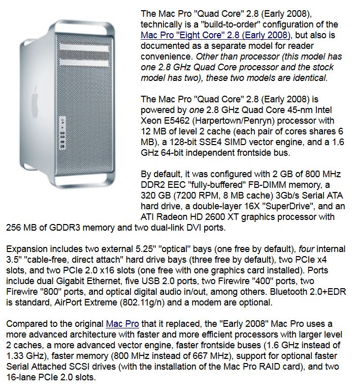

Here's my dilemma. I have a 2008 2.8 / (8) core Mac Pro, 32 ram, XT256 vid.
I just got a hold of a 2010 (4) core Mac pro, 32 ram, 1gig Raedon 5770.
I getting really confused with all these bench mark tests, but it seams to me MHZ throughput is what matters.
Can someone shed some light on the better machine, thanks.

2010 for sure. Still supported by Apple. Latest OS and firmware updates.
