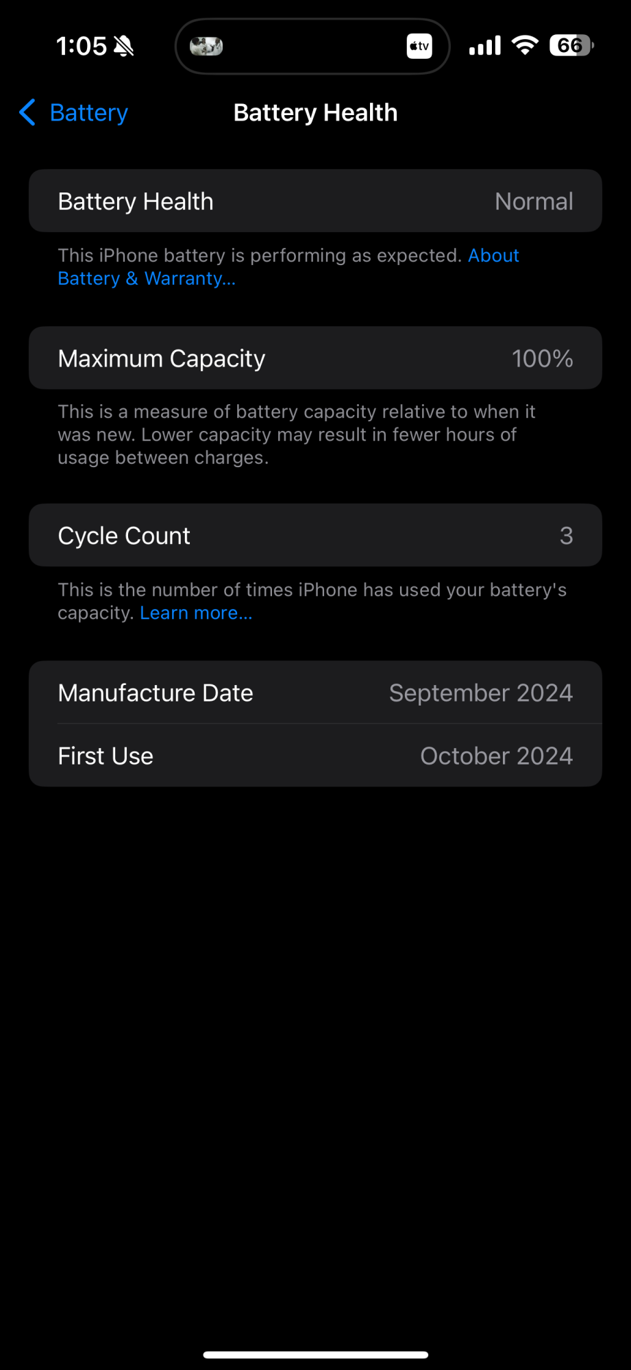

Actually, the manufacturing date is there along with first use, my manufacturing date is September 2024 and first use is October 2024.

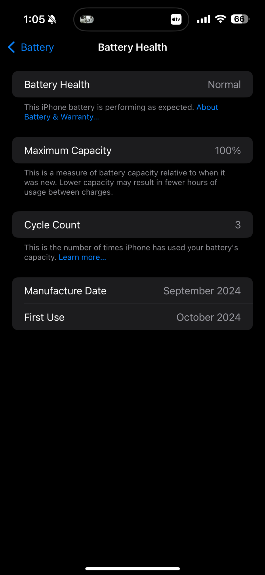

thats the battery manufacturing date actually and i have checked it with the apple team , mine shows july 2024 on the phone but my phone is manufactured august 2024 lol its probably 1month gap
