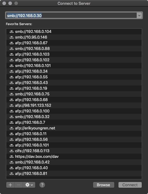

They are, but I’m wondering if my network settings aren’t preventing it from being able to actually see anything else on the network. I’d have to check; meanwhile the other two ideas posed here seem a bit easier. I’ll keep this in mind though.
You can always connect directly. Finder>Go>Connect to Server…enter credentials. Save them if you want.
I happen to have most of my IP addresses of network Macs/PCs/Devices saved and memorized Just easy to connect that way. Some of my Macs have multiple IP addresses. For instance, Youngren14 is my Intel MacPro and it has four network connections. Two ethernet, one a USB to Ethernet connector and one WiFi. Ethernet connections are 192.168.0.6 primary and 192.168.0.8 secondary. The USB connection is 192.168.0.7 and the WiFi connection is 192.168.0.78. These are all static addresses and I set them specifically for this Mac so I know which connection I am connecting to.

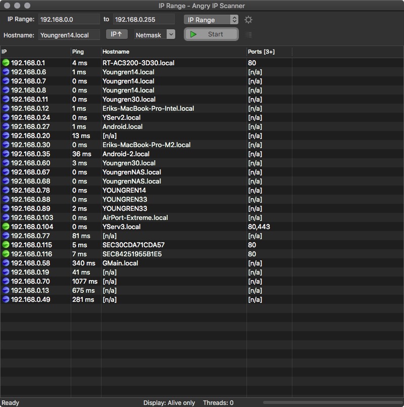

But if I don't know an IP address offhand, there's always a scanner. On my Intel Macs I use Angry IP Scanner. On my old PowerPC Macs I'd use Wake From LAN.
Below is Angry IP. You can see the Sharing names next to the IP addresses.
