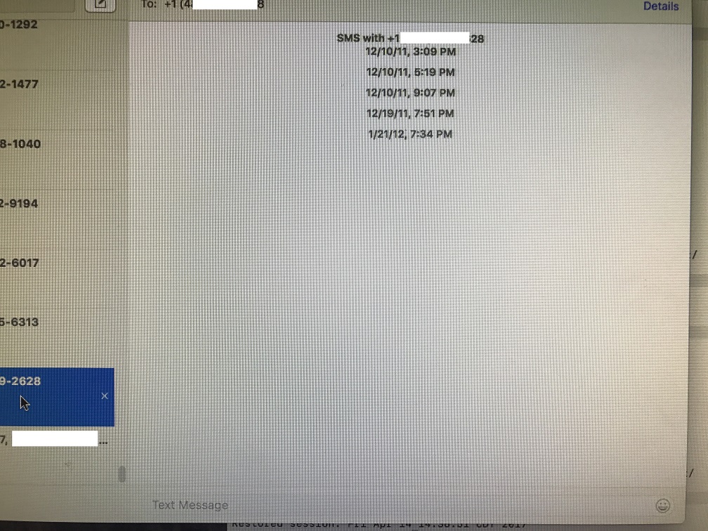

Thanks to all the previous posts as I was able to follow the steps and get this to work. However I am having an issue with some of the older messages. It appear that these did not port over properly.
  • Messages from 2013 forward appear to be okay.
  • Messages from 2011-2012 show as seen in the picture below (broken).
  • Messages from 2010-2011 are completely missing, but these messages are on my iPhone (where the backup was extracted from).
Luckily I backed out so I can start all over again from the beginning if needed.
Here is a picture of how the older messages look.
I'm sure this is some kind of a formatting thing that requires additional SQL commands to execute, I just have no idea as to what those are. Any ideas?
Thanks
