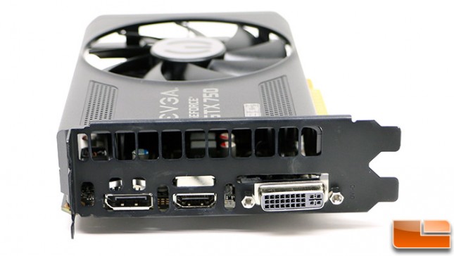

eGPUs over thunderbolt people...
https://forums.macrumors.com/threads/1815596/
For triple 1080p (in desktop enviroment) even a gtx 750 is enough, just pick one with 3 digital ports, like this EVGA
