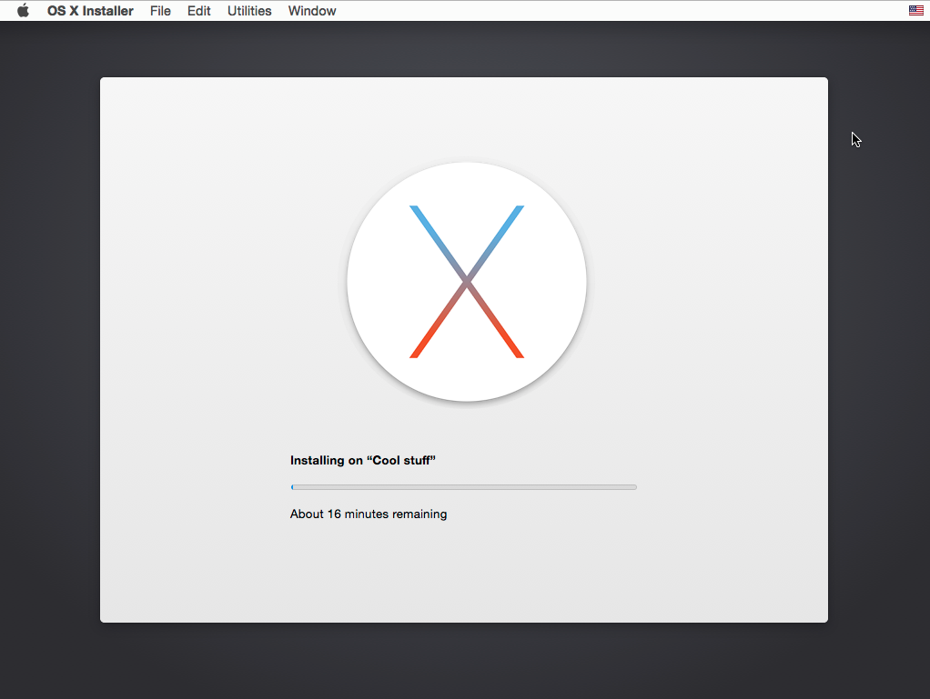

I'm having problems installing el capitan onto my ssd. I've tried using the partition method as well as using diskmaker X5 but I keep running into errors when I tried booting it up.
For both methods, I used an external drive in order to have a bootable OSX. But both methods comes out with log errors once the blue install bar hits around a quarter to half way.
My SSD is 850 EVO and my mac is mid 2012 pro. Am I missing to input something in disk utilities beforehand? I've looked and done exactly what a lot of youtube people did but I can't figure out why it won't install on my ssd?

I'm concerned that you describe the 'blue bar' ... There shouldn't be a blue bar when installing El Cap. It should either be black on white or white on grey, setup dictating.
Are you formatting the partition with GUID? And ensuring it is HFS Journaled. If you are running a DMG of the installer then that will not work. You will need to create a bootable USB installer, from the DMG, which should then complete without issue.

The blue bar is from when you first try to boot up El Capitan on your SSD (when installing) - that is where the error logs pop up. It is usually the final step in all youtube videos. (check the file I have attached)
I've formatted the partition with GUID and ensured it is HFS Journaled. That is the method I used without the use of diskmaker x5.
I created my bootable usb by first downloading el capitan from the app store, then using disk utility to format the disk etc as stated above. Then I used the terminal to type in the "code" - waited till it finished.
