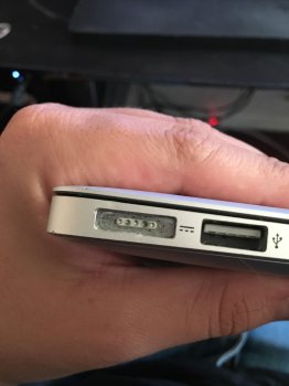

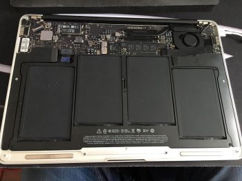

Hi,
I'm working on fixing my sisters Macbook Air A1496. I already opened it and tried a few things such as disconnecting and replugging the battery.
The issues are as following:
It wont boot (possibly due no power) It wont charge and already bought a new official charger, there is no LED light when connecting it so I'm suspecting the I/O card and magsafe port may be broken, is there a good way to test this? I was thinking of doing a 1 to 1 pin on the magsafe to charger to check if the physical connectivity is good with a multimetre.
Any tips are appreciated as I know very little about Macbooks in general, yet repairing one. I have all the nessescary tools and already opened the service lid so testing anything being suggested should be quick and easy. 🙂
Attached:
Picture of Magsafe charging port https://imgur.com/a/iulLiHK

If you get no LED at all on the magsafe connector, and tried a different power adapter (the charger!), and still no LED, then your next step is to try a magsafe board (the I/O board on the MBAir includes the Magsafe connector)
There's not much else that you can try. The I/O board is not particularly difficult to replace, probably can be done in less than 15 minutes. There's easy-to-follow steps on iFixit guides - https://www.ifixit.com/Guide/MacBook+Air+13-Inch+Mid+2013+I-O+Board+Replacement/15229
Reactions: rasjima99321
Thank you all, just ordered the new I/O board yesterday, I will keep you all posted on how this goes. Replacing it seems like an easy job 🙂
