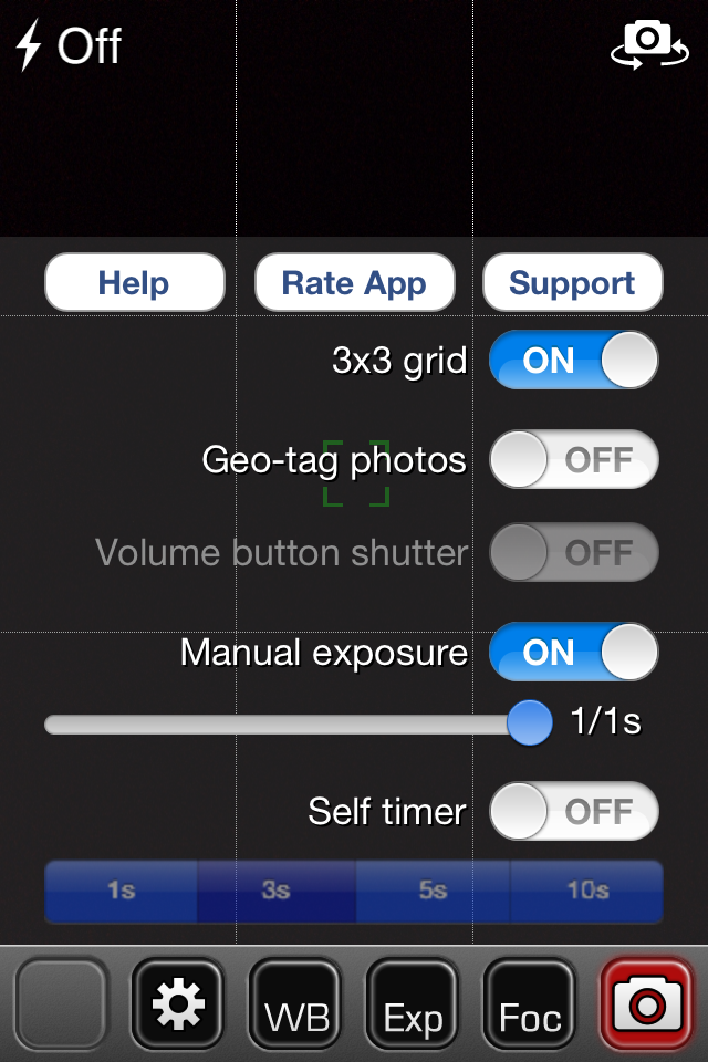

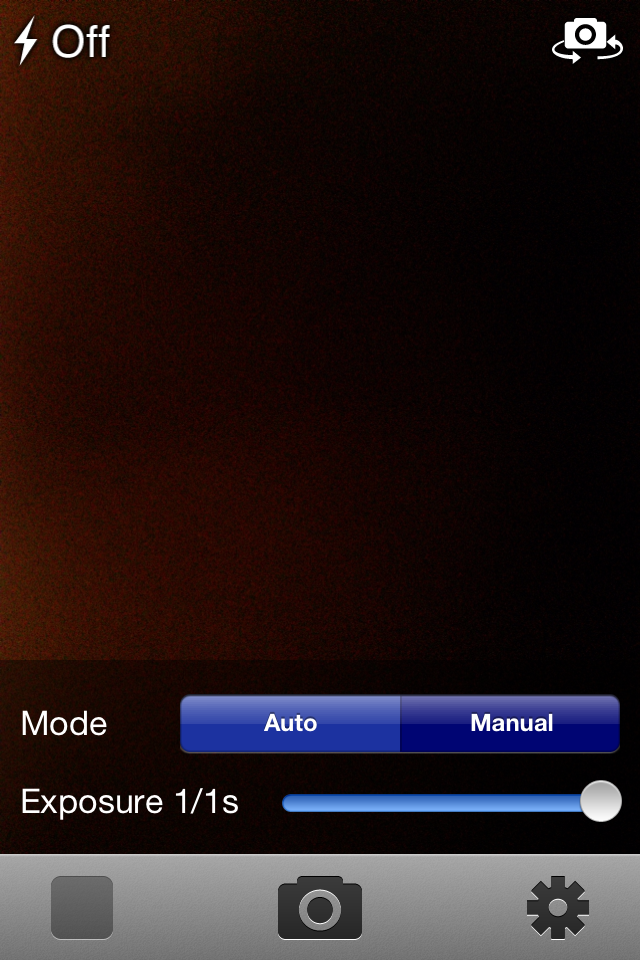

Edit: here are screenshots of my phone with each version, taken when my phone is inside its case which does not have a camera hole.
You’ll recognize v2.0 on the left, and v1.1 on the right. When I close the settings in v2.0, I see “Exp: 1/15” with the number in red (I forget what the ISO was).
As you can see in v1.1 there is actually a little bit of light inside the case, which can get picked up at 1s exposure. But v2.0 is, for some reason on my phone, not ever going longer than 1/15s shutter speed.
