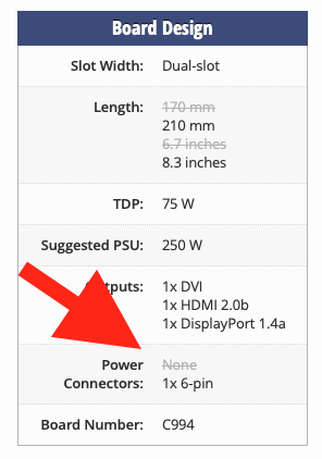

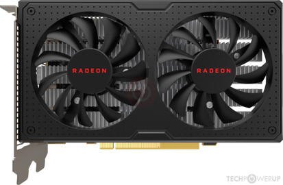

All AMD Radeon RX 560 models are listed here:

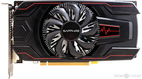

Get one like Sapphire PULSE RX 560 4 GB:

All real - there are fakes being sold - AMD Radeon RX 560 are METAL compatible and work from Mojave to Monterey, but the models without power connector have issues when running macOS, so avoid these.

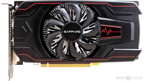

Get a Sapphire RX 560 4GB 11267-01, I have one with one of my Mac Pros, works perfectly and it's just 6-pin. This one is exactly the model I have:
This one Sapphire RX 560 OC 4GB 11267-00 also works:

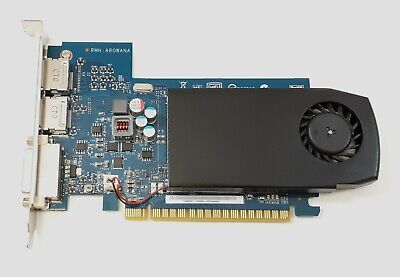

If you just want to install Mojave and your focus is audio applications only, you can get the HP GeForce GT630 2GB for € 45 and be happy, it's a slot powered UEFI card, so EnableGop works, and fully compatible with Mac Pro. Let's not forget of the best thing, no cables needed. eBay link below, no affiliation:
More info here, btw, no need to flash it anymore, now with EnableGop added to your Mac Pro BootROM, all modern UEFI GPUs that are compatible with Mac Pro have pre-boot configuration support.

So on the ebay HP card, you mentioned, I wouldn't have to flash it, it's Mac ready out of the box with the boot screen? Also, I do want to move up higher than Mojave, will this card be able to do that? I've read some of the instructions for enbleGop and boot rom, seems complicated beyond my skills. Trying to keep it easy.
If you add EnableGop yourself, yes. PC GPUs do not have pre-boot configuration support with an unmodified Mac Pro BootROM.
Native support up to Big Sur, for Monterey you will need to use OCLP to install the BigSur drivers back.
Same issue with all other supported NVIDIA GPUs, Apple completely terminated NVIDIA support with Monterey. That's why it's not a vey smart move to spend £ 239 + shipping with a NVIDIA GPU.

One HP GT 630 (684455-002 702084-001 B4J92AT) + EnableGop = perfect pre-boot configuration support up to full HD screens.
