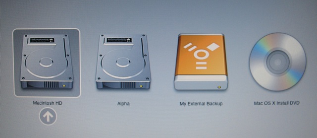

@aftermid do you seriously do not know what the BootPicker is? Really?
In the event, I decide to stay with the card I have, it sounds like the NVRAM and the BootROM will eventually fail, due to the computer's age, is this something that can be fixed after the fact?
If you are capable of replacing the SPI flash memory, requires desoldering/soldering a new a 8-pin SOIC/SOJ chip, if not, you'll need to buy a MacPro5,1 A1289 MATT card from cmizapper.com for €65.
Btw, you need the BootROM reconstructed already, since you will flash it to the MATT card after the card is connected to the backplane.
Most people buy a MATT card before it fails, but if a week or two waiting with the Mac Pro off service is not a problem for you, you can buy the MATT card after the failure.
The reason I ask is, because the Apple stores won't touch these computers, because they no longer support them and the two so called certified repair shops here are sketchy at best and swindle most of their customers, so there are not really any around here that are reliable. Don't know if you have a way of finding an actual Apple tech that's for real. Even doing the preventive NVRAM and Bootrom upkeep could be scary. Around here the computer might come out worse than it came in, they'll break it and hold your computer hostage, until you pay for the destruction they did. That's why I wonder, if I can do it myself, because the outcome might be better with nothing to lose. At least, if I break it, it didn't cost me anything.
I've sent you a PM with instructions and cost for the BootROM reconstruction process, see if is something that you can get everything required or you will need a friend/tech to get it for you.
Seriously didn't know what a BootPicker was. Being from the Windows world, I always referred to this as a selective drive boot up, which is what I imagine you mean by bootpicker. On a good note, I do solder quite well.
