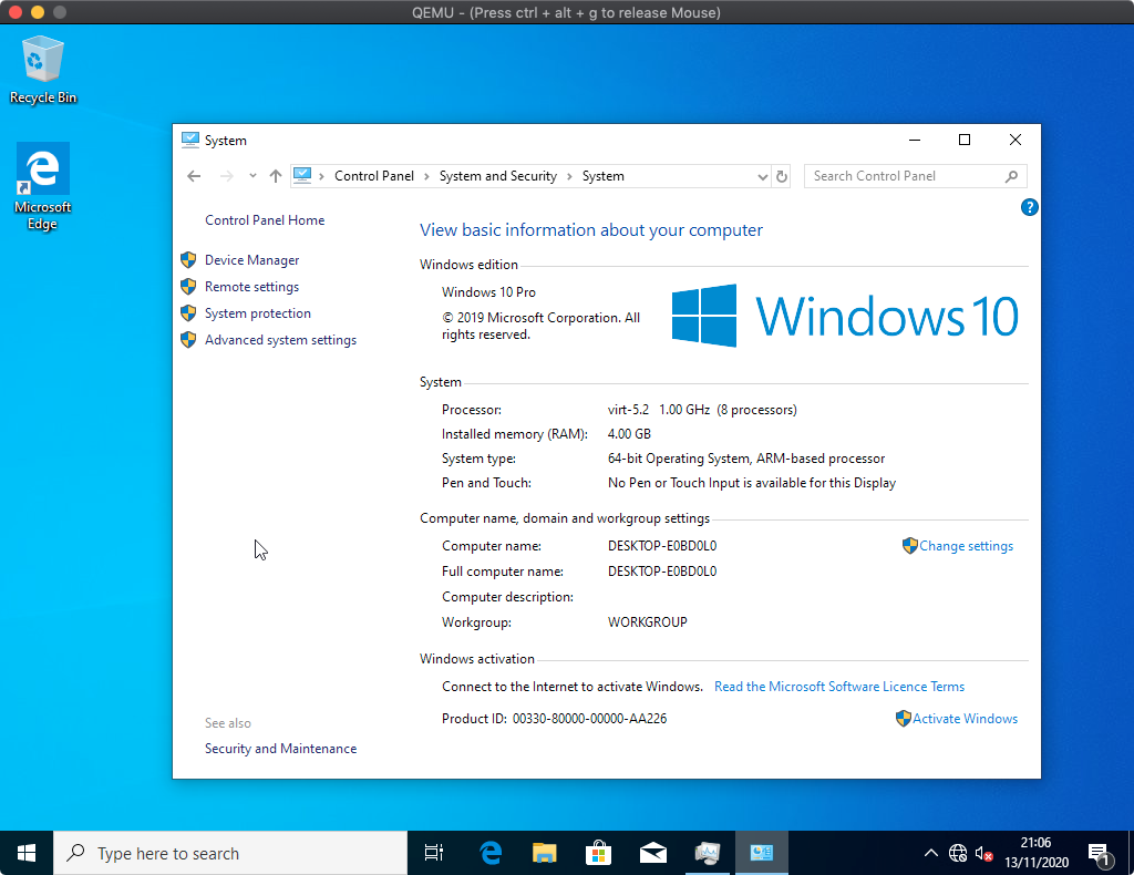

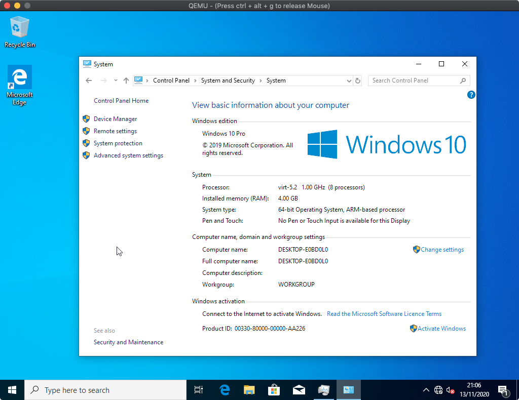

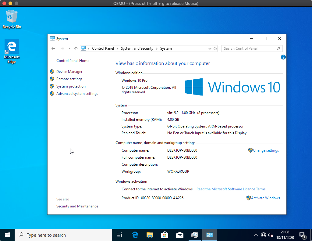

has anyone tried to compile QEMU natively for OS X-ARM64? Id love to give it a bash but I dont own/cant afford an Apple Silicon mac sadly
I know QEMU already has Apple HVF support on intel macs, so it would be very interesting to see if that worked on Apple Silicon macs :)
especially as you can already boot windows for ARM in QEMU in emulation mode on an intel mac, so if you can make QEMU work via HVF on an Apple silicon mac it might actually be possible to run windows on an Apple Silicon mac at a half decent speed :)
It compiles but immediately crashes with a memory allocation error. I’ll check in on the Qemu patches posted here to see if it fixes the problem for me.
I use MacPorts to get most of the required tools without any real problems. I’ve been working on getting a decent Unix dev environment for days so don’t exactly remember if I had to build something from source or not.
Qemu doesn’t build with MacPorts so I grabbed the source from git and was able to do a ./configure;make successfully. I don’t know what branch the posted patches are from but I’ll look into it more later this afternoon.
Yay! I got it all working and it's compiling an ARM build root image for the raspberry pi system I'm working on. This is super exciting, I don't even need a more capable virtual machine, just CLI linux being able to build stuff!
