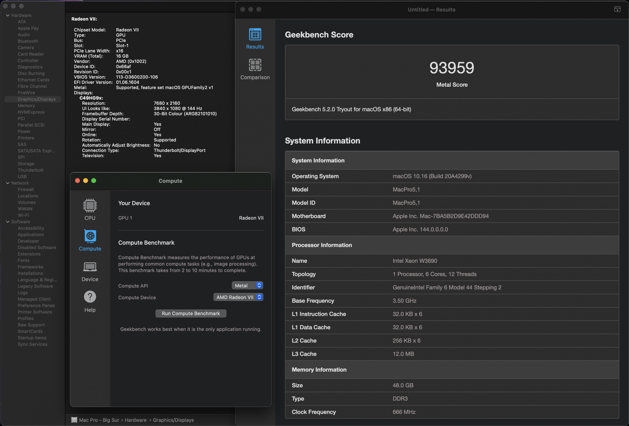

h9826790
macrumors P6
Apr 3, 2014
16,656
8,587
Hong Kong
Does text render better/worse with an ultrawide? I heard font smoothing was removed from the settings.
Has anyone also tested HiDPI mode for 1080/1440 displays?
Not sure if font smoothing removed or not. My personal feeling is that Big Sur's system font is clearer on my 3840x1080 ultrawide monitor. But I believe that's due to font change, not rendering method changed.
e.g. My GB5 result use the same font regardless OS version. And I can't see any difference in the GB result's font clarity.
