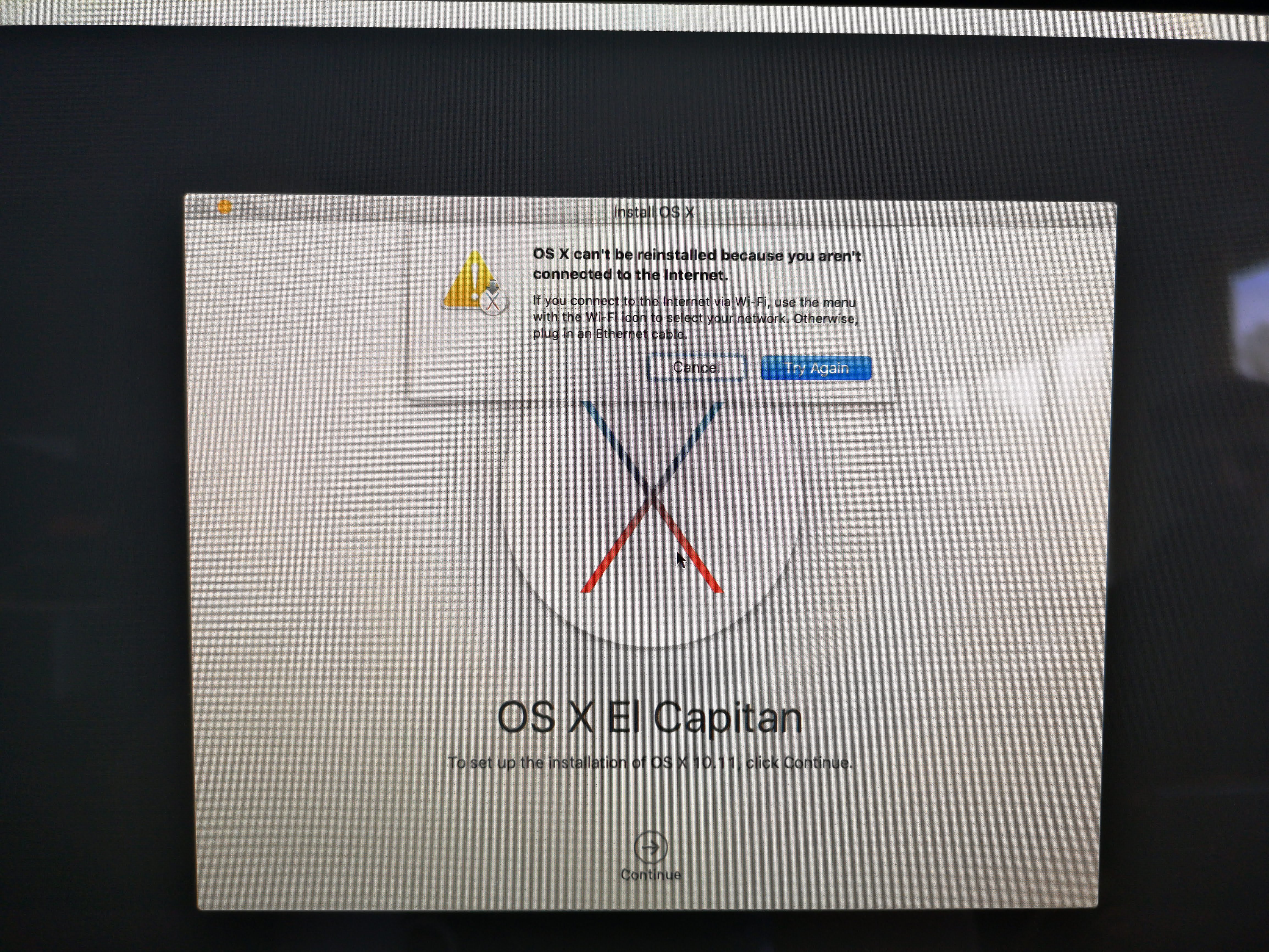

Hi there,

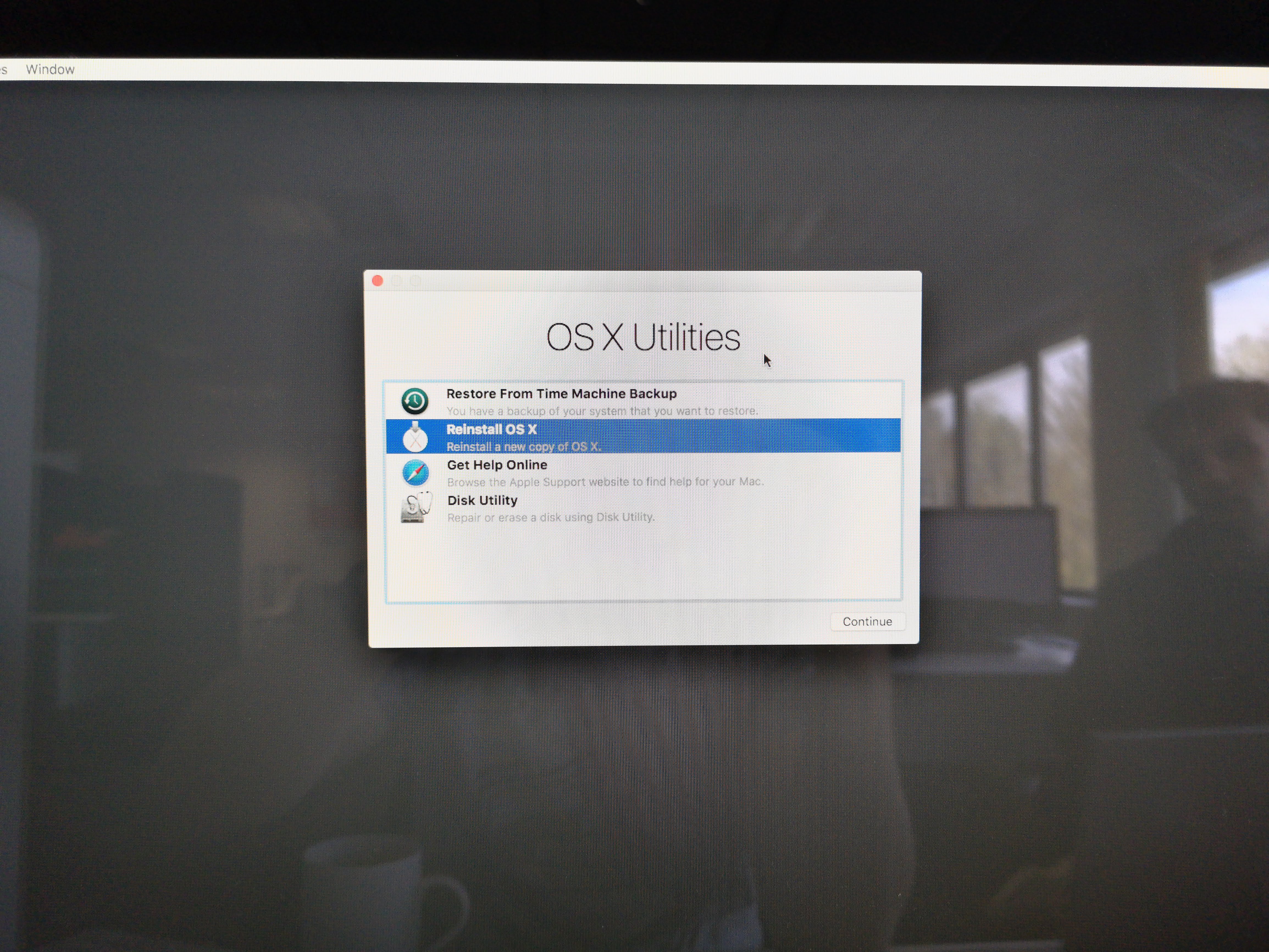

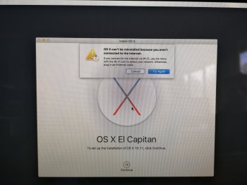

I'm having an issue with a MAC that we use, it has recently been wiped as this was going to be issued to a new member of staff. When I try and reinstall the software, it comes up with the error "OX X can't be reinstalled because you aren't connected to the internet".

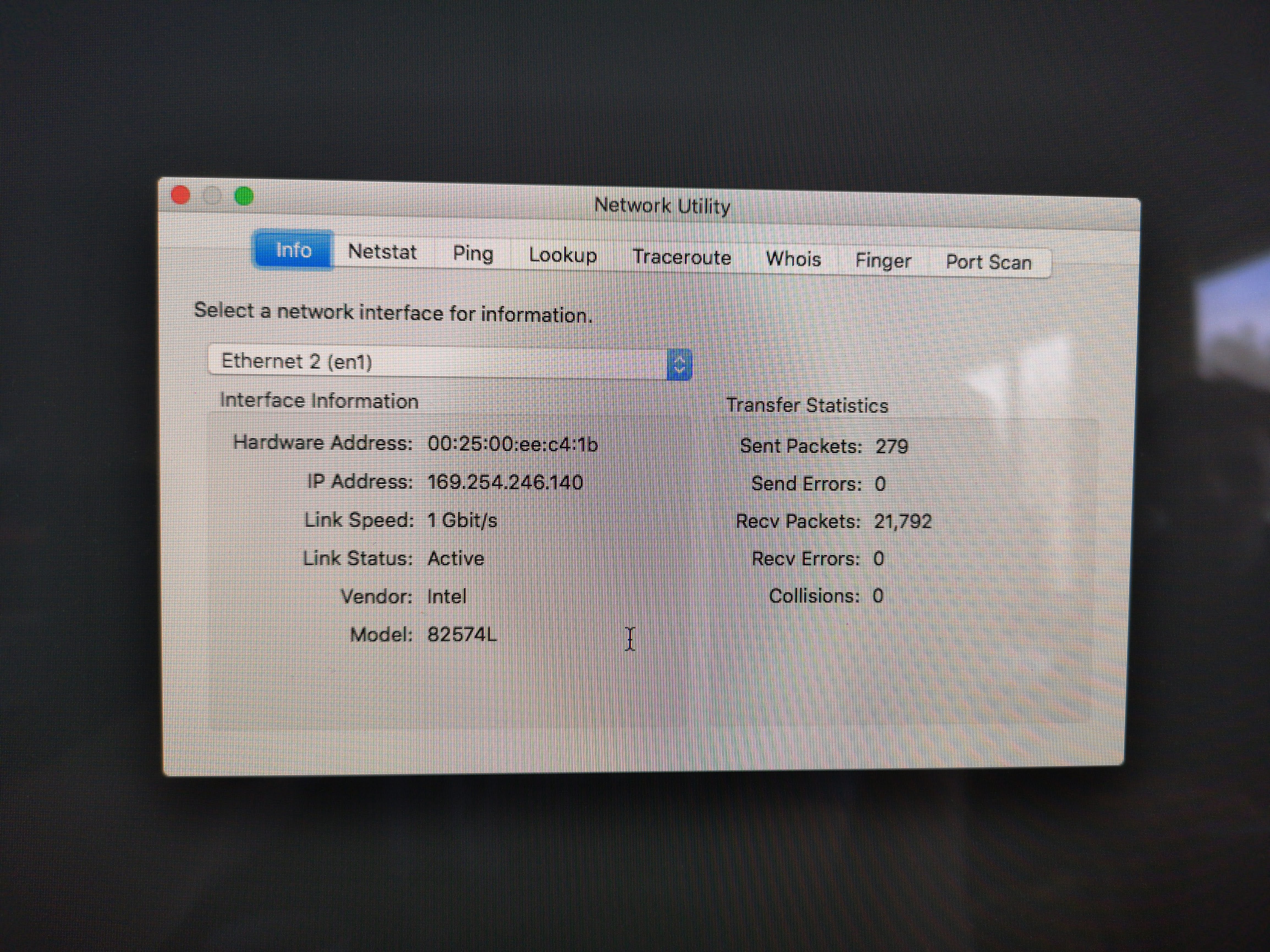

I have gone onto network utility and checked to see what the issued is, there is data coming into the network port but the PC has been given an Apipa address. There are no restrictions on the network which is stopping this as other devices can connect through that port fine.
Any ideas please?

The OS of the MAC is X El Capitan
Was manufactured in 2009
Not sure on what os it had on originally as it was wiped before it got to me.
There is no proprietary software on the MAC as everything has been wiped.
We only have one other MAC and that is running macOS Mojave 10.14.3...
Cheers

I have plugged a network cable directly from the switch to the Mac in both of the network ports and the issue still occurs.
This network port has been tested and works fine with the other Mac and every other devices I have tested.
There is no Wi-Fi card in the MAC to support this.
I have tried using a USB Wi-Fi dongle but this does not pick up on the Network Utility
