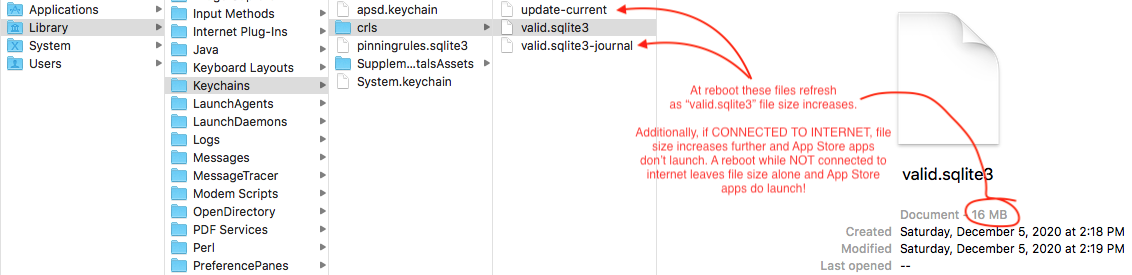

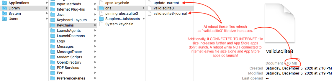

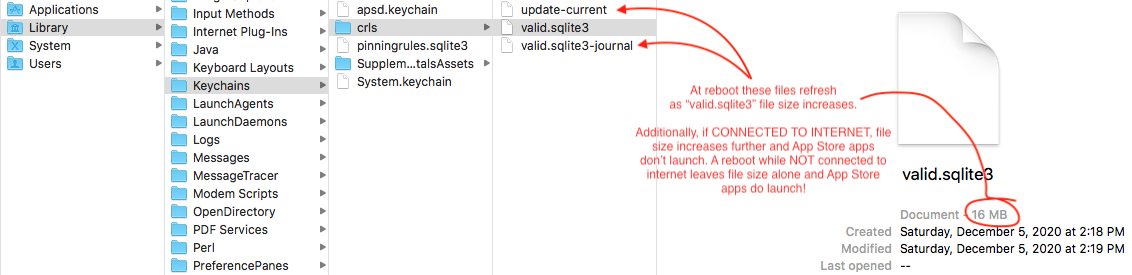

It definitely works until restart. At reboot you see the OS refresh files “update-current” and “valid.sqlite3-journal”. Then only “valid.sqlite3” remains, though its file size has increased and App Store apps no longer launch. Trashing the file again lets the apps run. So this is a temp workaround but at least App Store apps can launch.
However, when rebooting with no internet connection the file size of “valid.sqlite3” remains as it was and App Store apps DO launch. Apparently a connection is being made to Apple and data is downloaded which alters “valid.sqlite3” and causes the problem.
