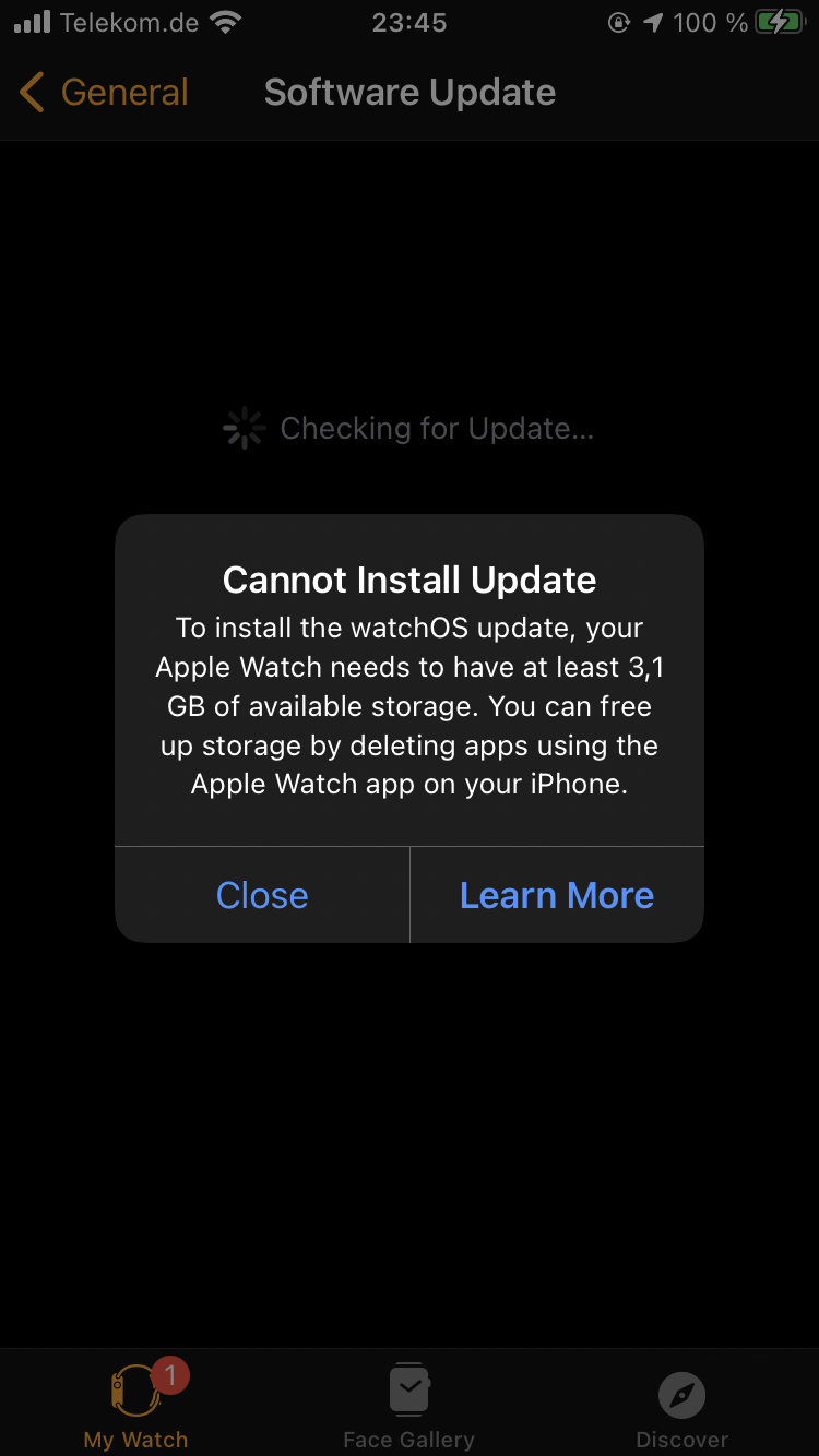

watchOS 7 came out today but I’m unable to update my watch because it has no free space.
The thing is, I have no apps installed and going to the storage usage in settings shows that there is almost no space taken by anything on the watch. So I can’t free any space and I can’t update.
Was a common problem with betas, looks like they didn't fix for GM.
Unfortunately you'll just have to reset the watch and pair again (I would avoid installing any apps during pairing).
I have this same problem and even unpairing and loading as new does not clear enough space. By manually deleting apps from the watch itself I was able to get it to 3 GB available but the update needed 3.1 and I could not free up enough. Guess we’ll need to wait for 7.1.
I uninstalled around 10 or so apps which hardly freed up any space. Then restarted the Watch just because and free space went up from 2.7 GB to 3.3 GB.

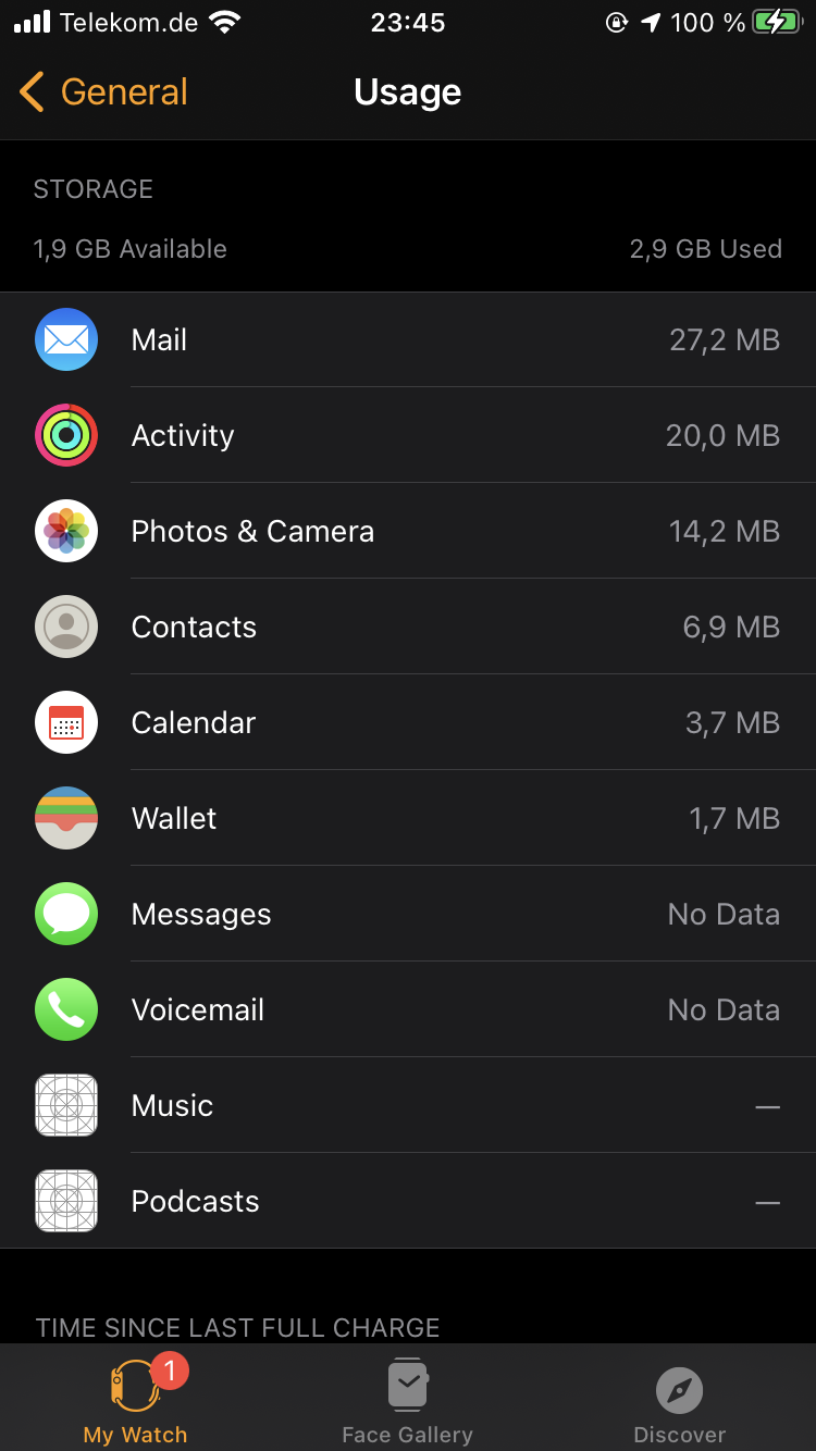

I tried restarting my watch and the free space did indeed go from 1.9 to 2.7 GB but I still can’t update.
Reset the device. I did and restored from backup it it gave me 4.1GB out of 4.7. I was at 2.8 so it looks like logs.

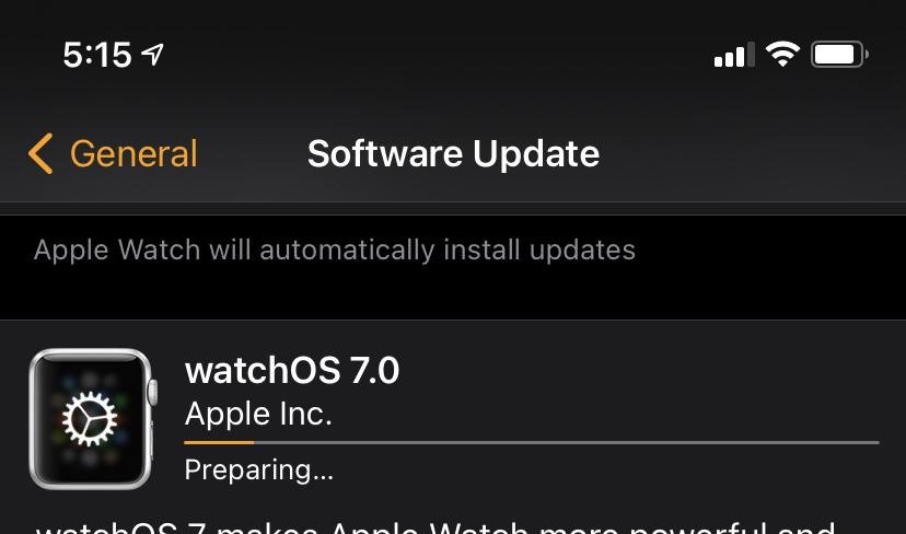

Right now I’m still waiting for it to update. Still says preparing.

Guys, I think I found the answer: delete some watch faces. Those seem to take up a good deal of space. How many do you need anyway? I got from 2.9GB free up to 3.2GB free with 3 watch faces left.

I have the exact same problem. I tried deleting all apps and removing all music. Still no luck. I can't get the free storage above 2.9GB, but it seems 3.1GB is needed to run the watchOS 7 upgrade.

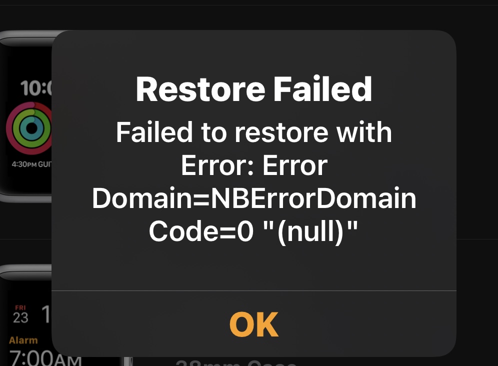

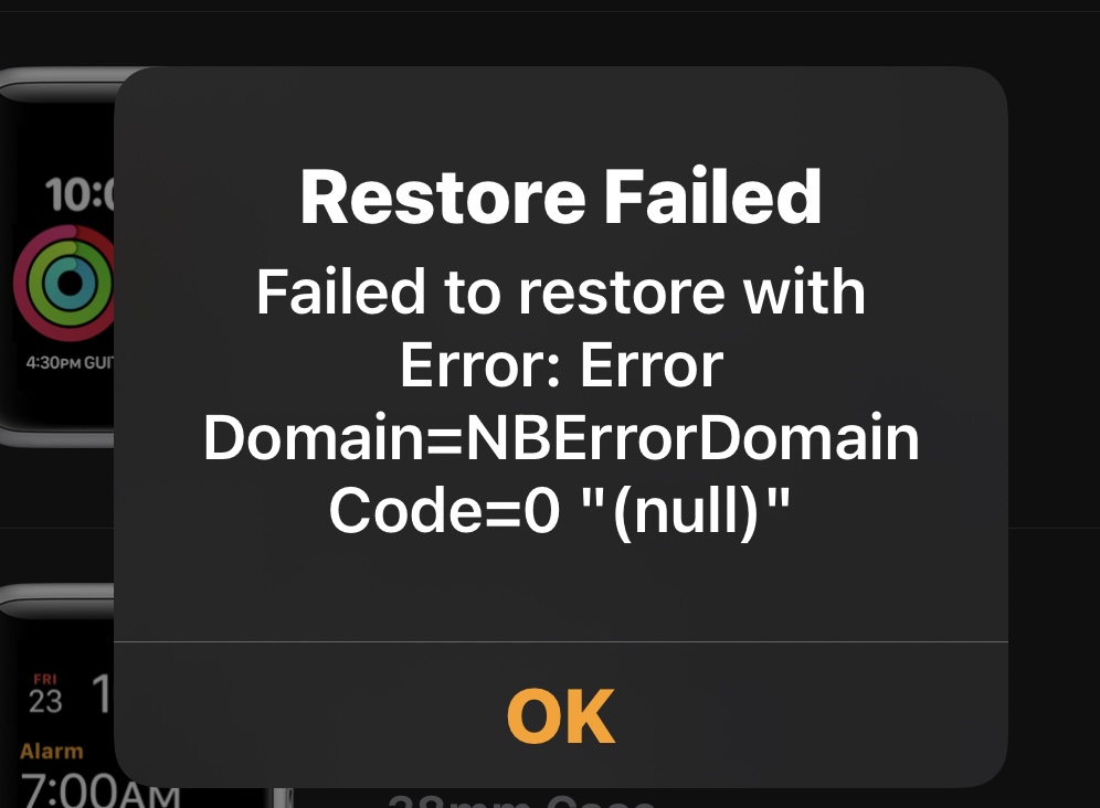

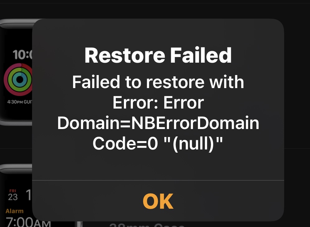

The problem is mentioned in the release notes. However, after a clean install of 7, it gave an error message when I tried to restore from backups. All my Watch backups were unusable.
edit: Reported as a bug, btw

Remove any watch faces you aren't using and restart the watch. Mine went from 1.9GB free to 3.4GB free by doing this. Upgraded fine after that.
