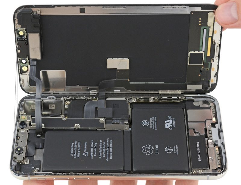

iPhone X internal image via iFixit

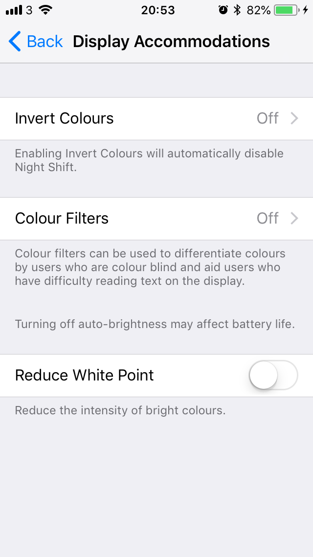

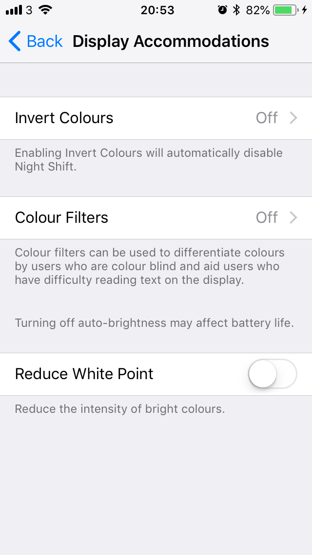

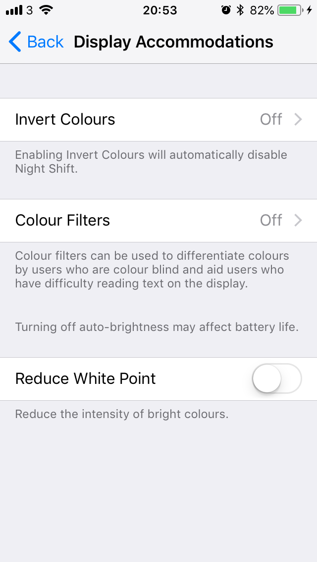

Well, I broke my iPhone SE screen a couple of days ago and ordered a new screen from iFixit. The first one I had an issue with the light sensor. I complained them and they sent me a second replacement. And guess what? The second one also didn't work. I thought maybe the connector has some issue... and... nope, I took out the original flex cable and glued it to my new screen and the light sensor started to work again.
I went to Settings - General - Display Accommodations (uploaded a screenshot) and iOS have actually disabled the light sensor when I connect both of my 3rd party flex cable which I have it around here... The slider disappeared.
I know the article states iPhone 8, but it's funny that I have exactly the same issue with my iPhone SE...
