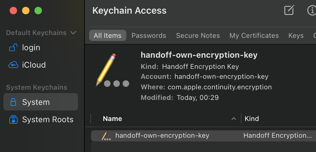

This method worked for me! Just remember to switch to System Keychain as shown on the screenshot below. Otherwise, you will not be able to delete the key even in the Safe mode! The default was iCloud for me.
Funny thing that I noticed - com.apple.coreservices.useractivityd.plist is updated every time I copy something on other devices. So, if your file is not updated or it does not contain kLocalPasteboardBlobName and kRemotePasteboardBlobName, that's a red flag for you!
