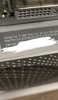

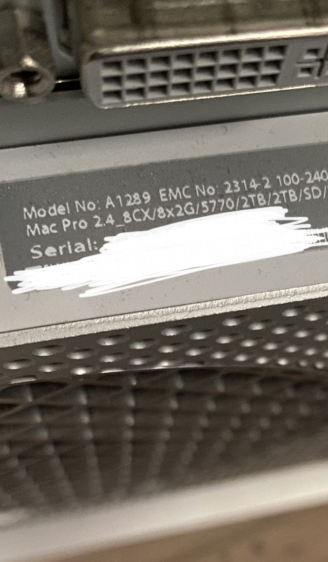

Attached a photo of my Mac Pro model.

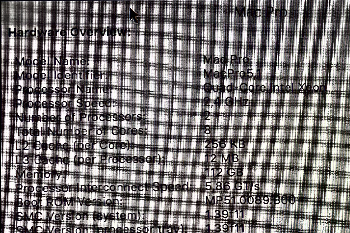

The safest way to identify your MP if it's a 4,1 or a 5,1 is by looking at:
about this Mac> system information , and check to SMC numbers:
1.39f5 = 4,1
1.39f11 = 5,1
Here is a photo of the system report:

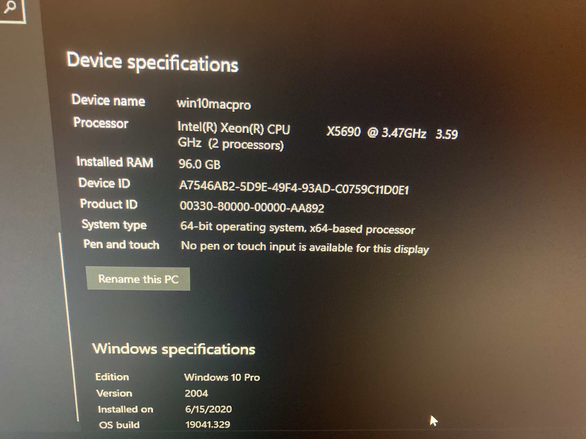

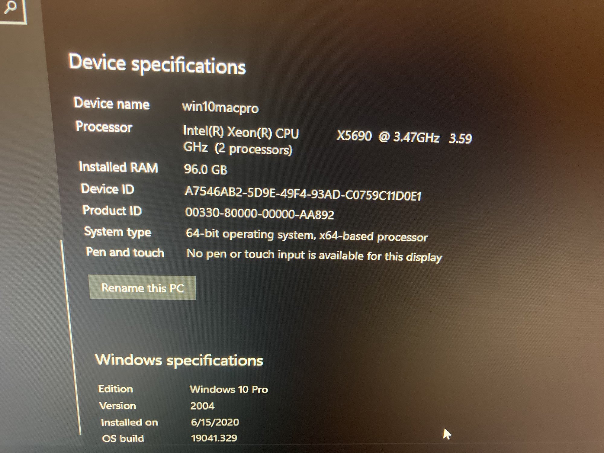

My 5,1 Has it’s lids on, works perfectly, even in windows 10....legacy.

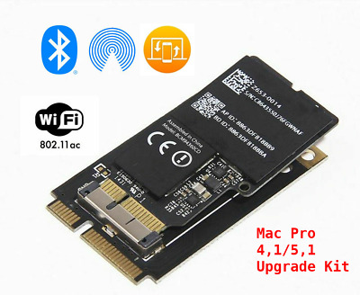

Any idea about upgrading the wifi and bluetooth to AC and BT4?
I used this complete kit. Many offer similar. I liked this one having Bluetooth 4,2 .
Works perfectly.
You need, the WiFi card, and adapter card, antenna extension wire, and an Bluetooth signal wire. If not buying a complete kit.
