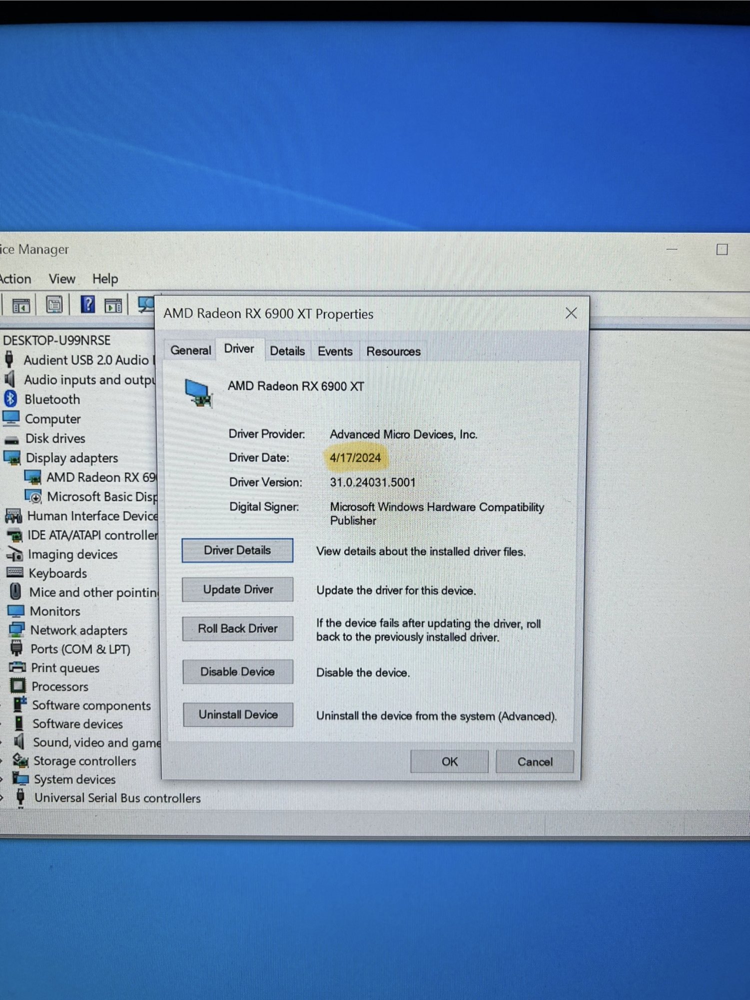

I just went through this. Same problem of getting any of the latest driver downloads from AMD to recognize my 6900XT.
A partial solution:
  1. Download the driver for the 6900XT from AMD.
  2. Go through the install process and let it fail. The “Oops…” message.
  3. Open Device Manager and right click on the 6900XT under Display Adapters.
  4. Select “Update driver” and “Browse my computer for drivers”
  5. Browse to the AMD directory, usually C:\AMD, and check the box for ”Include subfolders”
  6. Click next and let it install the new drivers.
After, the latest driver is installed. See attached.
It is a partial solution because the auto-detect feature of the AMD installer still fails to recognize the 6900XT. Guessing it is some registry entry somewhere that BootCamp fails to set or name properly. Pure speculation on my part, tho. Would love to see a more complete solution if someone comes up with it.
Reactions: t3nchu
