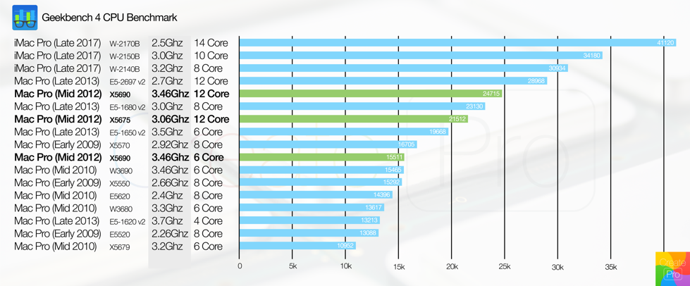

According to this 24k multi-core score is normal for 2x X5690:
https://create.pro/blog/imac-pro-vs-mac-pro-series-processor-storage-performance/
Yet I still wonder what is preventing you from getting 27k on multi-core like the geekbench result that tsialex posted. If you did the firmware update then you should have the patch he was referring to.
