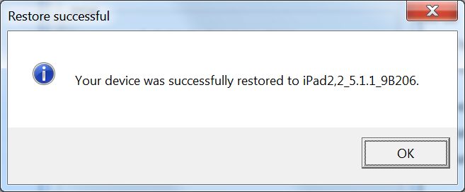

Thank you all for the help. My device has been upgraded to 5.1.1 successfully.

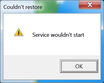

  • The program pops up various messages indicating many things it does. iPad is restarted. A dialog window comes up saying "Couldn't restore" and "Service wouldn't start", with no error code. redsn0w and iTunes consider iPad not connected.
  • attachment.php
  • Long hold Sleep and Home to turn off iPad. Plug it in, iTunes finds iPad in recovery mode.
  • Try "Exit Recovery" feature of TinyUmbrella, redsn0w and RecBoot. None works. The device remains in recovery mode.
  • Search internet and find other people succeeded by retrying multiple times after the same error (Couldn't restore, Service wouldn't start).

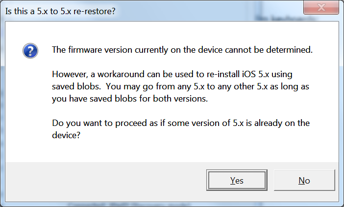

  • Redo the restoring process and disregard its preference for the device being in normal mode. It pops up a message box asking "Is this a 5.x to 5.x re-restore?":
  • attachment.php
  • Press No, and follow program's instructions. When it comes to choosing blobs, choose Local. (This attempt succeeds. But again I'm not sure if it's the reason.)
  • Wait for program to progress. There are more messages and more iPad restarts.
  • attachment.php
