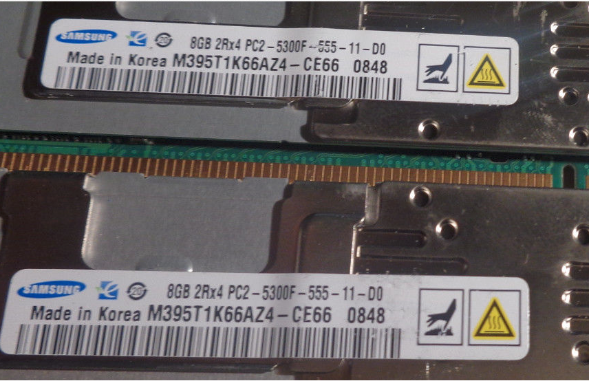

Do you think the below would work in the Mac Pro? I am looking to install two of these, to replace my 2x1GB sticks.
Certainly.
What is more important is that they are all the same bus speed. Mixing them will force the group on the memory card to run at the lowest speed. So if you mix 800MHz and 667MHz DIMMs, everything runs at 667MHz.

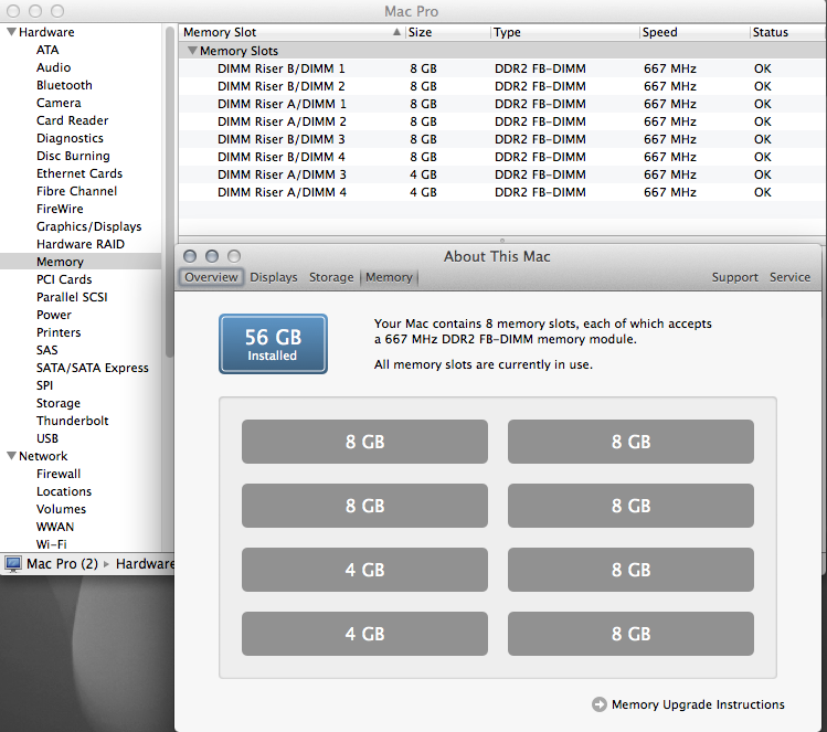

There are no faster MHz FB-DIMMs than the 800MHz ones that you have. Why do you think it matters? A good upgrade for a 2008 Mac Pro 3,1 is to buy 32GB (8x4GB) used 667MHz FB-DIMMs pulled from a Dell or HP Xeon server. They are really cheap & the slightly slower RAM only operates 4% slower in benchmarks & in real life no difference will be seen
