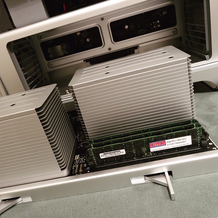

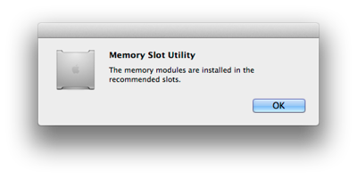

My order from DMS arrived today.
Installed 6 x 8GB for a total of 48GB DDR3-1333 (PC3-10600) Registered ECC Memory.
And did a reboot...
Good to go!
