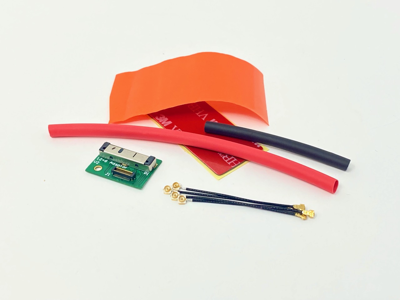

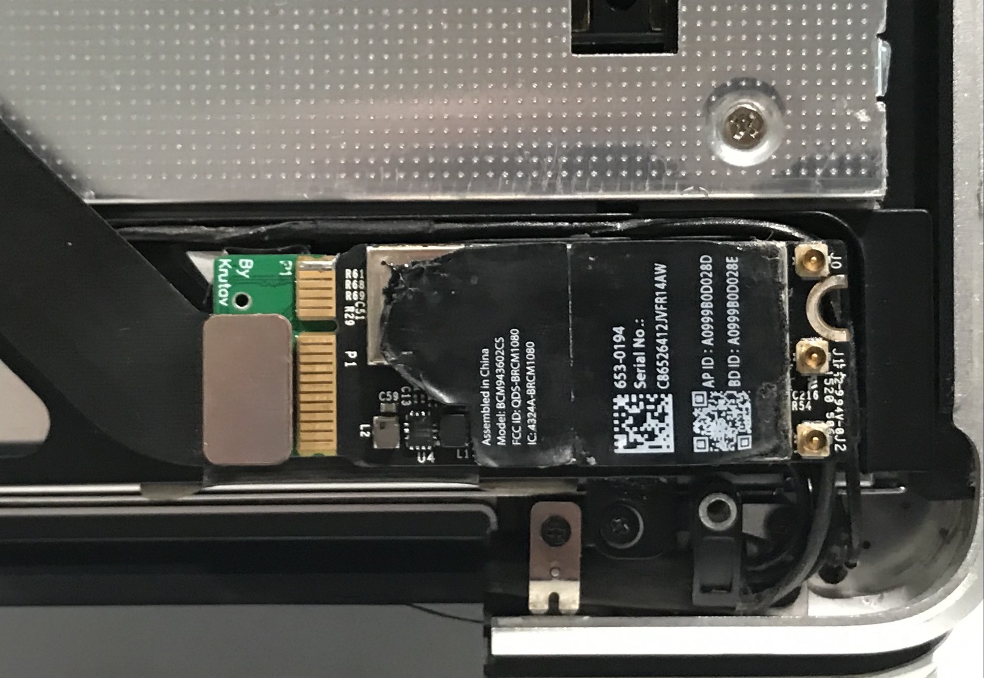

Just ordered my adapter for $2 and it works great! Soldered it up and taped it down and now I can use BT4.2 and WiFi AC on a 2011 MacBook. Files and instructions are on GitHub if you want to try it out.
I can't seem to find the instructions for the soldering connections on the GitHub. I probably just missed something but is it by chance under a different file type?
The instructions should be under the fabrication files release and would detail how you can put it together. If it’s not there, let me know and I can probably rewrite and add it back.

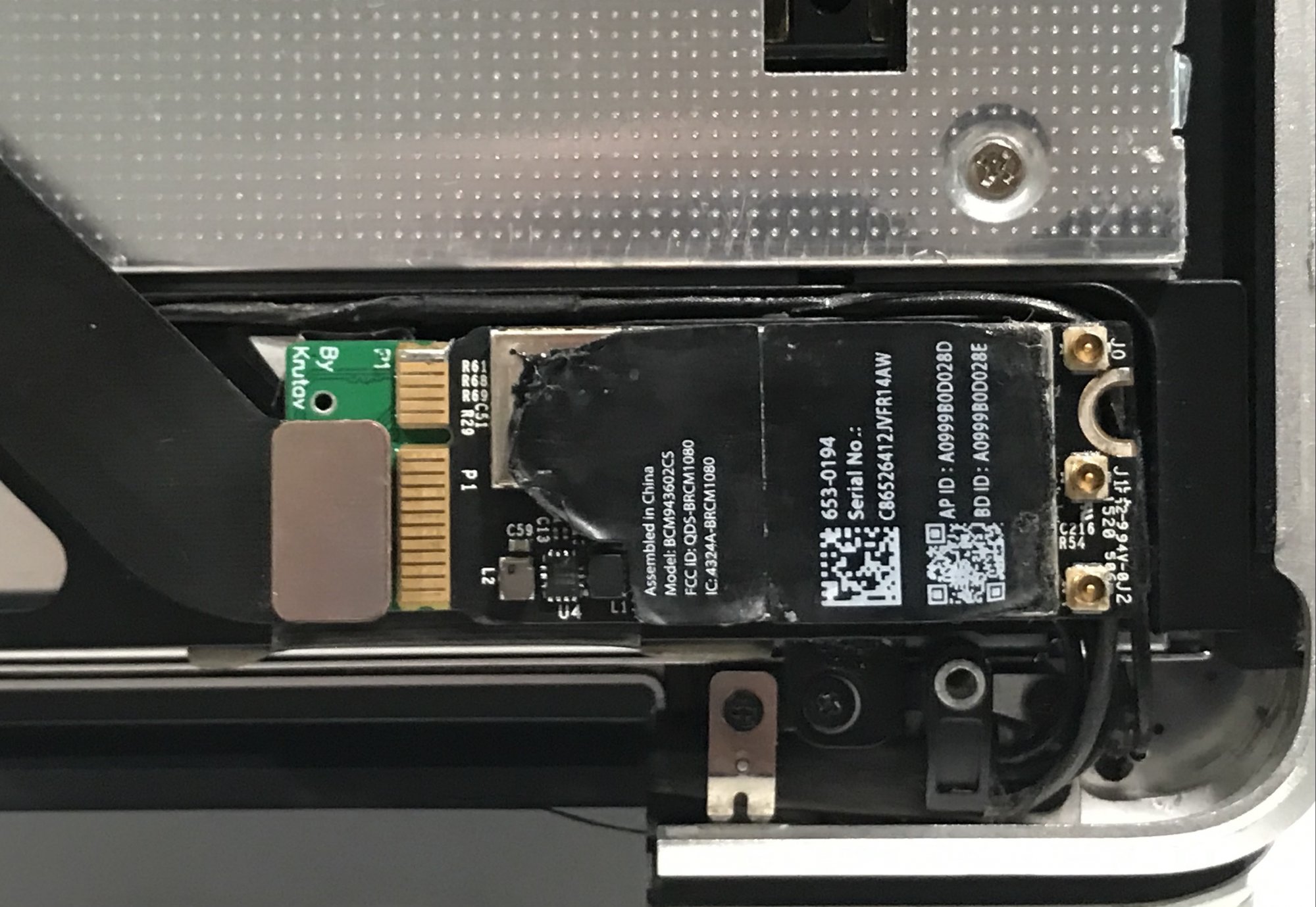

There’s two ways of going about it, one is soldering the wireless card to the adapter PCB and another method is to apply even solder to the adapter PCB and tape the wireless card to it. Both methods work, with the latter being easier if you lack the necessary tools or experience.
The flex cable connector can be soldered on via heat gun or soldering iron. It’s recommended to put the connector on last if you’re using a heat gun to solder the wireless card on, as that will melt the flex cable connector.

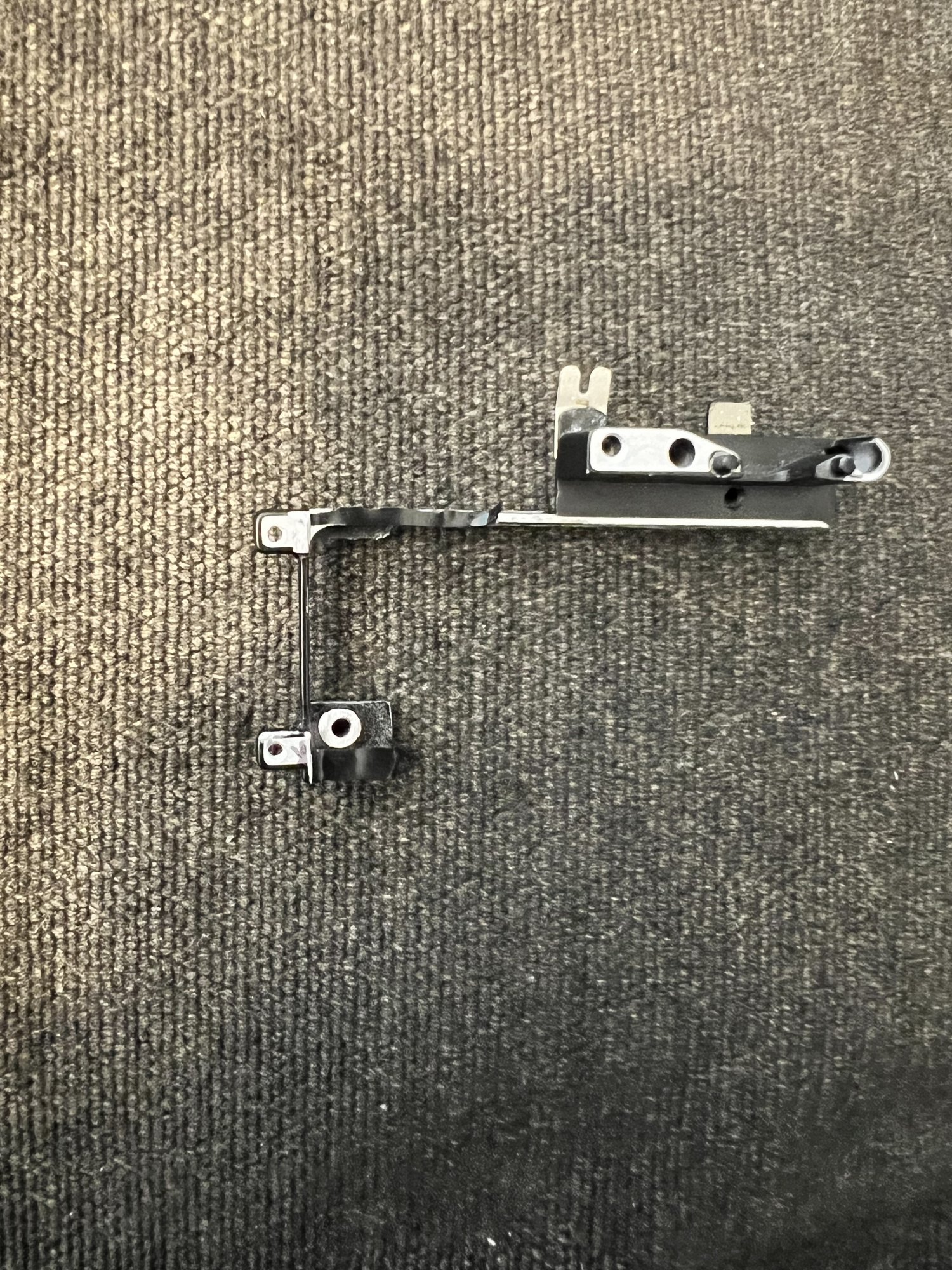

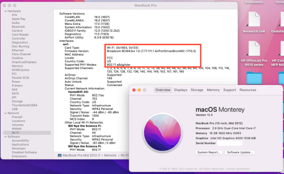

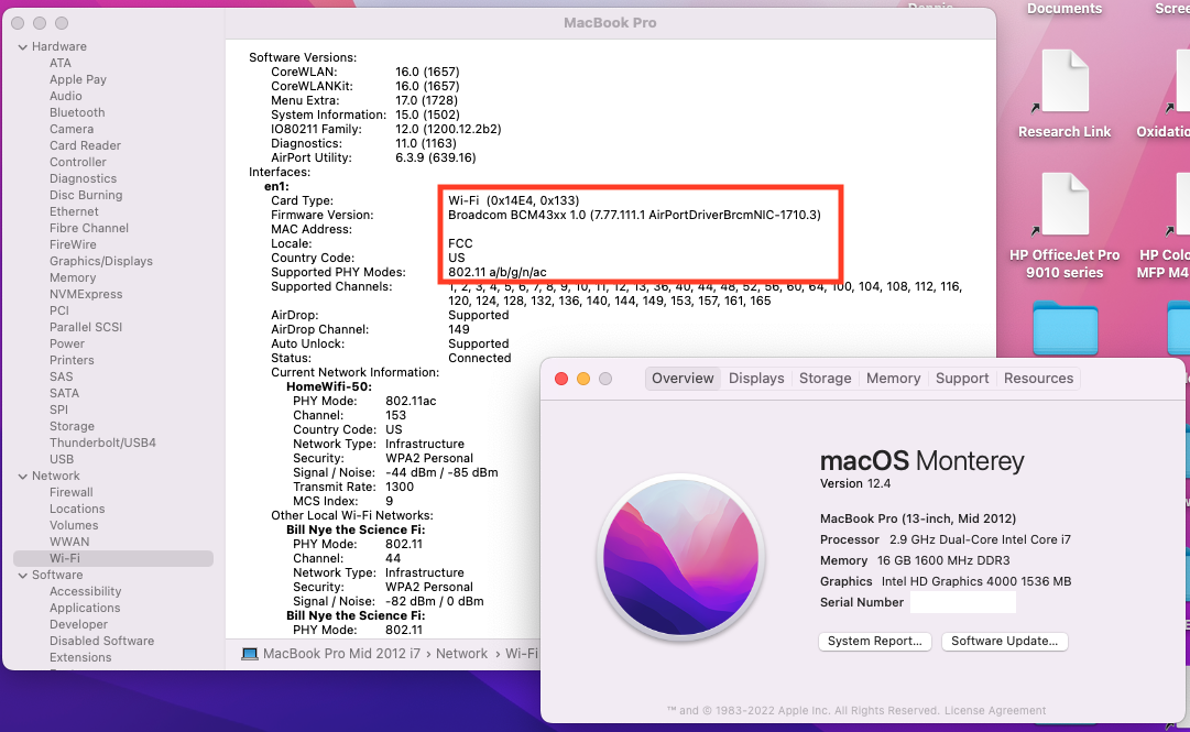

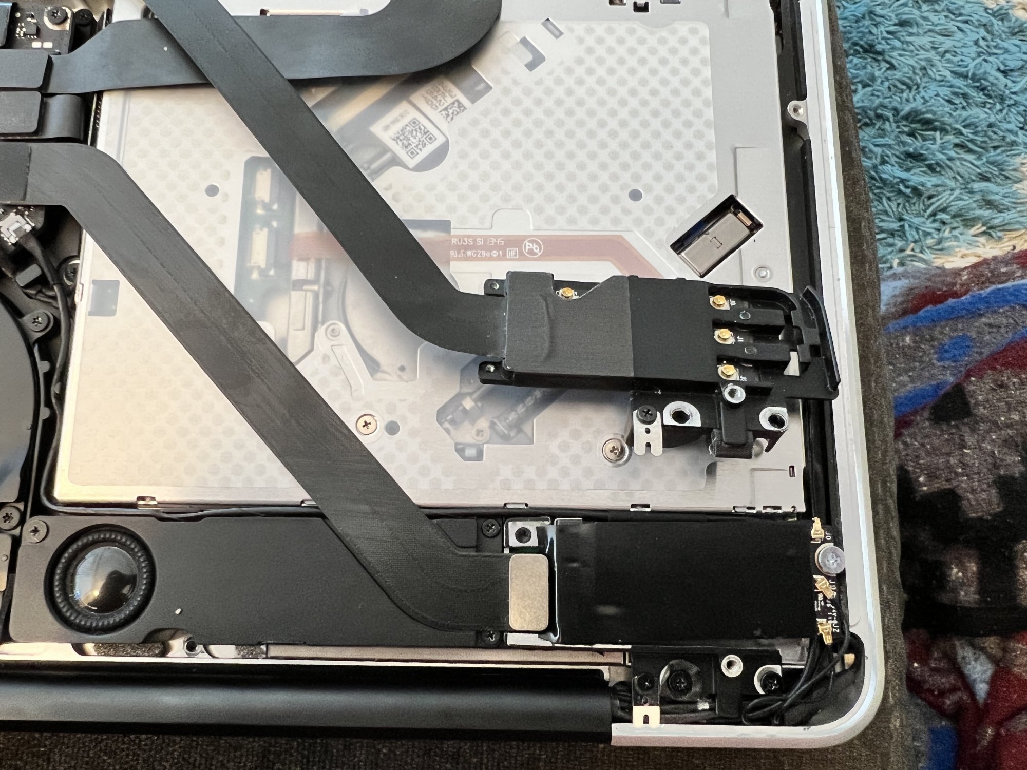

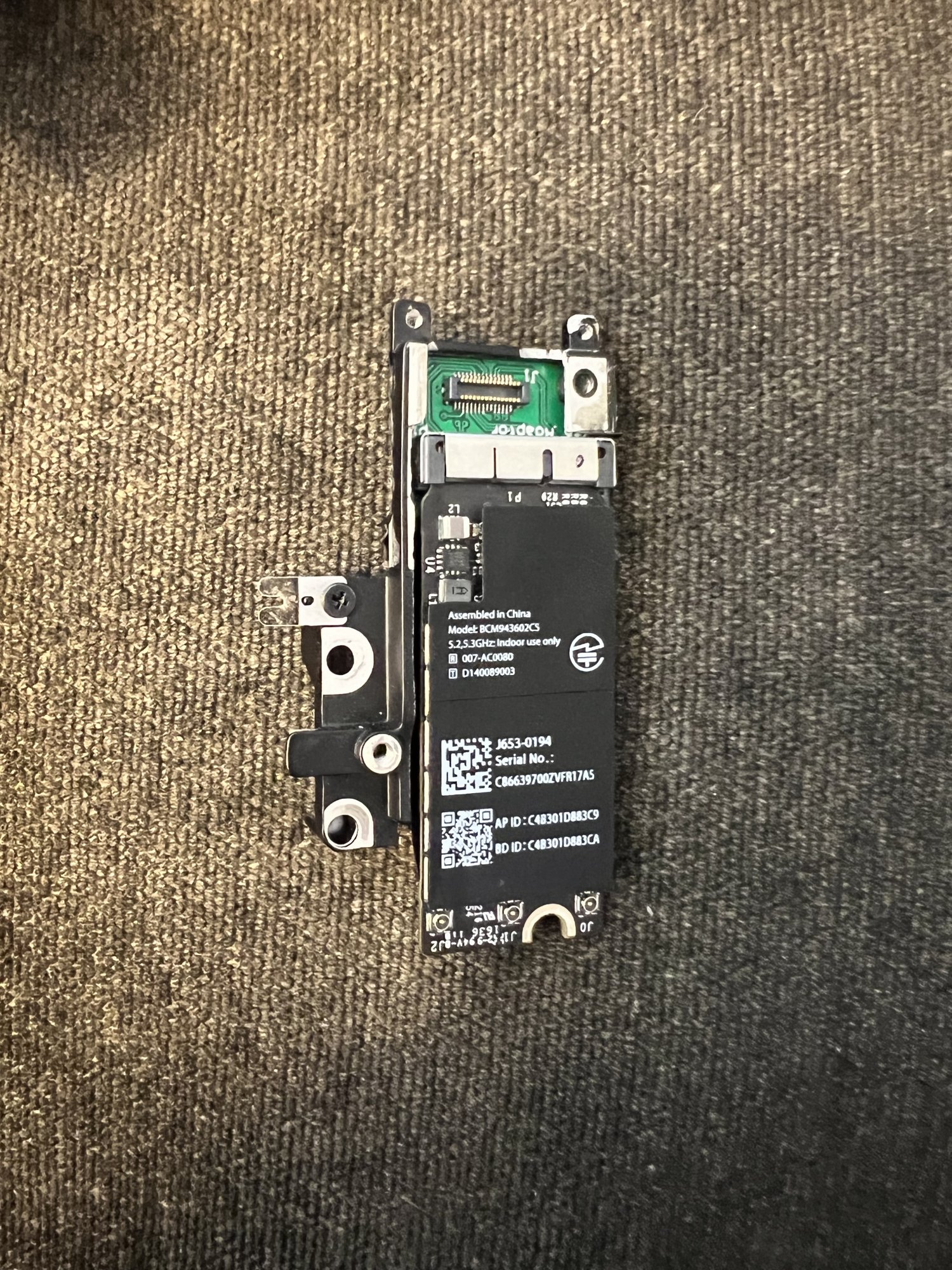

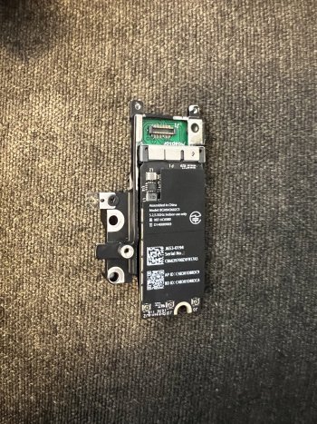

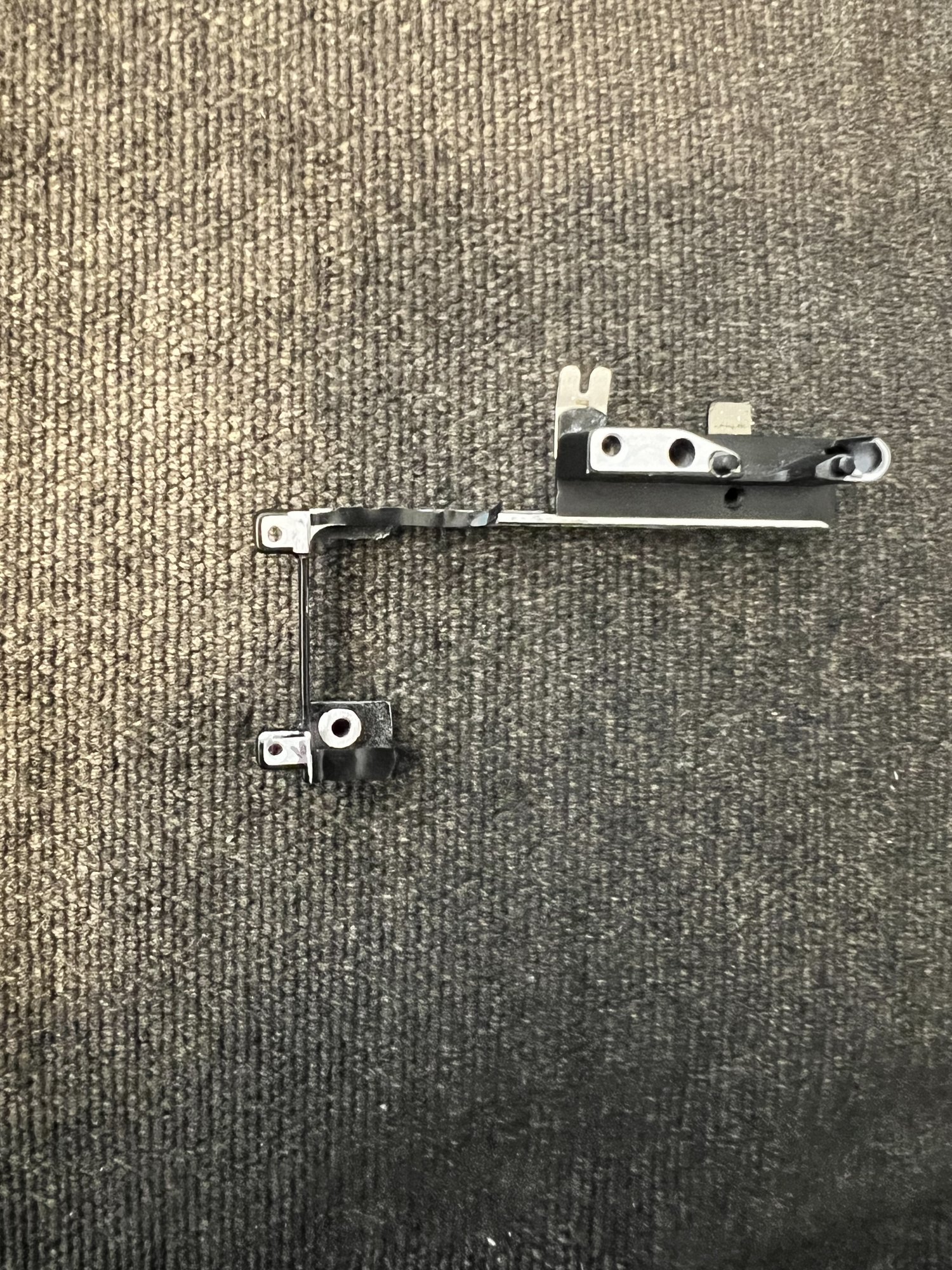

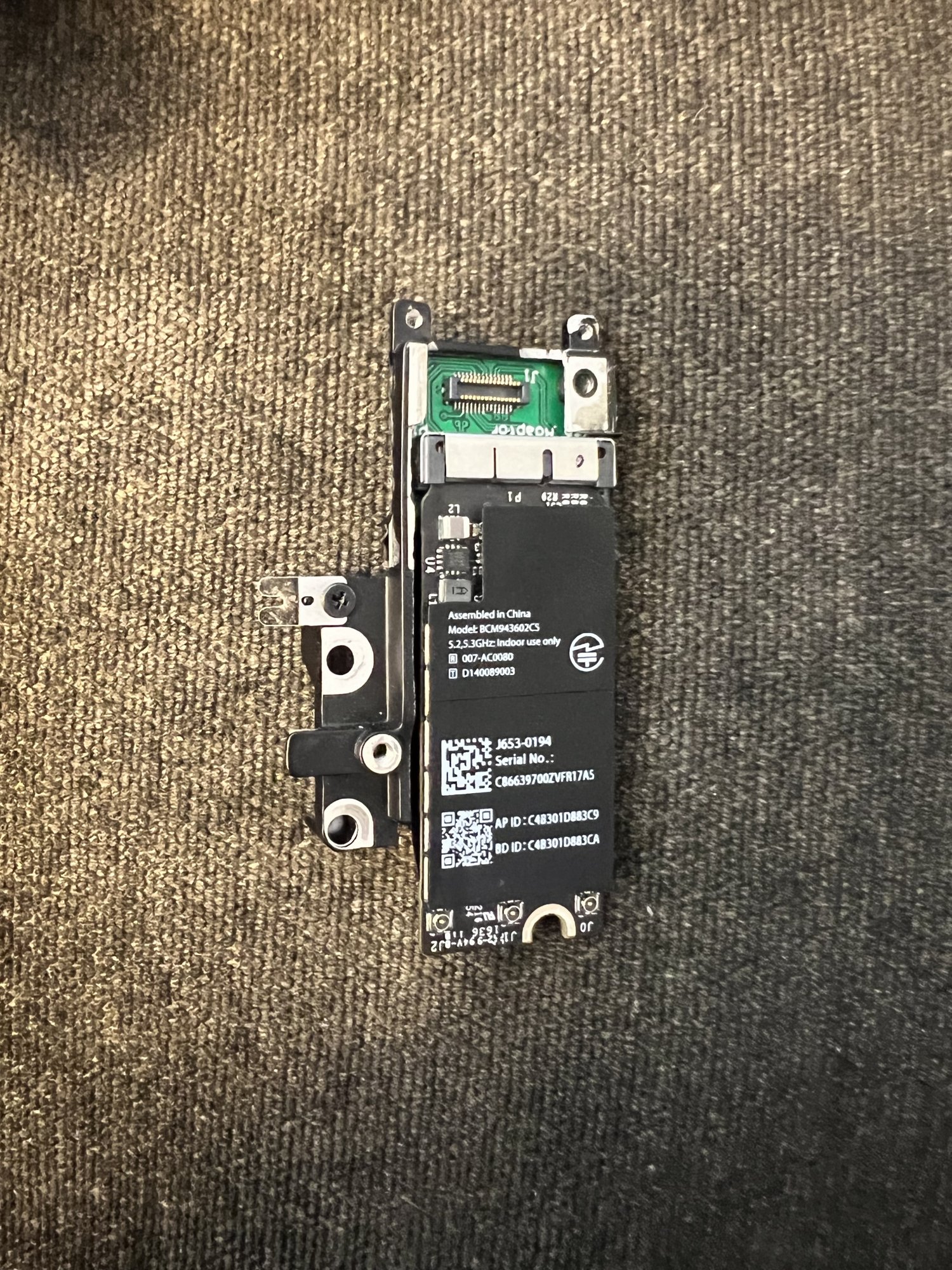

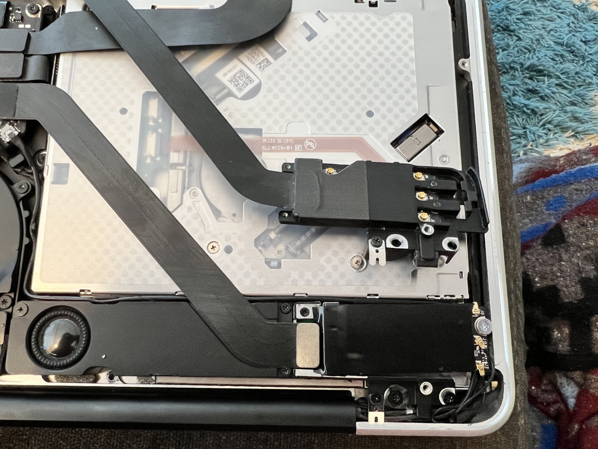

I purchased the Intriguing Industries adapter and their recommended card for best performance off Amazon - total price of about $60. It took some work to fit the card in place. I modified the instructions a little in how to gut the bracket. I wanted to keep the card attached to the speaker. I used a M.2 mounting screw and stud to keep the card in place at the other end. Since the Bluetooth antenna is no longer needed and the fit was tight, I removed the Bluetooth antenna. I worked the camera cable and the longer wifi cable (J0) under the wifi card. I was able to tuck the J1 and J2 cables in the cavity in the corner. In the picture attached you can see the old and new setups. The new card was recognized. I now have ac wifi and watch unlock. This was a fun project. More pics of the work are available if interested.
