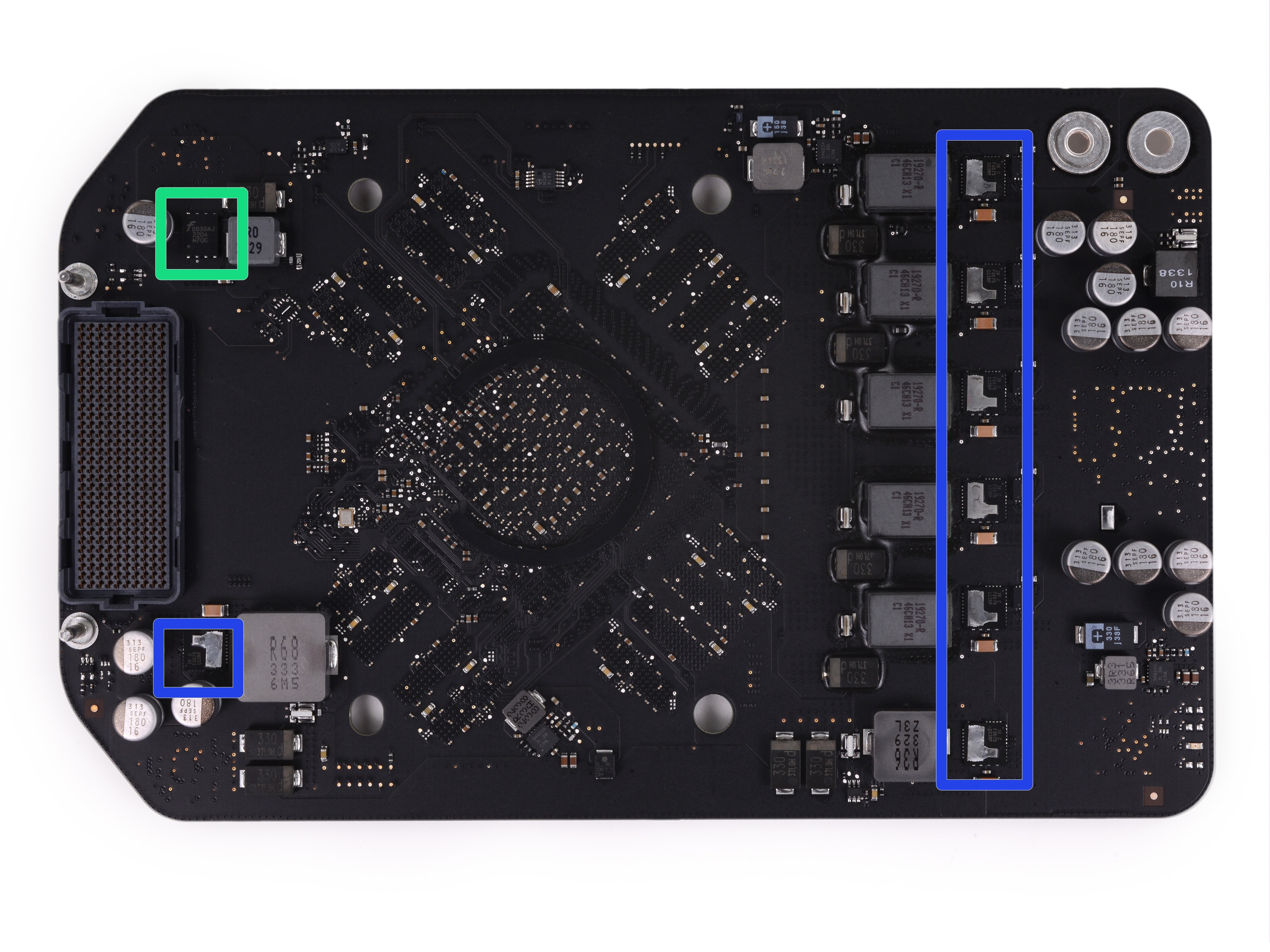

Do you know what is role of this green chip ? (photo from iFixit)
Fairchild Semiconductor DD30AJ

Looks like a power FET, most serial eeproms have a part number starting with a "25"
Blacksheep may know, he once posted the roms for the D700s, I'm pretty sure that he got them from a 6,1 EFI update.
Which would mean no GPU updates without a new EFI for the 6,1.
