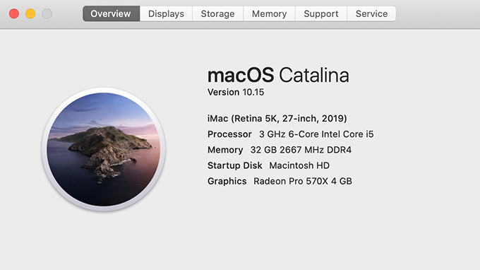

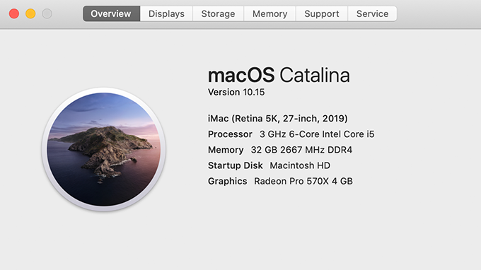

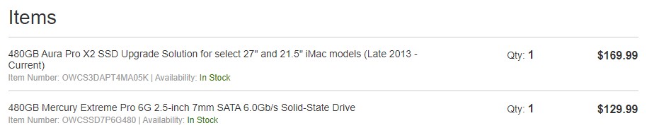

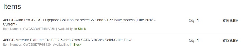

I just buy this two pieces to upgrade my Fusion Drive. I hope I don't regret my decision
