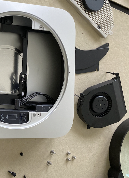

Just swapping a drive(top drive as you look at it from underneath) is simply
three screws to remove for fan and fan cable to free with spludger/plastic tool (you can just remove two bolts and free the fan from the post but i find it easier to just take the bolt out
one screw holding plastic cover. This is the hardest bit, don’t loose small screw and plastic cover only comes out in a certain direction. Case of fiddling with it. it’s a fiddle to get back in too
Remove 4 screws holding antenna plate (2 screws holding plate, two holding drive to plate). Lift plate gently and flip 180 degrees around its antenna cable (no need to remove for a simple drive swap). Position so it’s not yanking the coax while you work
remove drive connector with spludger/plastic tool
remove drive by wiggling. Sometimes helps to put screwdriver in upward facing bolt holes (to give you more control of positioning it, bit fiddly otherwise.
install is reverse. Be careful with the coax positioning (I find it difficult to see how one would trap it but I gather it happens)
swapping a drive in the second bay (when fitted) is the same as fitting the second drive first time (minus fitting grommets) full strip!

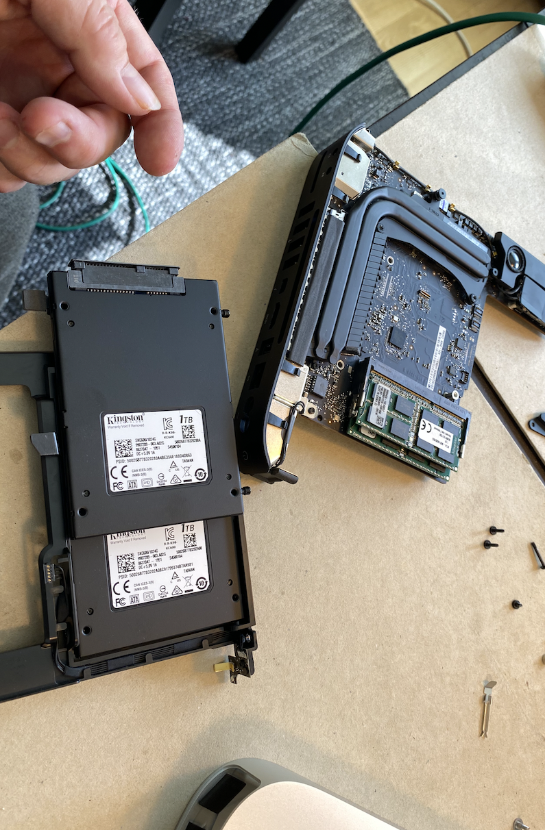

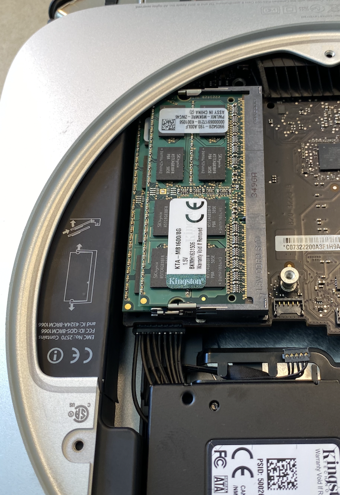

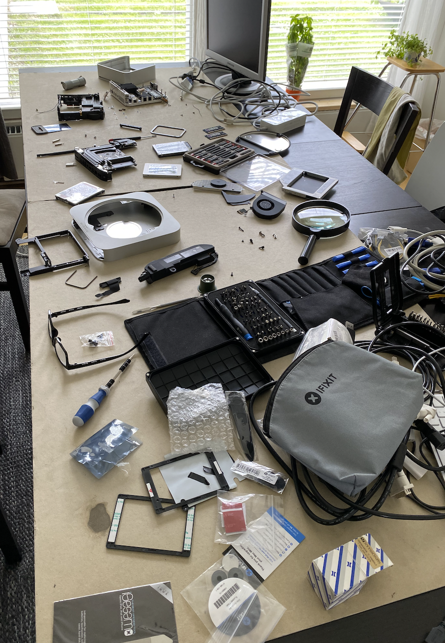

It's not that messy you might think it is, just be carefull and don't loose the screws, get the right tools for it (for ex. iFixit). And while you are at it, why not change the thermal paste for CPU & PCH too. And absolutely the RTC battery too while it's open. In mine the paste was quite dry allready. Then I saw the paste I took my other one under surgery immediately too.
:rolleyes:
Ok, it looks messier than what it is.

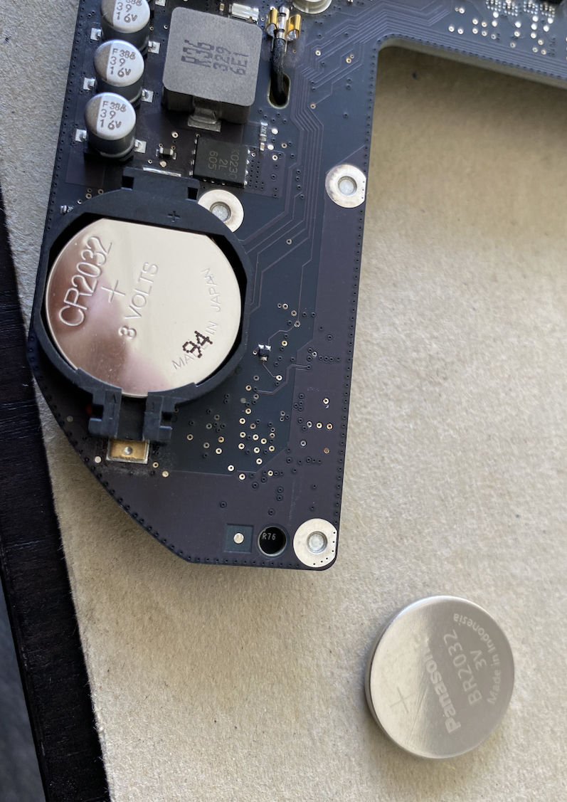

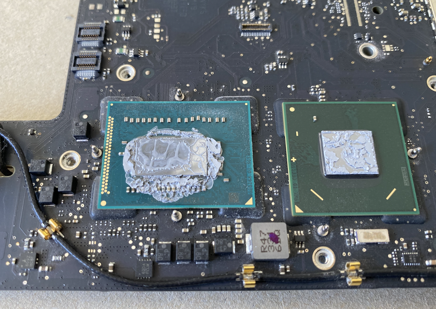

CPU and PCH (Platform Controller Hub).
For RTC battery you would want a BR2032 instead of CR 2032 because it takes more heat pressure by design. Did not have one at the time, so put in a CR 2032. So it might need to be changed again sooner than the BR would need to.
Put in a couple of pretty normal Kingstons (KC600 I would remember), 2x8GB Kingston KTA-MB1600MHZ so-dimms, so the server can serve.
This i7 2,6GHz was my TV/HTPC Mac Mini earlier, but I decided to change places with some Macs.
Now it's been serving in this configuration about 1,5 years. Battery seems to be okay still, and everything else too.
Obviously MM 2018 and a M1 would be beefier, like a lot, but there's no need. This has been enough for what it does. At least until now. Now I would pretty much have to go bigger than Mojave with it. Catalina never convinced me, so I'd like to go at least Big Sur. That would mean hacking it a little, and it's another story. Just wanted to show you guys these 2012 oldies are in good use still. Yours can be too.
One word of causion only; be carefull with the little cable connectors in there, so you don't rip them of the board.
very impressive, looks like a project i did inserting a new display for a powerbook in 2007
anyways
how did you remove the fan screws?
i had to replace mine and cant get the far screw release from the old fan.

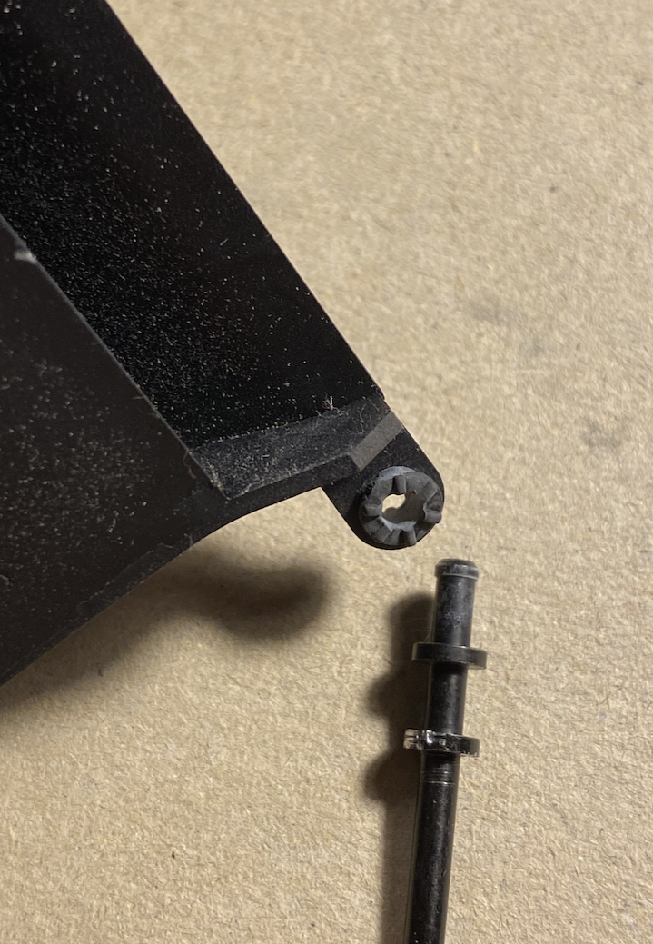

If I remember it right, one screw came out with the standoff. With both of the screws. You need to separate them later, the screw and its standoff. Or maybe you could screw it in without separating them at all, I can't remember exactly.
Think I found it, it's that long one; the standoff / supporting screw and the top screw on top of it.
Nope, not that one, please read later posts.
I've got couple of 2010 MMs, they are on the table next (again it is). They are almost the same design inside them (2010 and 2012), but not exactly, some minor differences in there, like the CD/DVD.
These jobs are not so intimidating to do to me, because of the help of iFixit community and their prior work, the tear downs and repair guides. If i needed to do this without those guides, it would be really really slow to perform, and extremely prone to errors too I think. A big thank you to them, I'll support the work with my purchases from them.

Ok. I just opened up a 2010 mini to change the RTC battery and CPU/PCH thermal paste.
The fan screw in question above was NOT a standoff construction (NOT two screws, but only one). It was just a long screw. And it came out pretty easily by just wiggling it out of the rubber holder / vibration dampener.
Better revisit those teardowns for checking out if there is a difference between 2010/2012 in this particular case.
btw. there are more logic board connectors in MM 2010 than in MM 2012 connecting to the motherboard. Seems they got rid of some thermal sensor sockets, as they gathered those thermals straight from the components (HDD, SSD, CPU etc.) without external sensors.

I posted a "how to" on ifixit asking about the screws and the fan, no responses yet.
i manage to remove on screw as photos and have to get 2 more somewhere.
the fan is solid on the logic board, and does the cooling task when needed.

The fan has 3 screws. The standoff one is long and at the exhaust end of the fan and you can either unscrew it and remove it with the fan or simply pull the fan off the standoff (without unscrewing the standoff). The two other (rear) screws just unscrew and come out. You can see one of the two removed rear screws two photos up, bottom right (screw closest to the bottom right corner). Its a tiny torx (the same as the standoff)
In same photo you can see the poster took the unscrew-standoff-and-remove-with-fan option
