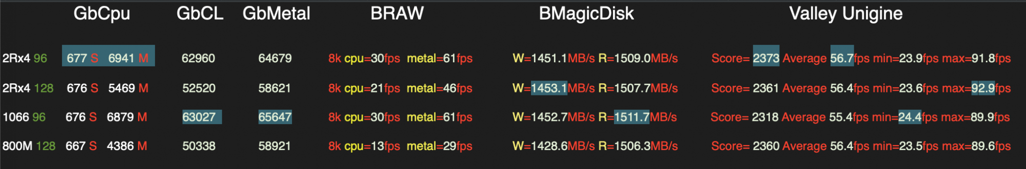

Ahh I see I just found it noticed they were booted into windows to get that result.
going to experiment with the 4rx4 and see how it reacts if i remove the 4 and 8 slot vs, the 2rx4.
(Note something is messed up with my system, i have no recovery due to following martins monterey guide)
Edit: Well how about that..? 4rx4 slots 1,2,3. - 5,6,7.
I assume I'm better off with the 2rx4? be a hot minute before I benchmark them

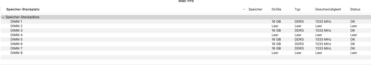

Hey folks,
a weird thing is going on: I set 6x 16 GB sticks (from one kind) in slots 1,2,3 / 5,6,7 and I got a red light on the board and one of them is not recognized (see picture). If I remove one, so there are only 5 left, everything is OK.
At fist I thought it was a faulty stick, but now I think that only 5 one can be fully accepted by the system, what is weird, because all posts here talk another language.
I'm on Monterey with OCLP 0.6.8.
Any hints how to get the full 96 GB instead of only 80 GB, which is also enough for me?
Cheeers from Frankfurt / Germany
Yes, all slots worked with the former 2gb and 4gb sticks. It is like I said: inserting the 6th stick gives an error, with 5 it’s fine, no matter which of the 6 you choose…
i'd try a NVVRAM reset if you haven't already done it
Oh man, I did it before, you can tell. But now I ve done it 3x in a row and magically ALL the sticks were recognized!! Thank you very much!! So easy!
