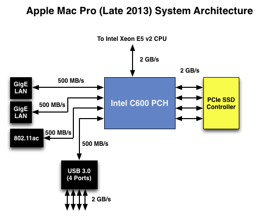

Using Anandtech's image that was just quoted:
You have a 500 MB/sec link to a single GbE port - which needs 100 MB/sec.
You have a another 500 MB/sec link to a second single GbE port - which needs 100 MB/sec.
You have a third 500 MB/sec link to the WiFi card - which is maybe 100 MB/sec to 200 MB/sec.
Do you see that all three NICs could have been on a single 500 MB/sec lane, freeing lanes for the USB 3.0 controllers?

The nMP has limited PCIe lanes, but I'm surprised (or not) they only allocated one to USB, and one EACH to the three network interfaces, which won't use a fraction of that. Why not put the two ethernet on a single PCIe lane and reserve two for USB? Mystery ...
